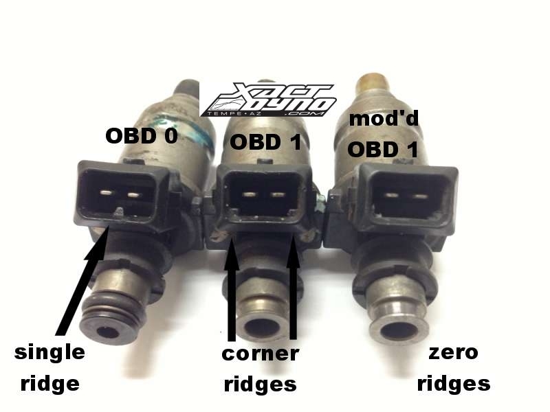

heres a pic i found of the different plugs. Obd 0 on left obd 1 I want to say and the old 1 dremeled

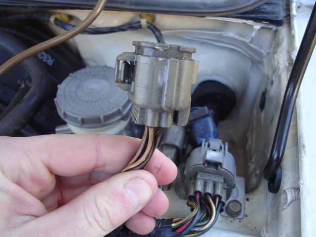

found this but i dont get it as ive never done anything with these parts of the harness before.

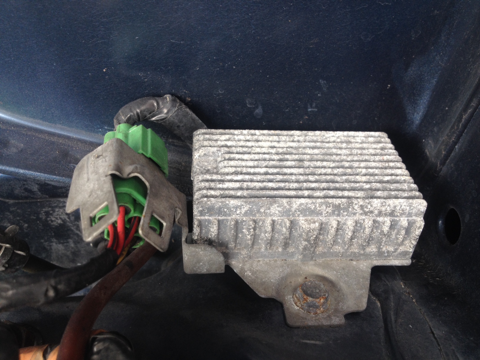

Sonictronic wrote: »Use a 92-95 civic power distribution block like this:
Just depin the whole distribution block and your resistor box and put the 4 red/blk wires and 1 yel/blk wire into the distribution block in any position. That will just send 12v power to the injectors when the ignition is on bypassing the resistor. That way there is no splicing. Only do this when using Saturated 12ohm injectors. If you install some peak hold 2.5 ohm injectors like say...dsm 440s then you need to put the resitor back in.
BTW: There is no need to replace the obd0 injectors if you leave the resistor box when doing an obd1 swap. Just use the Obd0 injectors in the obd1 motor regardless of ecu.
Now you just have to make the plug fit like you said, so you can dremell that or attach the OBD-1 Plug to the OBD-0 Loom.

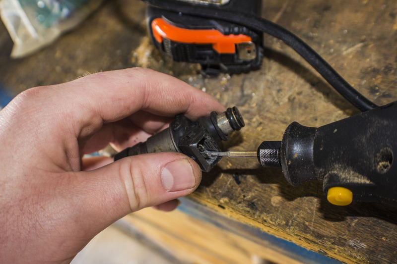

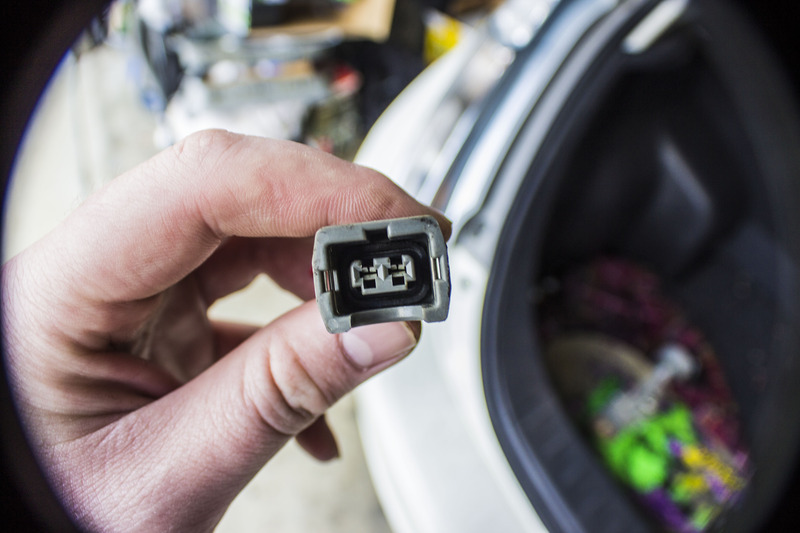

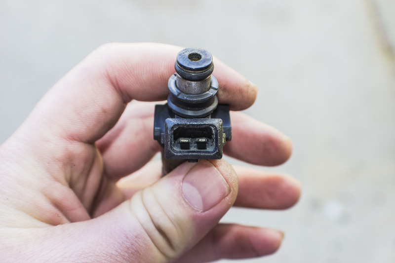

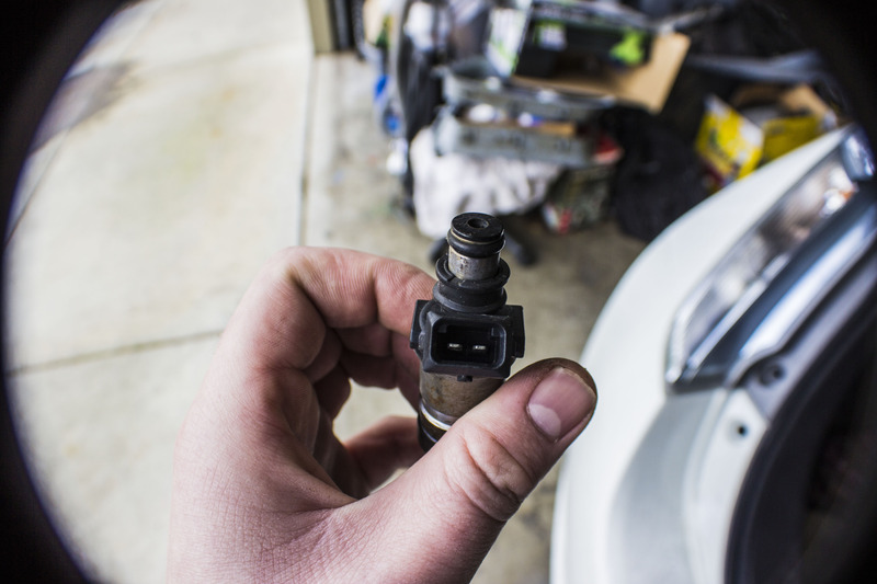

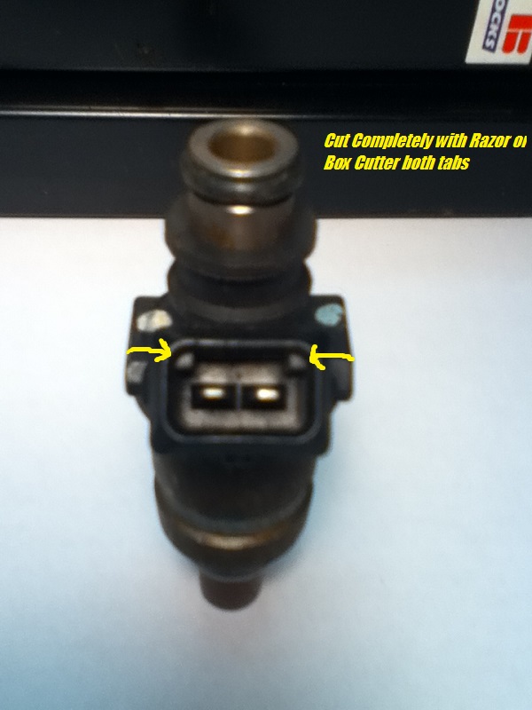

here you can see the obd 0 injector has a line down the middle of the plug
the plug shows voids on either side which use the two lines as a guide or track ( completely unneccesary )
here you can see there is no line down the middle but there is two lines at the top of the plug , those are what we will dremel out.
heres a ground down aka " modded " obd 1 injector
i used a very thin dremel attachment
" if it clips, it fits "
success the injector is now ready to be matted to my obd 0 harness!

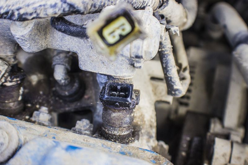

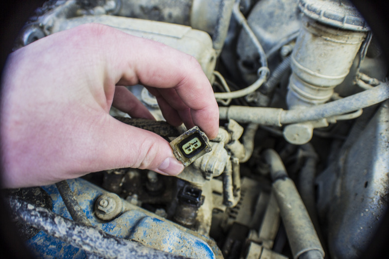

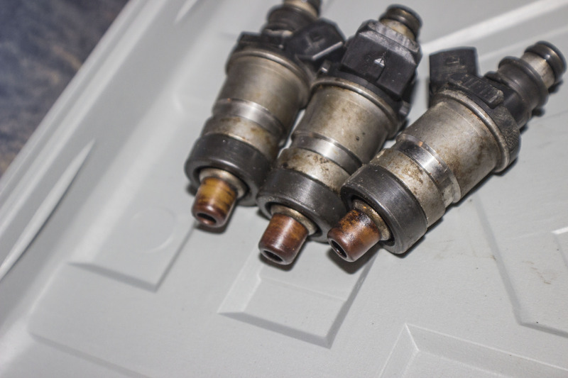

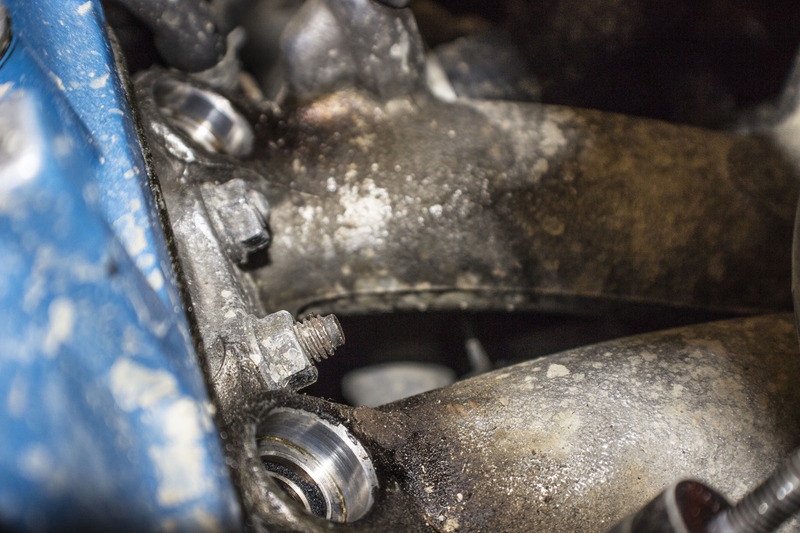

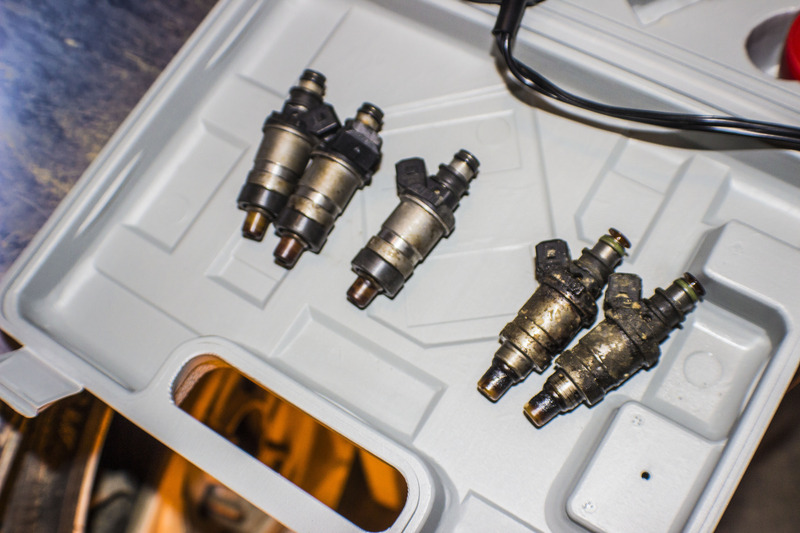

upon inspection of the obd 0 injectors i noticed one of the hats was stuck in place this could be the cause of my raw fuel and rich running smell thru the exhaust

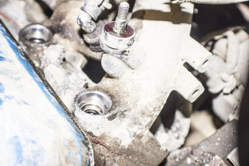

cleaned out the seats
theres a second ring in there that has a lot of carbon build up i just left it im not sure of any negative effects it can cause considering it should be a air tight fit now
better pic of the build up
nice clean o rings

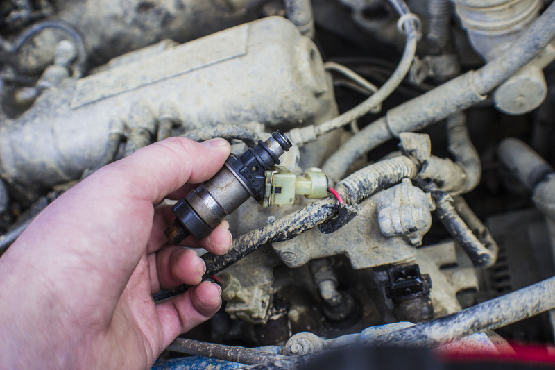

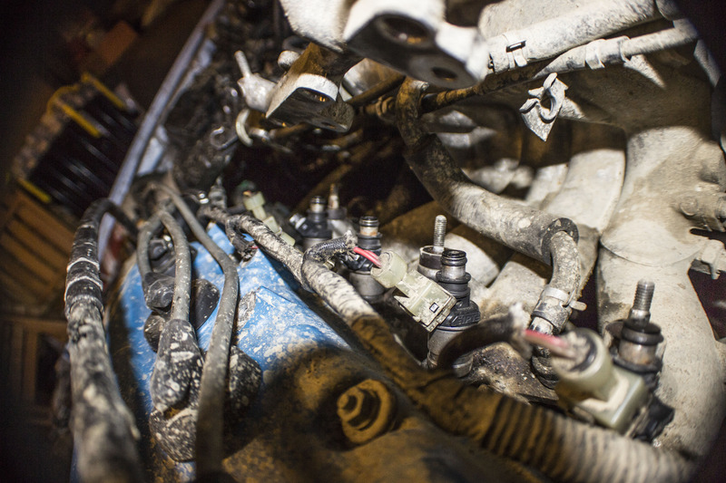

all injectors inline and installed

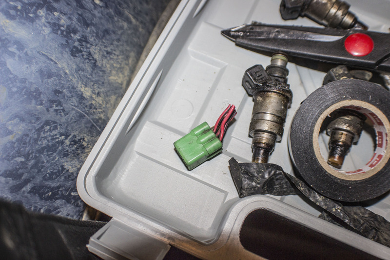

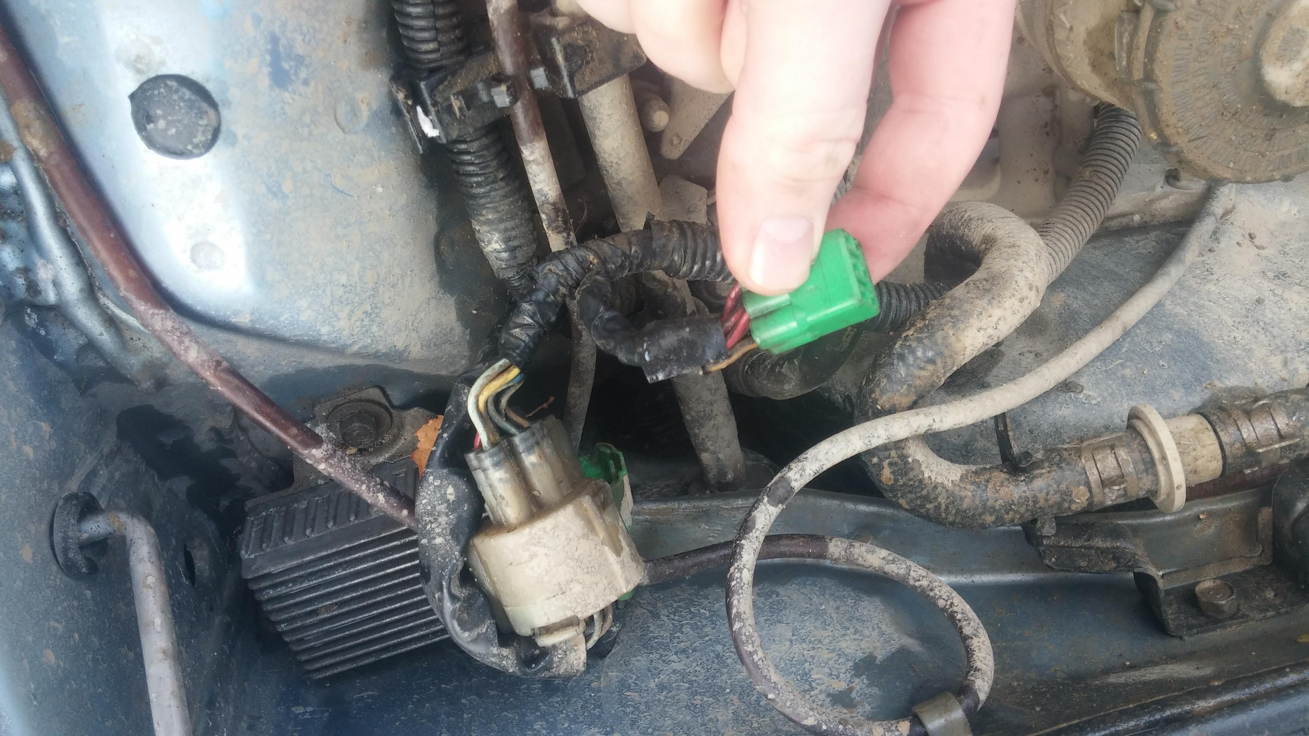

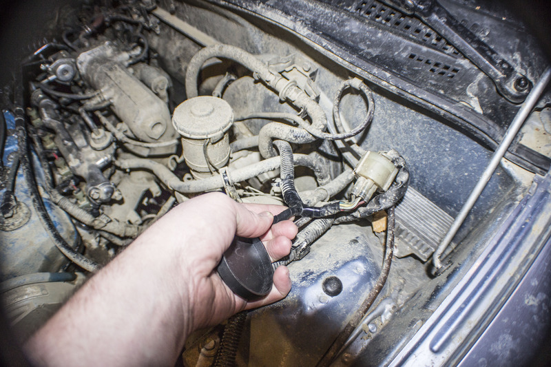

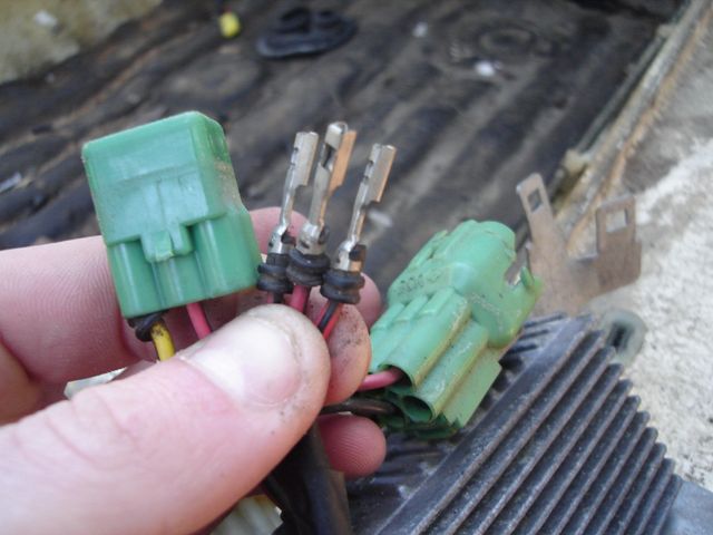

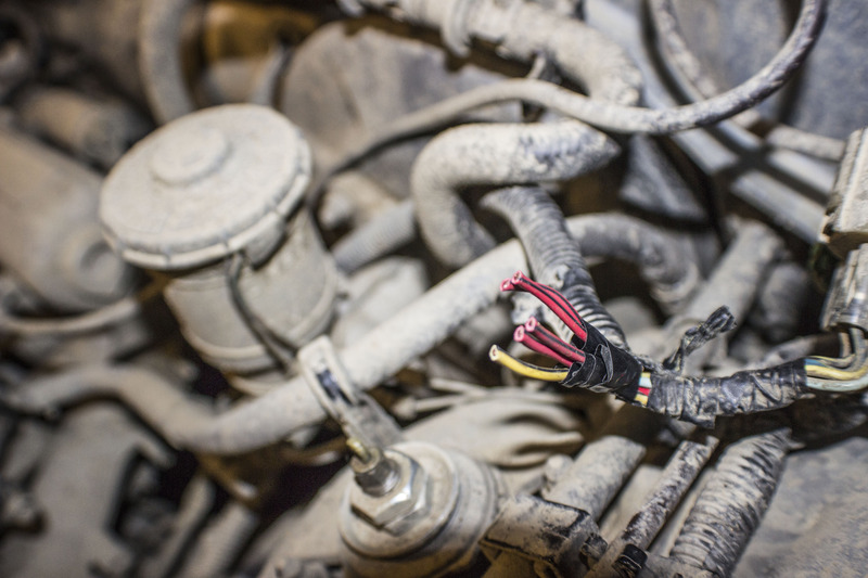

mutilating the resistor plug wires
sorry harness
prior to cutting i sectioned off the top row of wires and the bottom row incase i want to reattach in the future for whatever reason that may be..
just going to store them with the old injectors

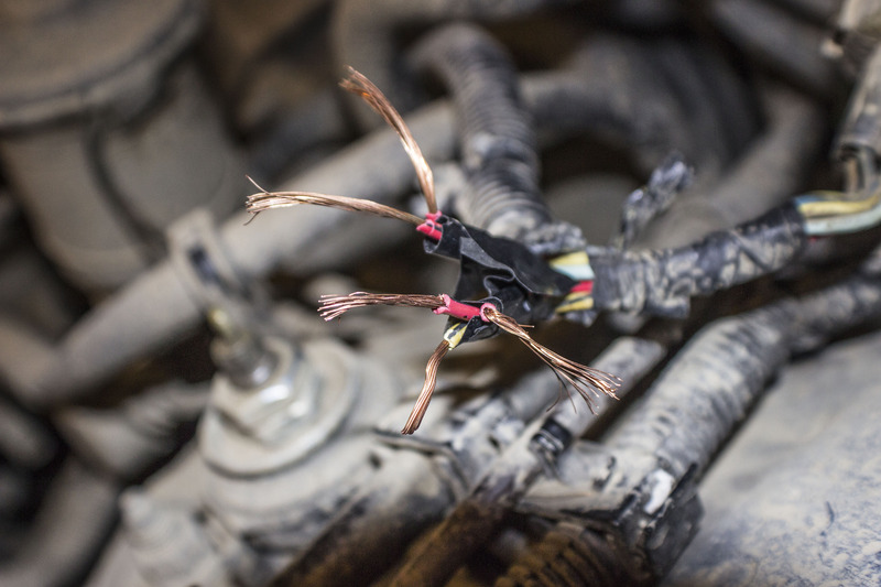

all stripped !

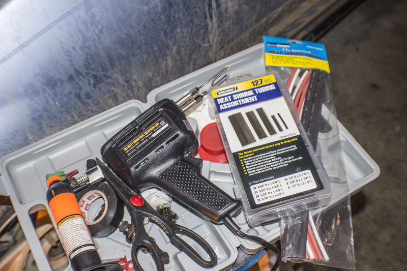

bought all this stuff a few months back only gunna need one small piece of heat shrink but i think i may tuck my engine bay so this will come in handy later on

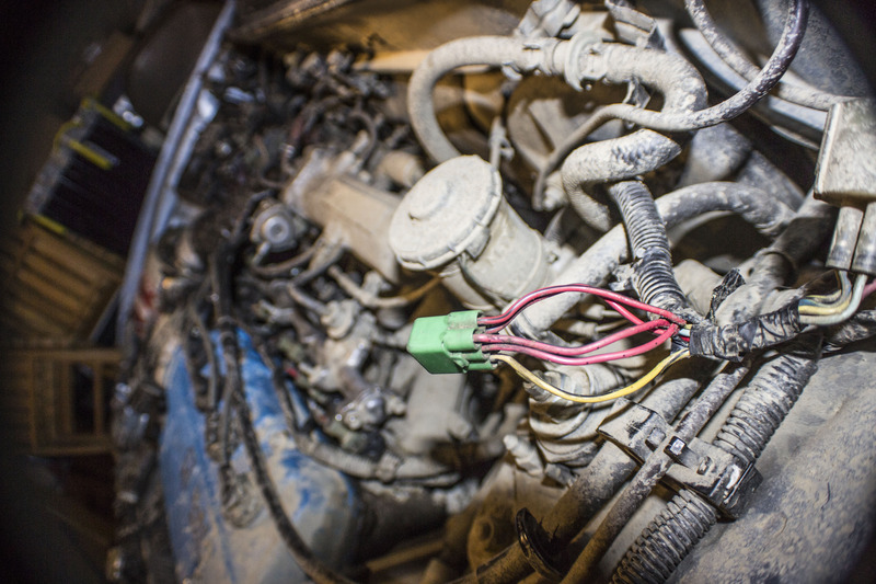

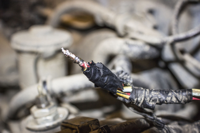

soldered up real good
left with a nice clean " cap "
money shot , fired right up no more rich smelling exhaust and hopefully no more leaks or random misfire from flooding .
it may be the placebo effect but i swear the throttle response is enhanced my old injectors probably had around 300 k on them so who knows!
