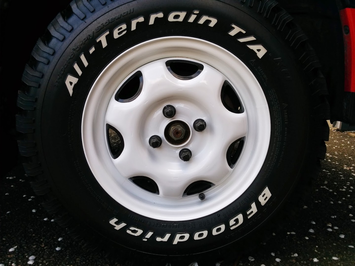

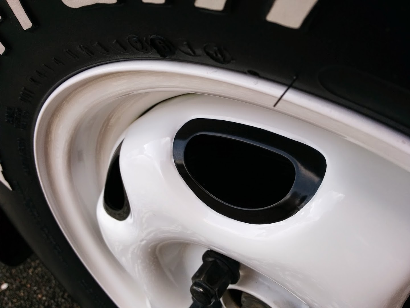

  • I had mine powder coated. Was not cheap for 2 colors to make it look stock but the end result is completely worth it. I think I was ~$600 out the door.
  • ^^ Yeah These right here. I remembered seeing a set that I really liked. Definitely a good look on them. Were I to have an RT4WD I'd probably do something similar to this look. Monochrome style, maybe with the black in the same color as the body.
    damn. those look good.
  • Thanks! They are holding up really well going on 2 years now. Zero complaints other than white wheels look dirty immediately. They look sharp when clean.

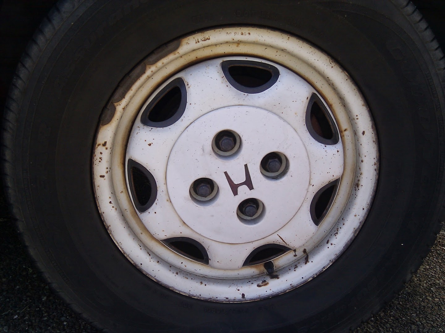

    Here is what I started with.
