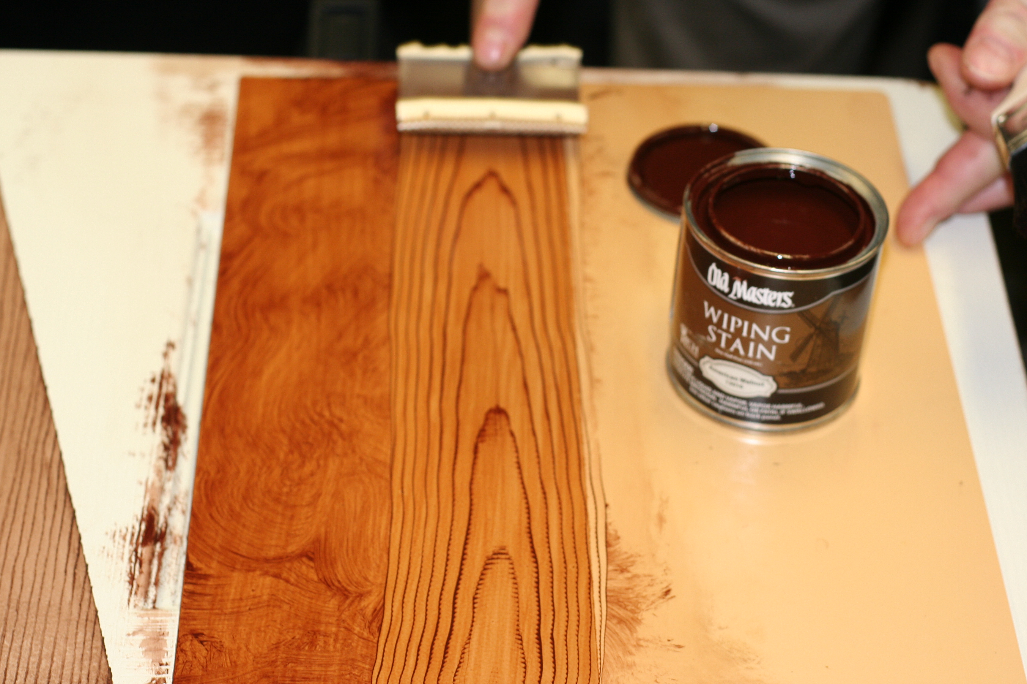

  • Yep, or a wood graining tool to get something like this. I know some of the guys on here have wood grain stuff, like valve covers and what not. I forget if it's penro that has one or someone else.
    But yeah, for wood grain, I'd definitely go with paint. To me it always looks a bit more natural than a printed graphic. Granted the person in the pic below got too much vibration when dragging it, but you get the idea. The roller that superhatch mentioned looks like a great applicator as well and you could get a few different colors in there, similar shade but just enough difference to add a good bit of depth to it.
