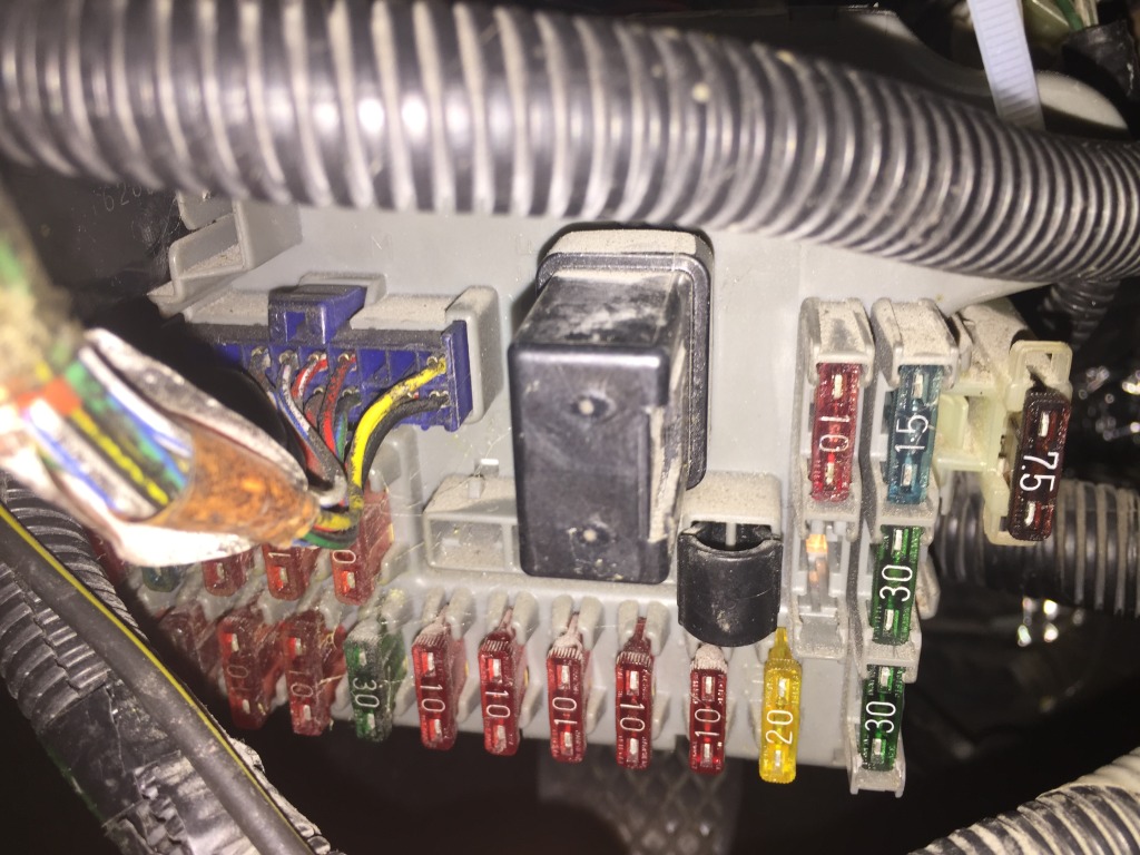

    Yes it did! It was an antenna wire hanging out all bare. I did switch out most pf the fuses, but I ran into problem. The fuse box does not specify about what goes to the very right side of the box, these is one fuse spot at the end and I am not sure what goes there. Do you guys know by chance? Also big thanks to greenteagod!!!
  • I have a 1990 FSM I could reference, if you could snap a picture though of what you're looking at it'll give me more to go on. Also some fuse spots are actually empty or for accessories that may not be installed it could be something like that.
  • TadasTadas Wagonist
    It is that one where I did stick the 75 in:
