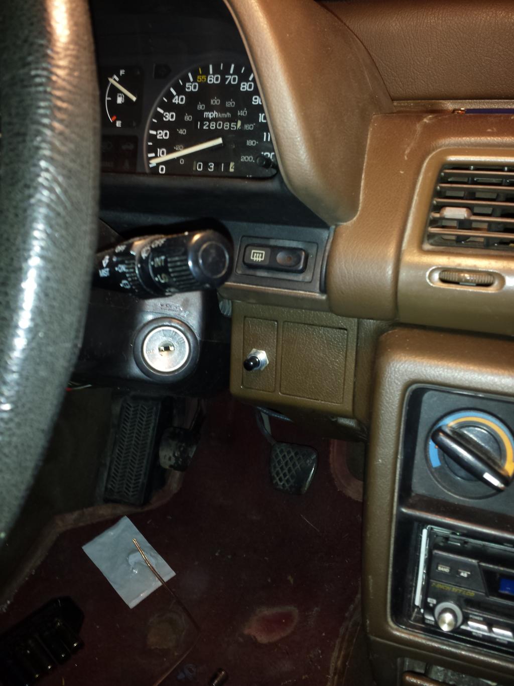

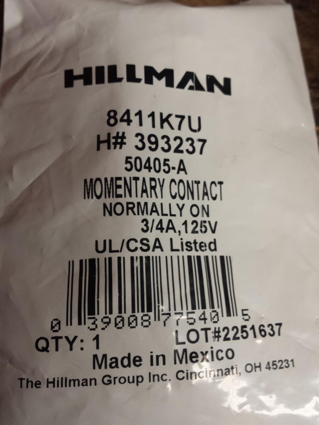

Momentary contact, normally closed switch (no relay required to kill) :

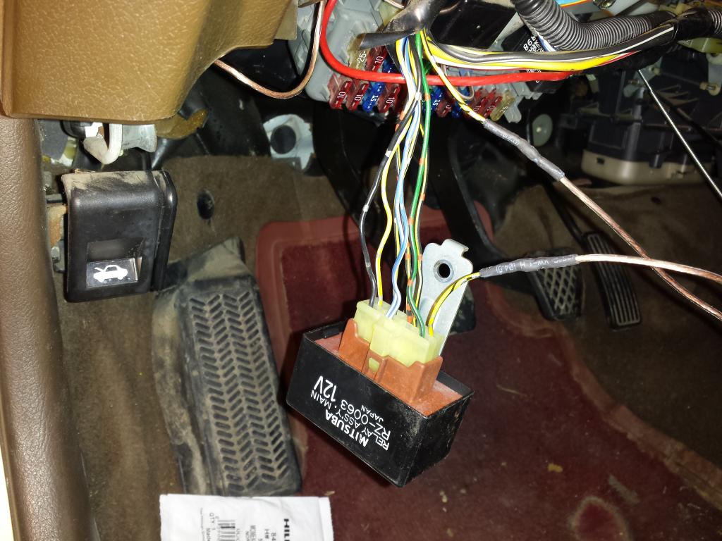

This is the EOC ( Engine Off Coasting ) Kill switch in place (it has trouble starting back up if you kill it above an idle - DPFI) :
Looks like you might have changed your mind, but this is my solution to that same issue. Figured I'd share for the next guy.
By the way, my car alarm is also tied in line with this same wire (with a relay, since the alarm switches ground) to disable the car..

So you just need to use a two prong switch and put it between the yellow and black wire
__YELLOWWIRE___/--switch--\______YELLOWWIRE______
Yup. No relay. Just need the right kind of switch! Got the diagram from my buddy in the ecomodder, works like a charm.
I like the normally closed momentary contact because you push the switch to kill, and let go for normal. Simple bump start to get the motor back on, and you're golden. .
