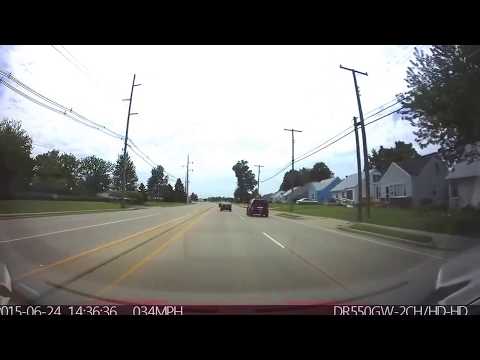

I was on my way to fix my muffler and this happened!!
Right at 46 sec
This maybe how/where I have it mounted.. The back cam is really bad at night.. it have a bad glare from the glass and reflects inside my hatch..
but again its probably how/where I have it mounted!!
I also have the brightness turned all the way up, so during the day its kinda too bright but at night having the brightness turned up helps out a lot.
I do really like the dash cam, everyone should get one!!
