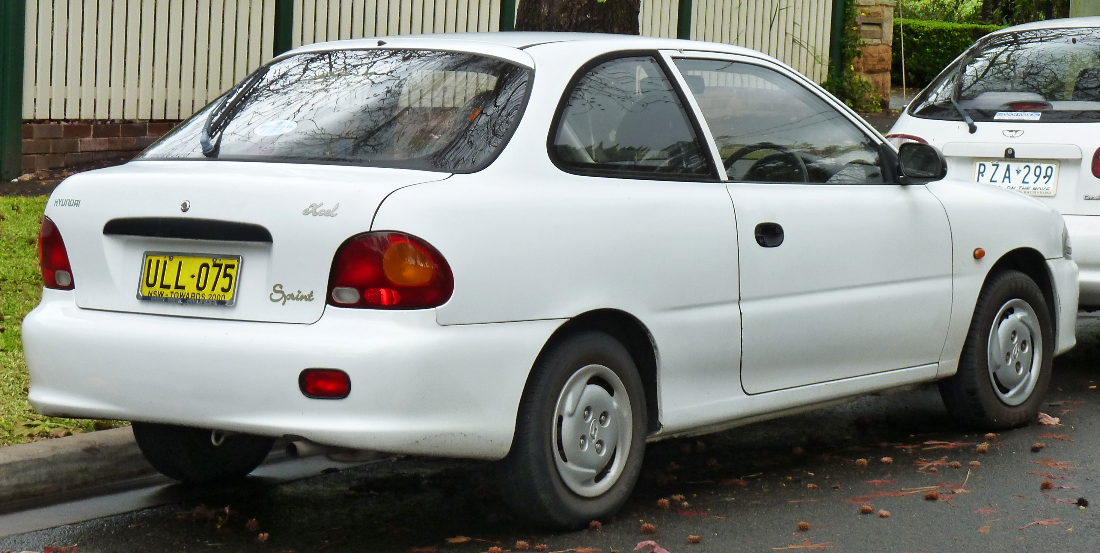

So, I really want a rear fog on my wagon, but want to try something different(and cheaper) than a OEM rear fog in the bumper. I can't seem to find anything online about this being done before, so figured I'd see if anyone on here has done it or knows if anyone has. I was thinking about making a custom rear fog light using my left inner tail light, or left reverse light (both circled in pic) by either putting a bright red bulb in the reverse spot and wiring to a switch or putting a dual filament bulb in the inner tail and wiring to a switch to where it's lit normally until I hit the switch then it becomes brighter. What are your guys' thoughts? Could you put a dual filament bulb in the tail and what would you need to do wiring wise? Any info or suggestions would be appreciated.
pic for reference
pic for reference
With regard to the inner brake light, it's already dual filament, so I'm not sure what you'd be looking to gain there, unless you're talking about always having it be on the brighter setting if you were to have it switched. If that's the case then just splice the brighter side into the dimmer side via a switch, like you were mentioning.
As far as wiring goes, just run the splice up through the loom back down in to the body and to wherever you want to place whatever switch you like.
Only concern I'd have with things is I've seen several cars melt their lenses from the brake lights being left on for too long. Not sure if you'd be going on any extensive drives, but when the brakes are applied, that bulb gets a hell of a lot hotter. No big deal since you're usually not riding the brakes, and probably not as huge of a deal up in your climate as it is down here in Texas. My girlfriends escort, and my volvo wagon both had melted lenses from brake switch failures. Just something to consider.
