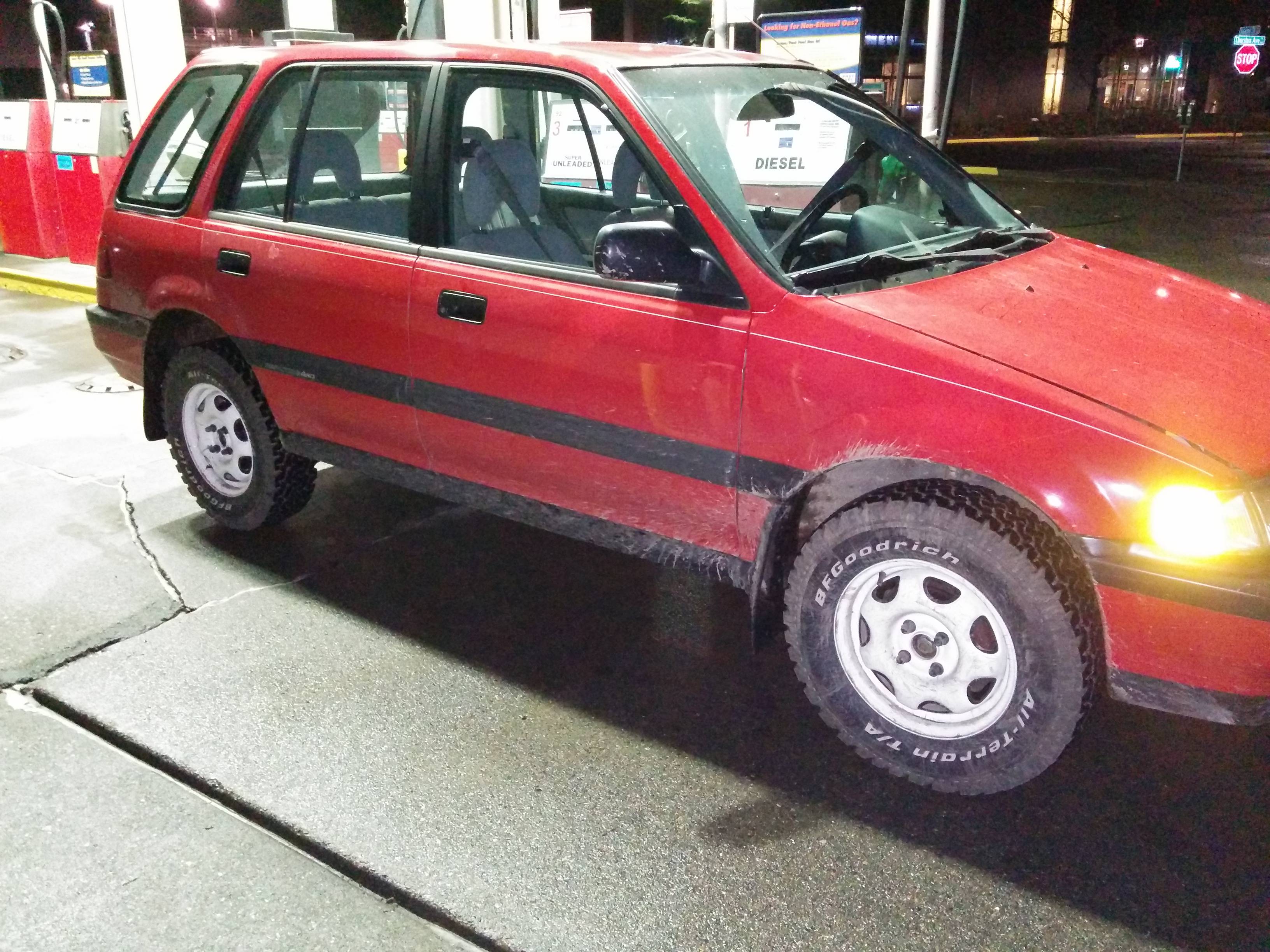

195/75r14 BFGoodrich All-Terrain
They fit! No lift required on an rt4wd. Very light rubbing at full lock in the front on the plastic inner fender.
    Those look good, man.
  • They're still BFG's though.....they'll start to wonder around and vibrate like crazy half way through their life. They do look pretty awesome though!

    Can't say I have had that experience in the past with other sized BFG ATs. Got 30k on a 90 Toyota pickup and done 60K on two separate sets on a super-duty. Zero problems.
    A 10 ply tire is WAY over kill for the weight of a wagon. Had 20psi in them in the above picture and the side wall was not even looking soft.

    Probably. BFG is a bit more squared off so it looks a little bigger than most tires.

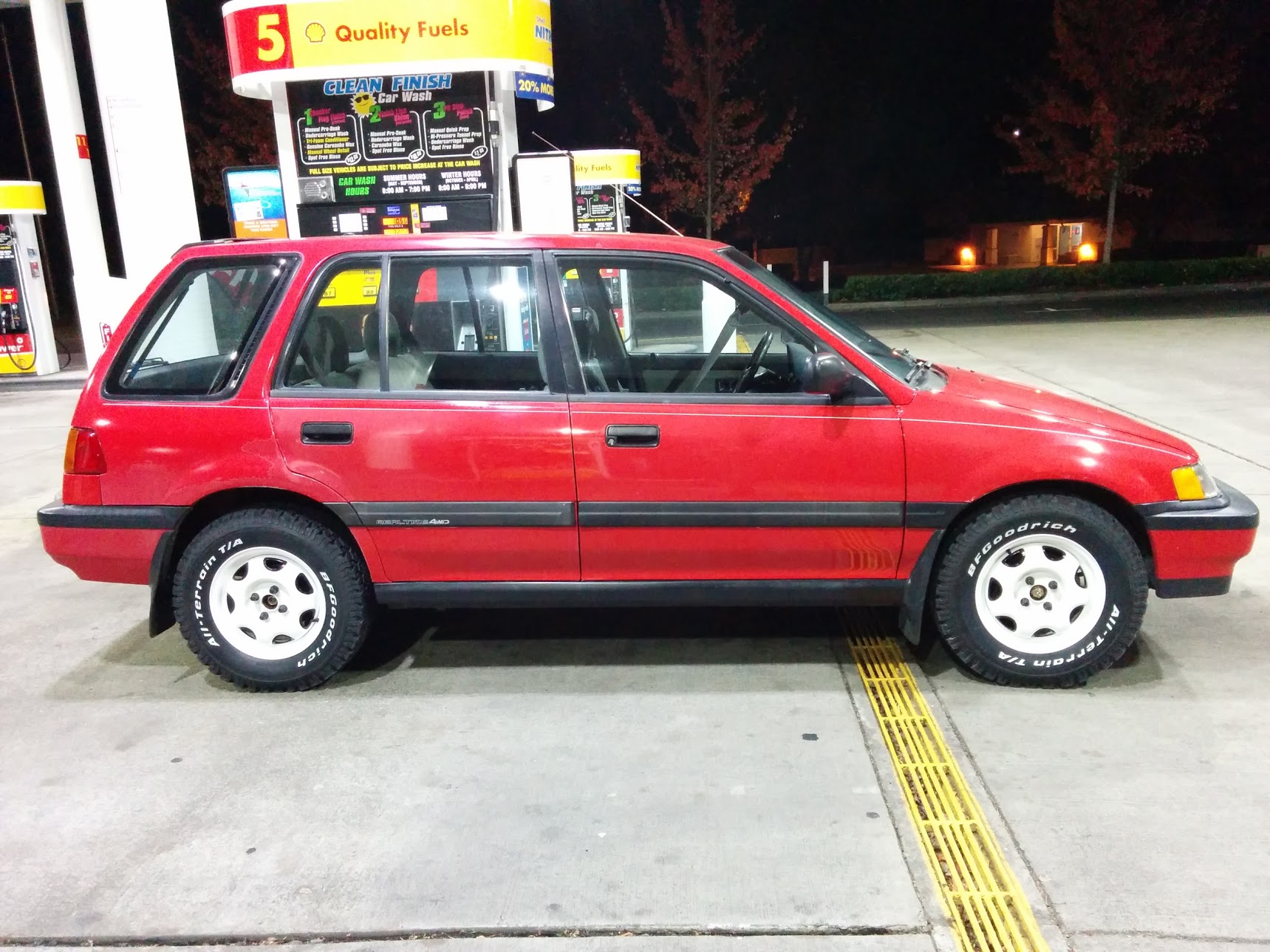

  • Just have to say it again, that is a great look. Absolutely love it in red too. Not that I don't fancy my mottled gray wagon =D
    Did you hit the openings on the wheels with a darker color? Or is that shadow? Either way it looks good.

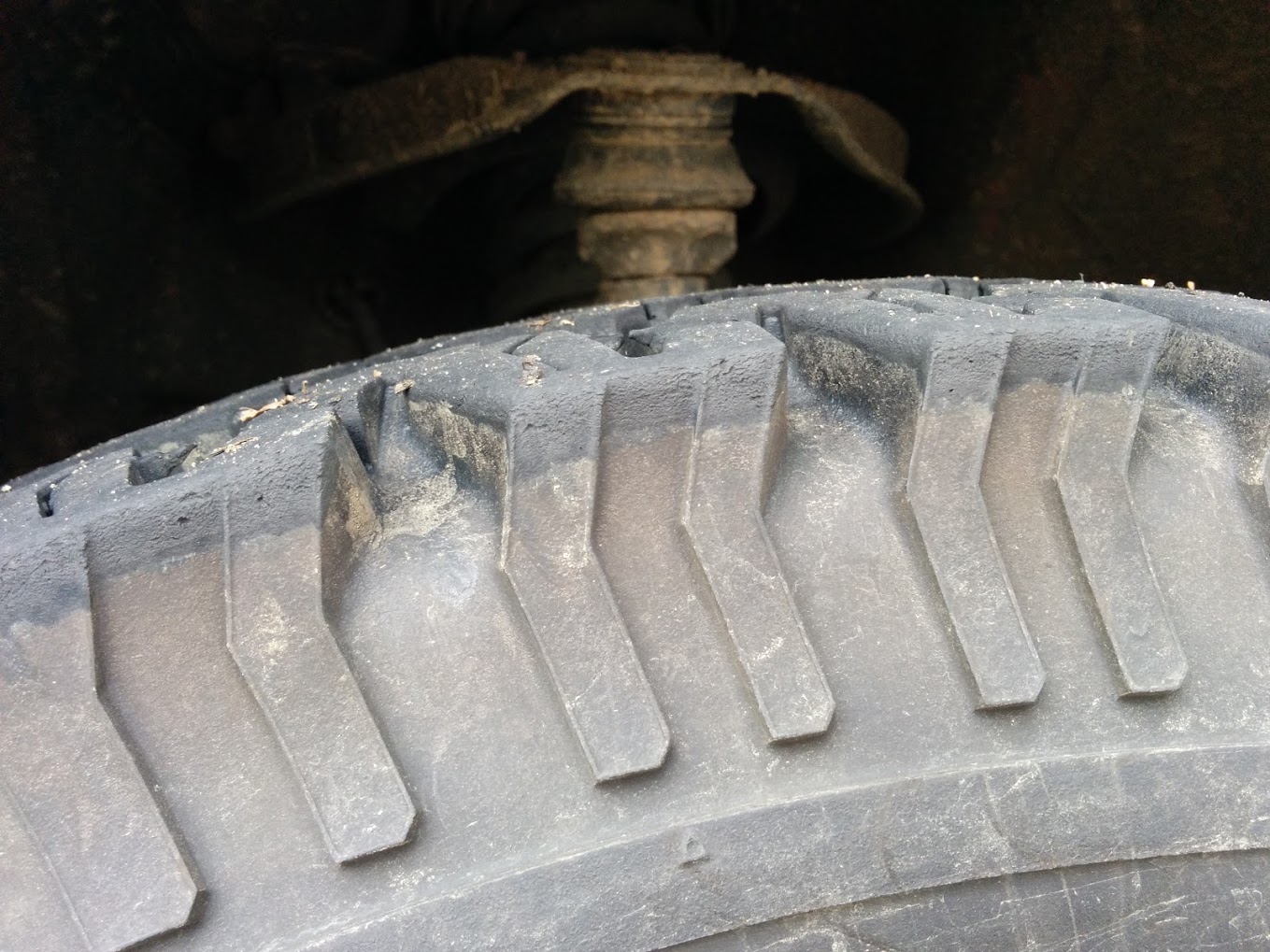

  • Still enjoying the BFGs! Just rolled over 4200 miles.
    Went up in the woods and got muddy. Plus a shot of the lift.
    Then it dried out and had a chance to really lean on the tires. They are very predictable around corners and give plenty of warning before they let go. They make this awesome howling noise at the limit. Note how far over the knobs have rolled over and scrubbed off the dirt. :-)
    This thing is just too much fun. It still handles exactly like a 90's civic, just taller and more capable off road.

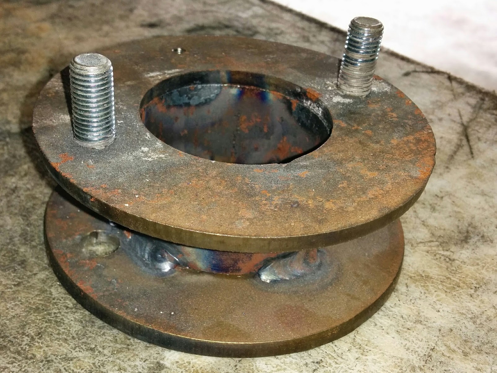

    what are you all using for spacers on the struts? Im interested in doing this lift for my wagon. thanks
  • I am using some custom made spacers made from 1/4" plate and schedule 80 pipe. Any spacer lift is going to be about doubled at the wheel. So a 1" spacer gives about 2" of lift.

    thank you ryanthegreat1, do you by any chance have a pic of the spacer you made?

    Sorry for taking so long to get around to this.
    This is my test spacer at 2" tall. Not fully welded or painted or anything. 4" of lift was WAY too much. Been sitting around the garage for some time collecting rust and dirt. This gives the idea of what I did.
  • Nice...so even at 1" tall, you didn't have any problem with the top-hat studs and bolts clearing the top plate? Or did you have to do some sort of notching?
  • I clocked the top hat 90 degrees to clear the welded in bolts and ground the point off the top hat stud to clear.

    how bad did these get into your fenders over the rough stuff at speed? preferably at stock height if you remember.
  • I did a few gravel roads with real bad washboard on them. In a straight line I don't think the tires would ever come in contact with anything at stock height. But I never bottomed out the suspension. At full lock the fronts get into the inner fender a tiny amount on the front edge. And at about half lock the rear edge of the tire just touches the mud flaps. Really not bad at all, a little heat gun action would fix the clearance issues.

    Do those fuel pumps really have mechanical dials instead of electronic digital display? In 2015? I don't think I've seen that in a decade or more!
