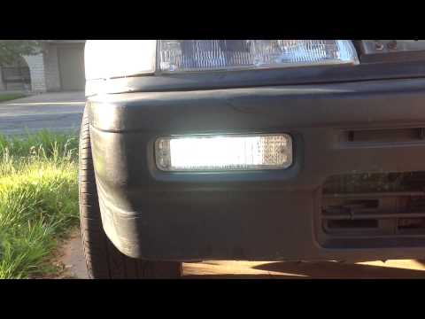

O.k. So the idea behind this is you have a dual purpose bulb. I wanted some brighter attention getting running lights as well as just a nice bright turn signal.
You can see on the bulb itself it actually has two arrays of LEDs. The yellow ones are bright white. The orange ones are the amber. I picked up both the LED and socket base from superbrightleds.com $20 for the bulb and $2-3 for the socket. The effect is pretty awesome.

Button It all back up and here is the result. The flash is fast because I still need to install a corrected relay for LEDs. That's a simple $15 fix though.
