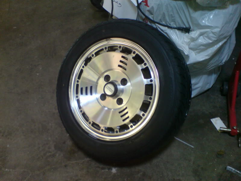

The wheels are Riken Turbos, found usually in 1 piece form and look quite different from mine:
