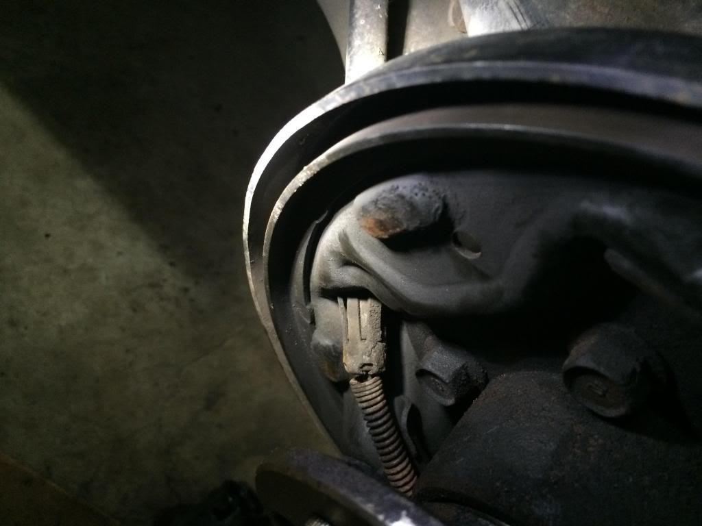

Use a 1/2" or 13mm 12 point box-end wrench. Slide it over the end of the cable (the end inside the backing plate, of course) and over the retainer "fingers" on the end of the housing. As this compresses all three fingers, just pull the housing from the back.
