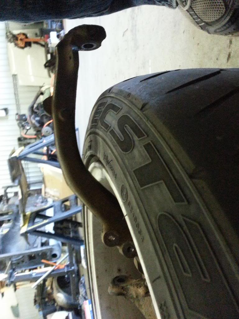

  • LowFlyin'LowFlyin' Moderator
    This is what a 205/50-15 looks like on a 15x8:
