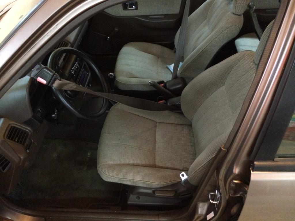

She wasn't quite as untouched as the automatic. She had 30K miles more and there was some obvious tinkering going on with the engine and she was cholo'ed out with the lowering kit BUT DAMN is she clean! And so straight to, I had to have her running or not. We tried push starting her, no luck. I knocked on the starter, no luck. I cranked the hell out of the ignition, no luck. I jumped the battery, no luck. I tried hot wiring it, no luck. And finally, I tore the starter out and had it tested but the starter was fine..... We were lost. He said it was just running before the snow storm. It truly did seem like a starter issue but I exhausted all my mechanical ability seeing that I was 160 miles from home with a wife and baby sitting in the car and another snow storm coming in. It was getting dark and we were exhausted. I told Mr. Barber I need to get my wife and baby some food and we can decide what to do next.
