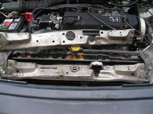

Front end body work ...a start anyway... update 12/9
slicked up the fender I bought a couple weeks back

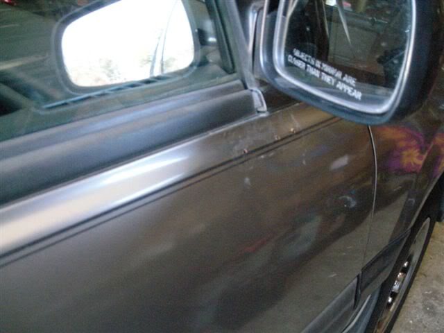

Been looking for one to replace this
I knew there was a bit of bondo, but dayum!

After some of the ones i've seen here, I was almost afraid to look here...no worries
changed this too, the one on the parts car was much straighter. then it took me an hour to get the hood to latch again!
also changed bumper and bumper lights,Right headlight, dash AC vent, some other odd and ends

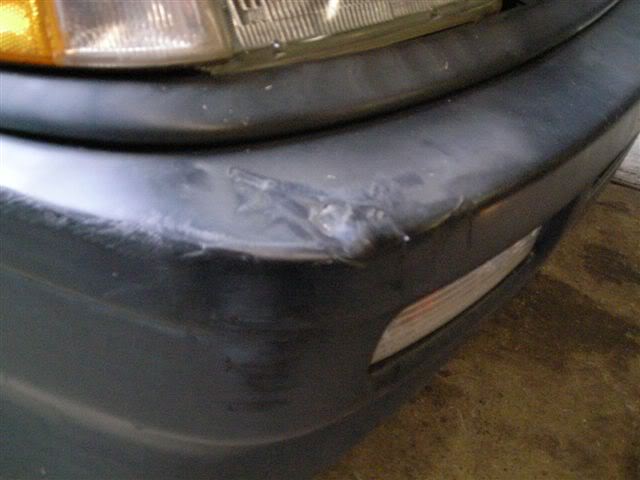

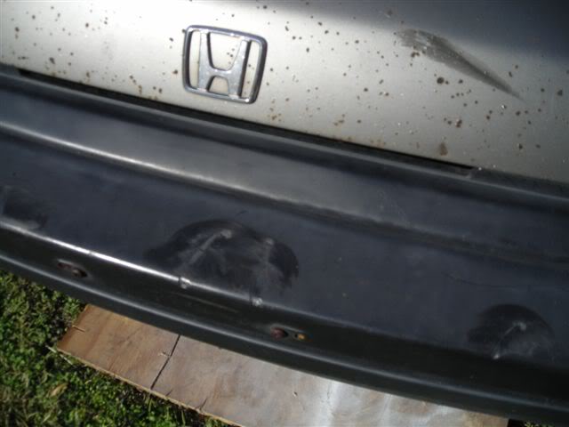

What kind of filler can I use on the bumper cover? Will regular bondo stick or do I need something more flexible? It has some gouges and scrapes, but I'm having no luck locating a better example. Plan is to paint it black along with all the other trim.
I've been running an EF sedan bumper and cover since I put the car together, but this one looks so much more...wagony.
Jealousy doesn't even begin to describe what I feel seeing that
don't use fiberglass on plastic, it will always come loose and crack after a while.
you got to use special plasic filler for it.
or get a complete fiberglass bumper. then it's always easy to repair with fiberglass.
not to my knowledge, but I'm going to build my own.
you can always modify a fiberglass one for a crx to fit your wagon.

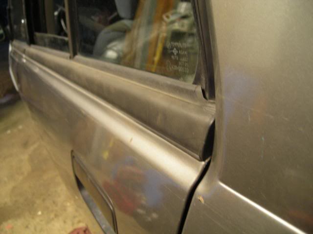

Those moldings are a PAIN to remove...better than masking twice, tho
does anybody know how to get these off without destroying them?

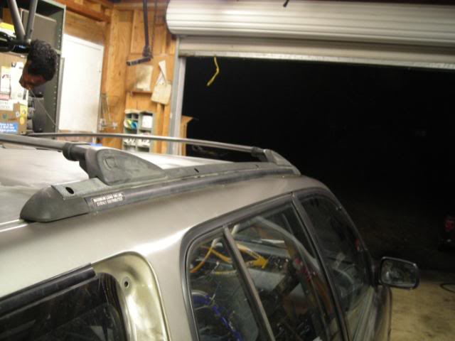

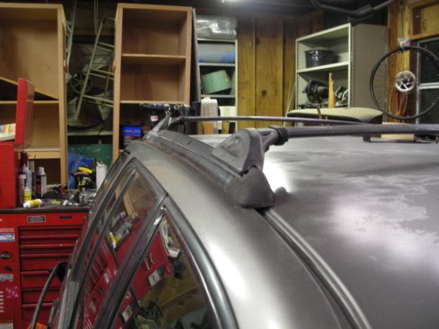

Think I've decided to use this rack (Kia Sportage) sturdier and longer than the OE
This should be all the pics:
http://s152.photobucket.com/albums/s162 ... filter=all
early 90's? not too hard, just put 8 1/4-20 nutserts in the roof skin, then cut 5 1/4" off the crossbars.
