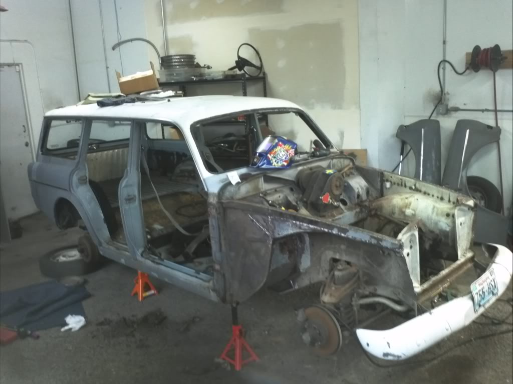

I bought a basket case of an Amazon sight unseen to take on and when I finally took possession it was just a bit too far gone. Rust and missing parts (the wagon was actually headed to the scrapper) kind of made the wagon a lost cause.

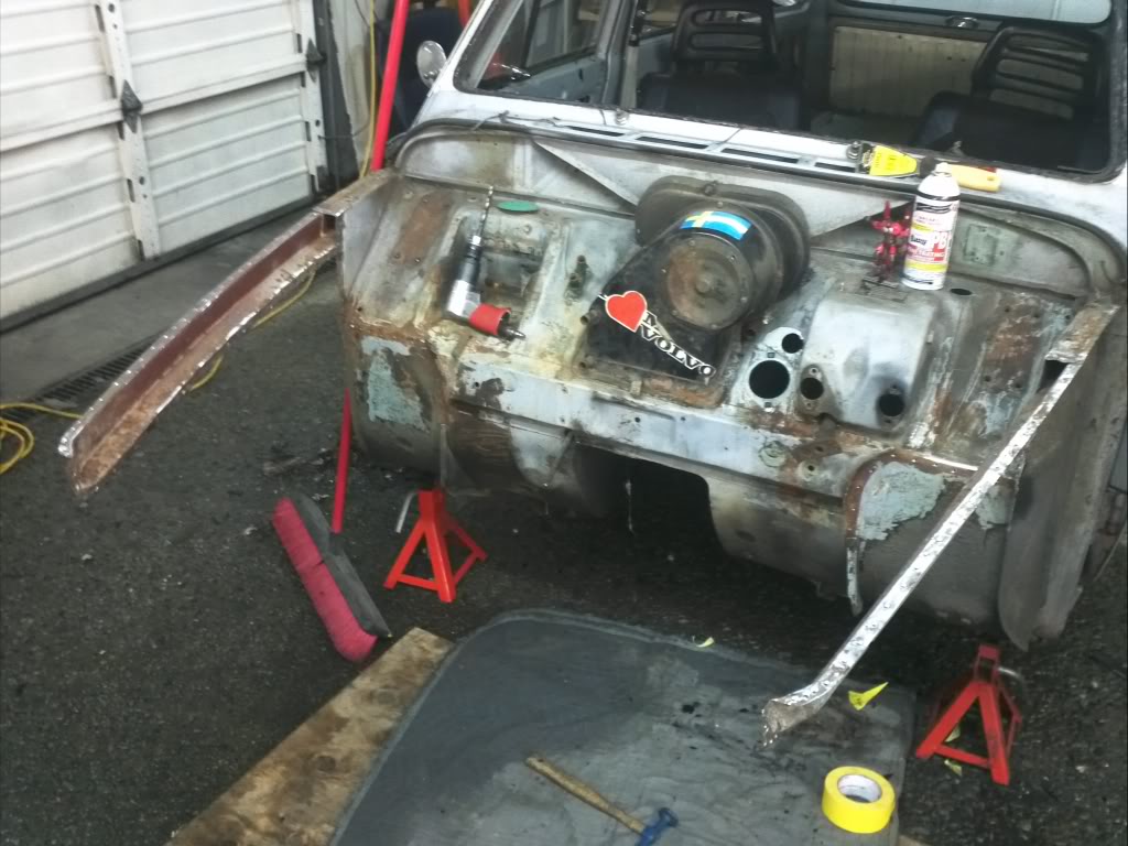

I sourced a parts car to try and get all the misc bits I needed and that's when I decided to pull the trigger and recreate an Amazon wagon two door. Volvo never made a two door wagon, but being a "barrel chested" kind of guy the 4" longer doors from a two door appealed to me, so I got started. The first thing I did was repair a bunch of rust on the frame passenger side firewall/frame horn. Then I cut out the B pillar and welded in the B pillar and a portion of the quarter panel from the coupe. All the work I did in a little two car garage I rented for a few months.

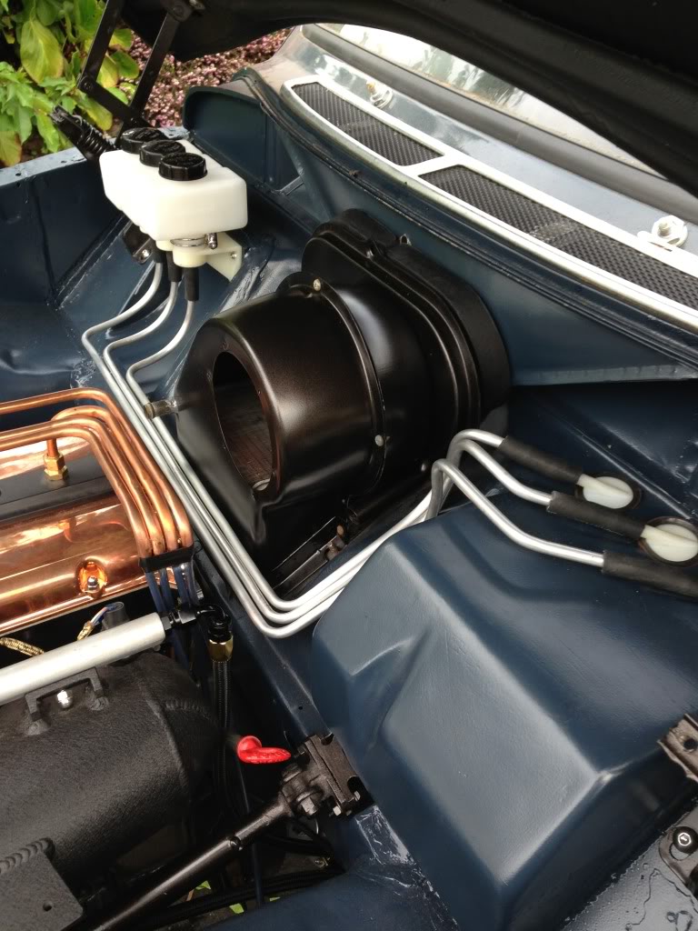

I wanted a vintage feel to the car with upgraded performance so I painted the engine dark, kind of military color and I kind of like the "steampunk" feel so I added a copper plated valve cover, copper hardlines for the wastegate and for a little added flare I ran the spark plug wires through copper tubing.

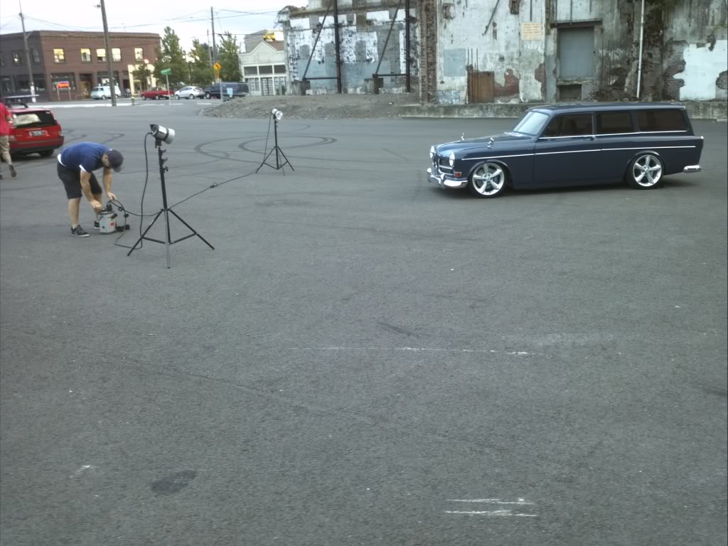

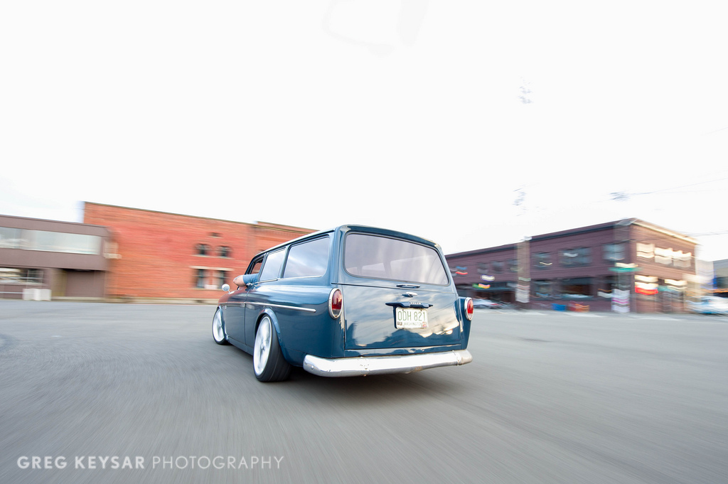

I reassembled it to get some exterior shots for a photographer that did a small write up on the car.

    Here's a couple pics of the rust repair:

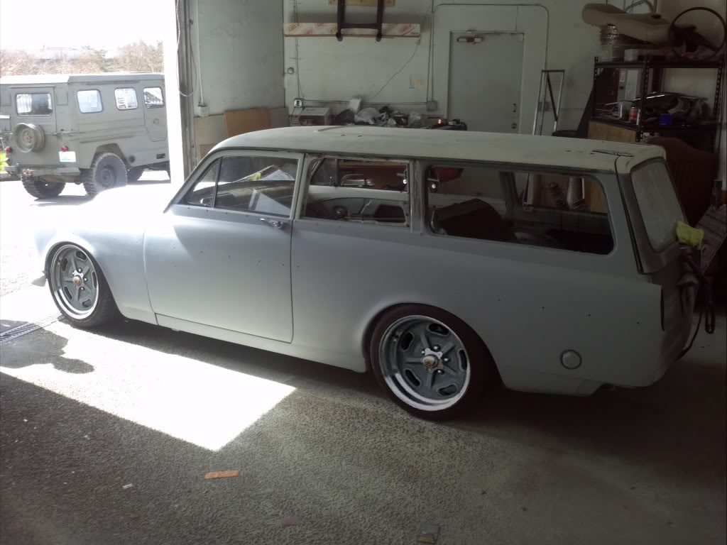

    The day I got most of the bodywork done I threw on some SE37s that were on my boss' Skyline:

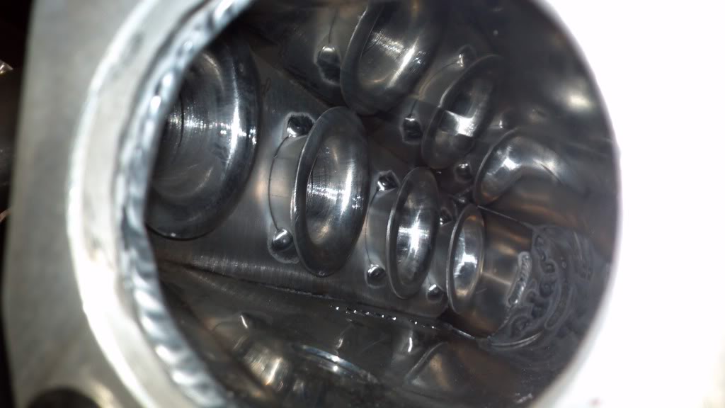

    Inside the custom intake manifold a friend of mine made for me (complete with my name welded in the back):

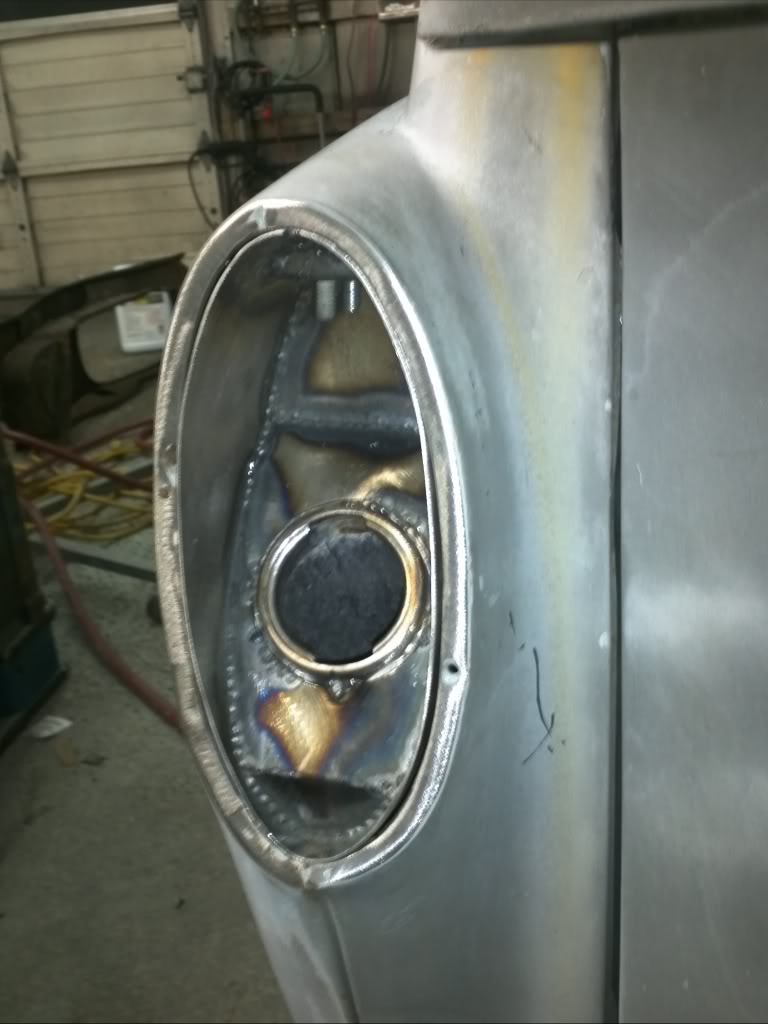

    I moved the fuel filler behind the taillight:
    My own pics when we did the photo shoot:
    I like hard lines and needed to make room for the engine so I did a triple Wilwood reverse swing pedal assembly with remote reservoirs:

  • Here's the pro pics

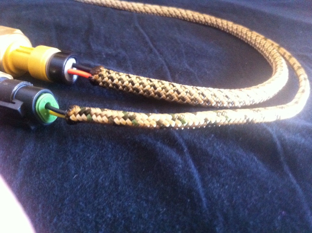

    I really wanted a "vintage" feel, so I came up with a cloth covering for all my EFI wiring.

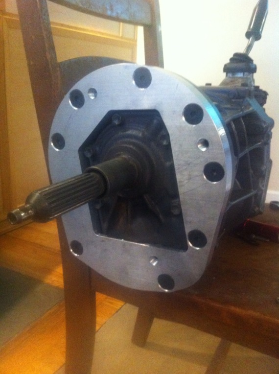

    I built my own aluminum adapter for the Toyota Supra R154 transmission

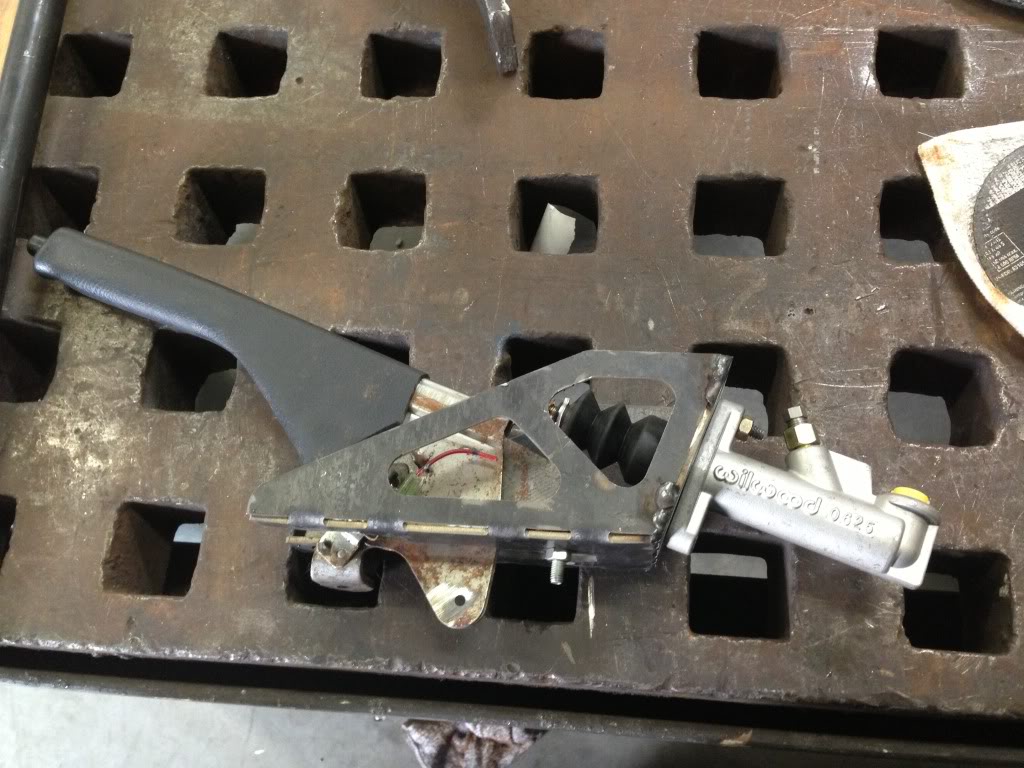

    Hydraulic e-brake assembly using an OEM handle I grabbed from the wrecking yard.

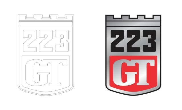

    I designed some fender emblems (I still need to have them cut) as a sort of play on the Volvo 123GT, but with the 220 chassis
