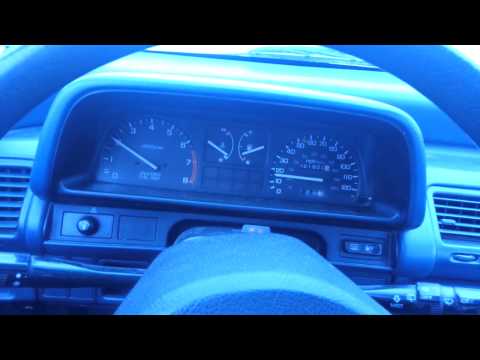

    http://www.youtube.com/watch?v=t96xafVtrPs&feature=youtu.be
    first start up was today. started up on the first crank! finally. ended the day with new axles in, and the car finally on the ground too. i was happy about it finally being off jackstands. the guy i bought it from had let it sit for a couple months before selling it, so itll move under its own power for the first time in quite a while tomorrow. just gotta fill up the tranny with fluid, and she'll be ready to go!

    got the kinks worked out of the wagon! after she started, i battled high idle problems, surging idle problems, distributor check engine light codes, and my coolant temp gauge not working. the coolant temp gauge was the most frusturating one. there was an open somewhere in the wiring from the sender to the gauge so i ended up just choppin it, bypassing the harness, and soldering a wire straight from the cluster to the sender. works great now.
    here's a quick video of a test drive i made:
    http://www.youtube.com/watch?v=JZWJDT8ATWQ&feature=youtu.be
    oh yeah, i relocated my battery to the back. dont worry its a sealed battery before everybody jumps on me about toxic gases in the cabin.
