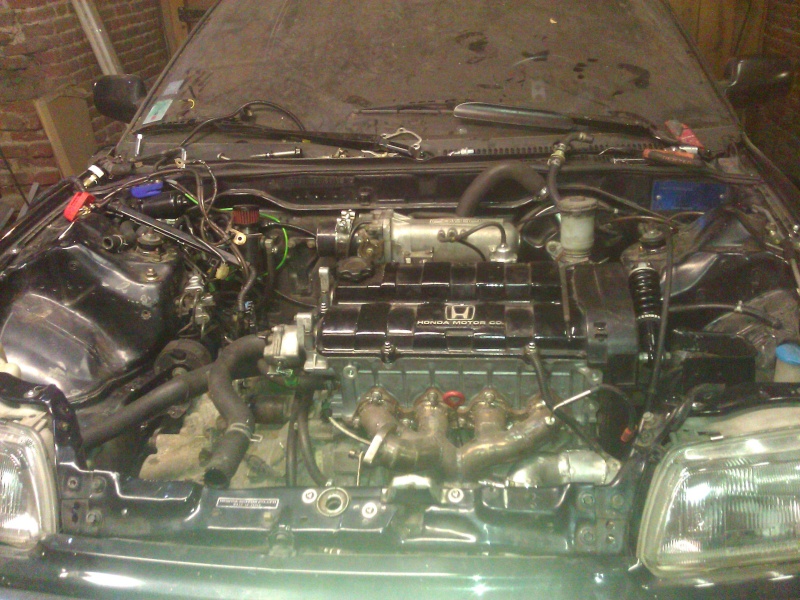

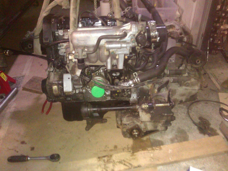

Complete Homemade Turbo kit T28 from Nissan S14

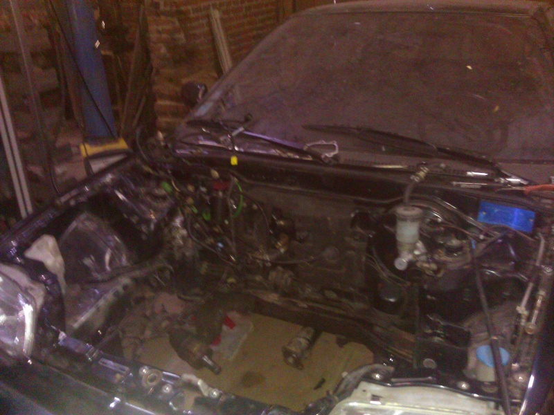

:hopelessness:

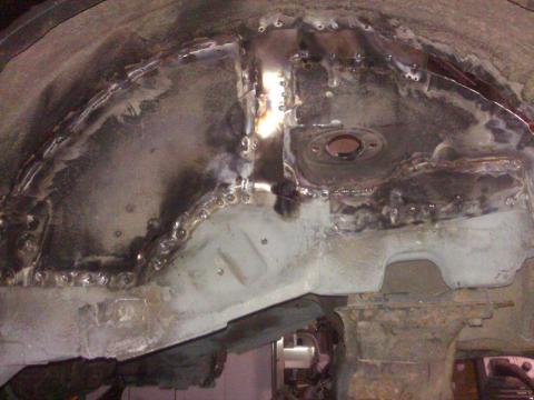

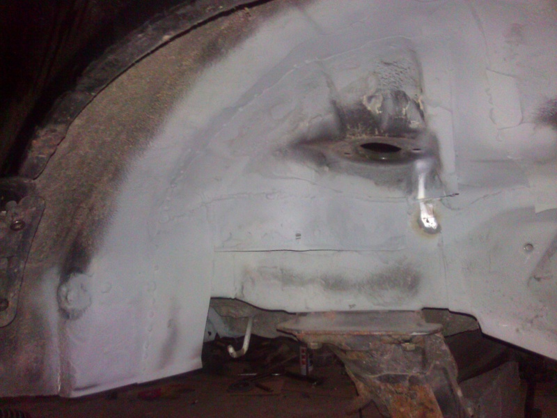

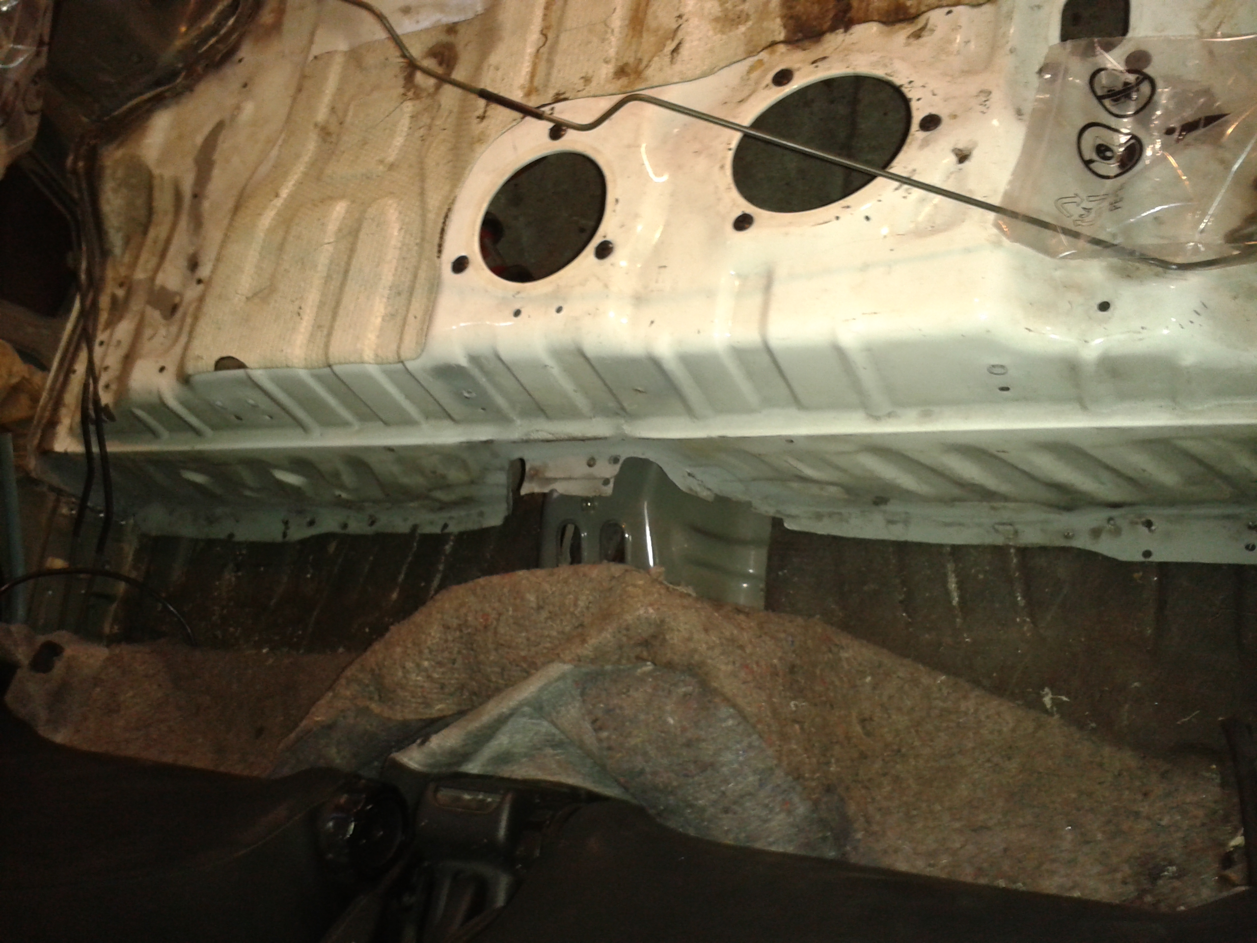

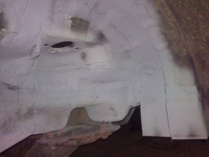

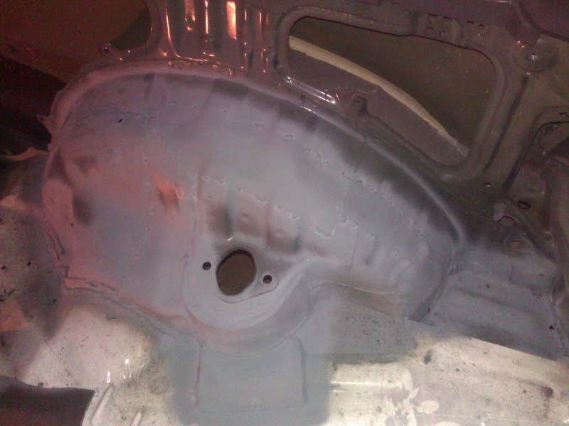

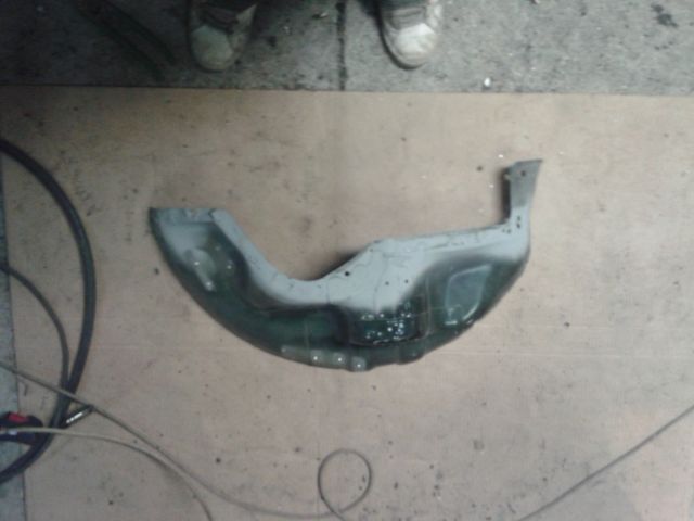

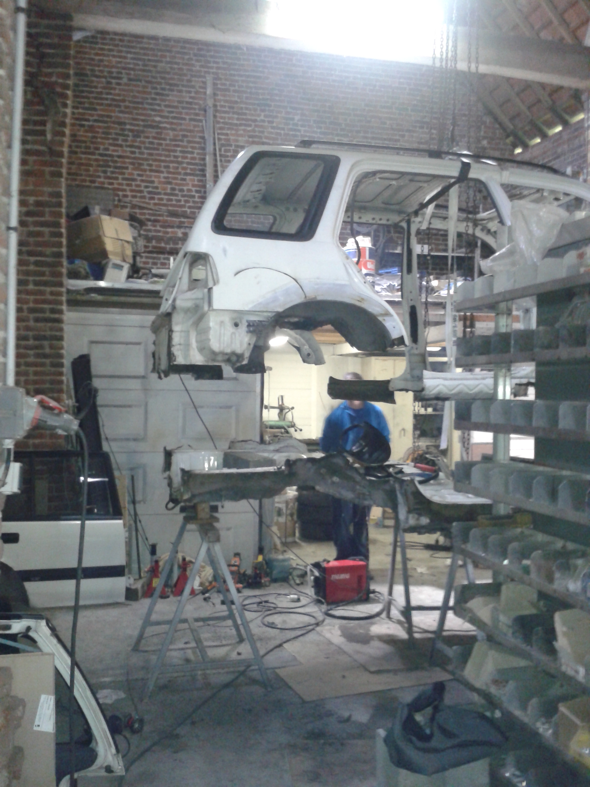

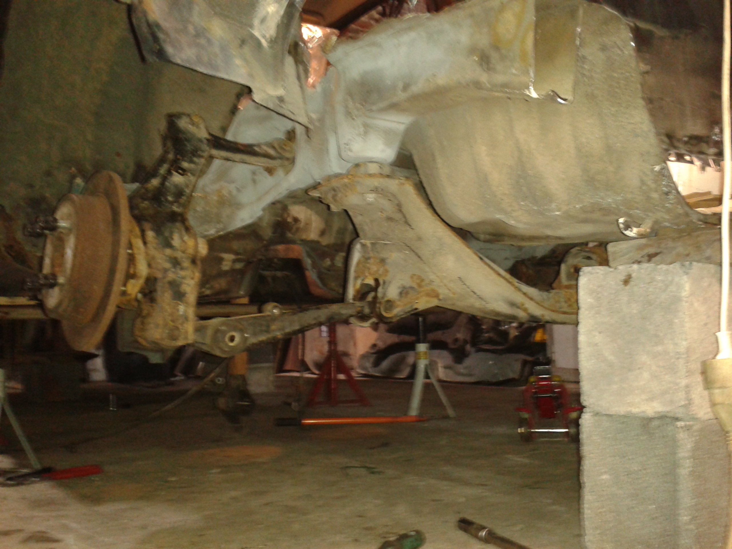

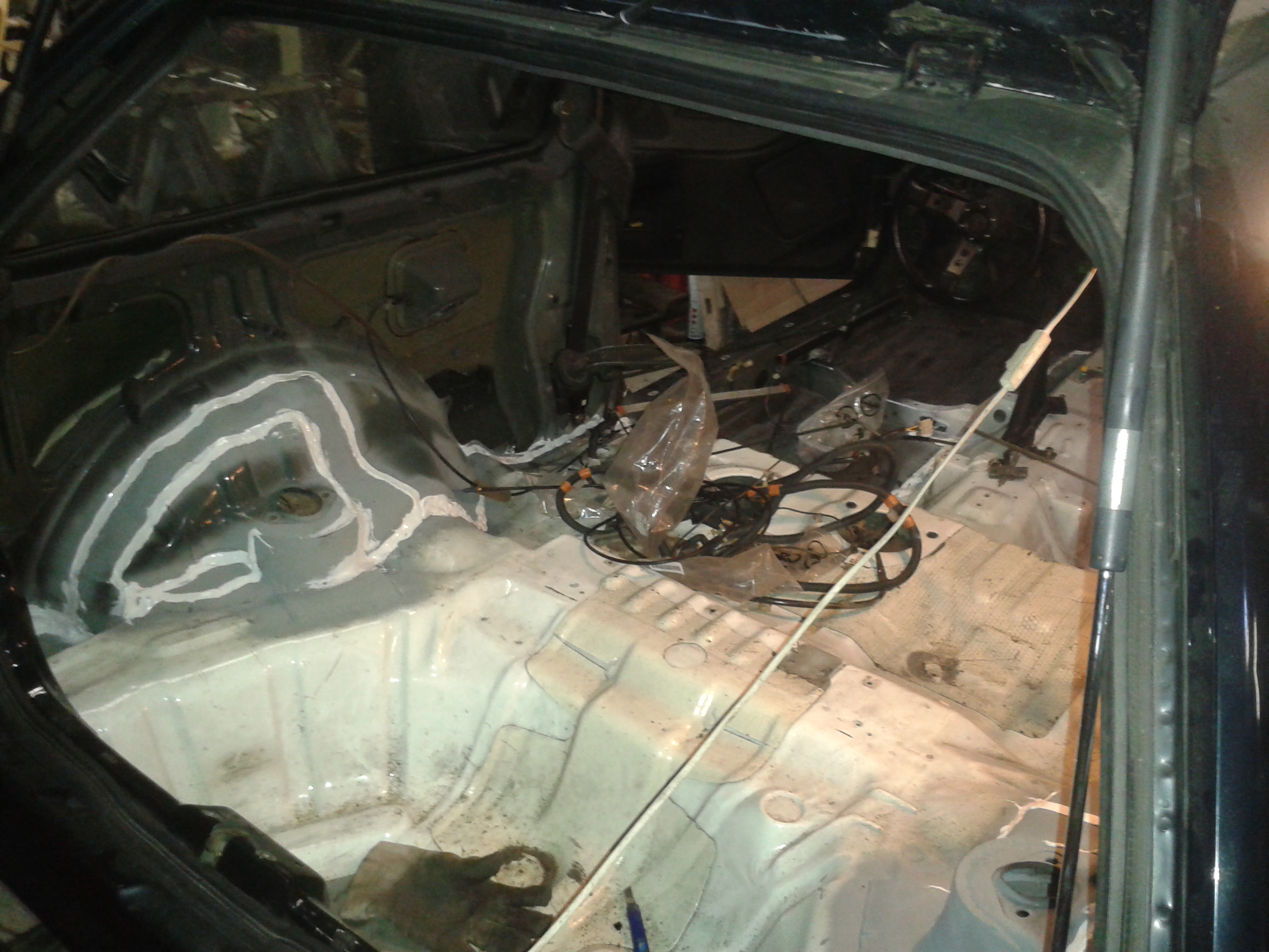

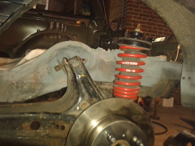

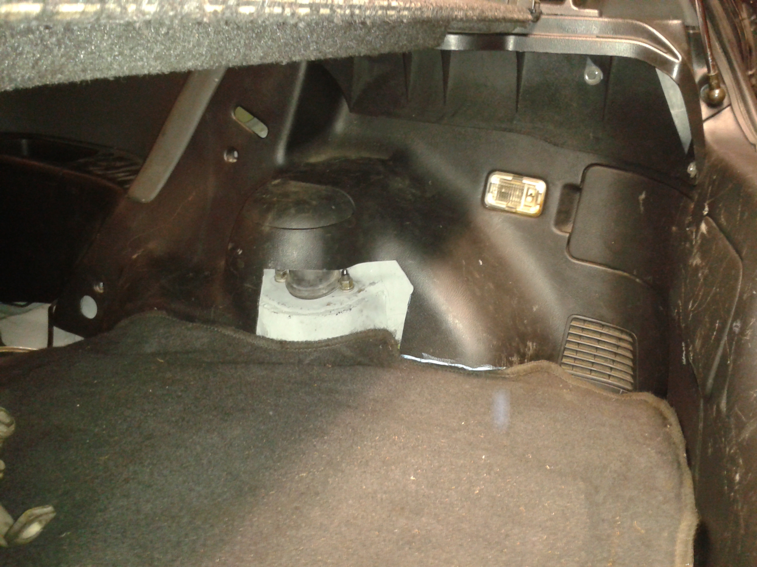

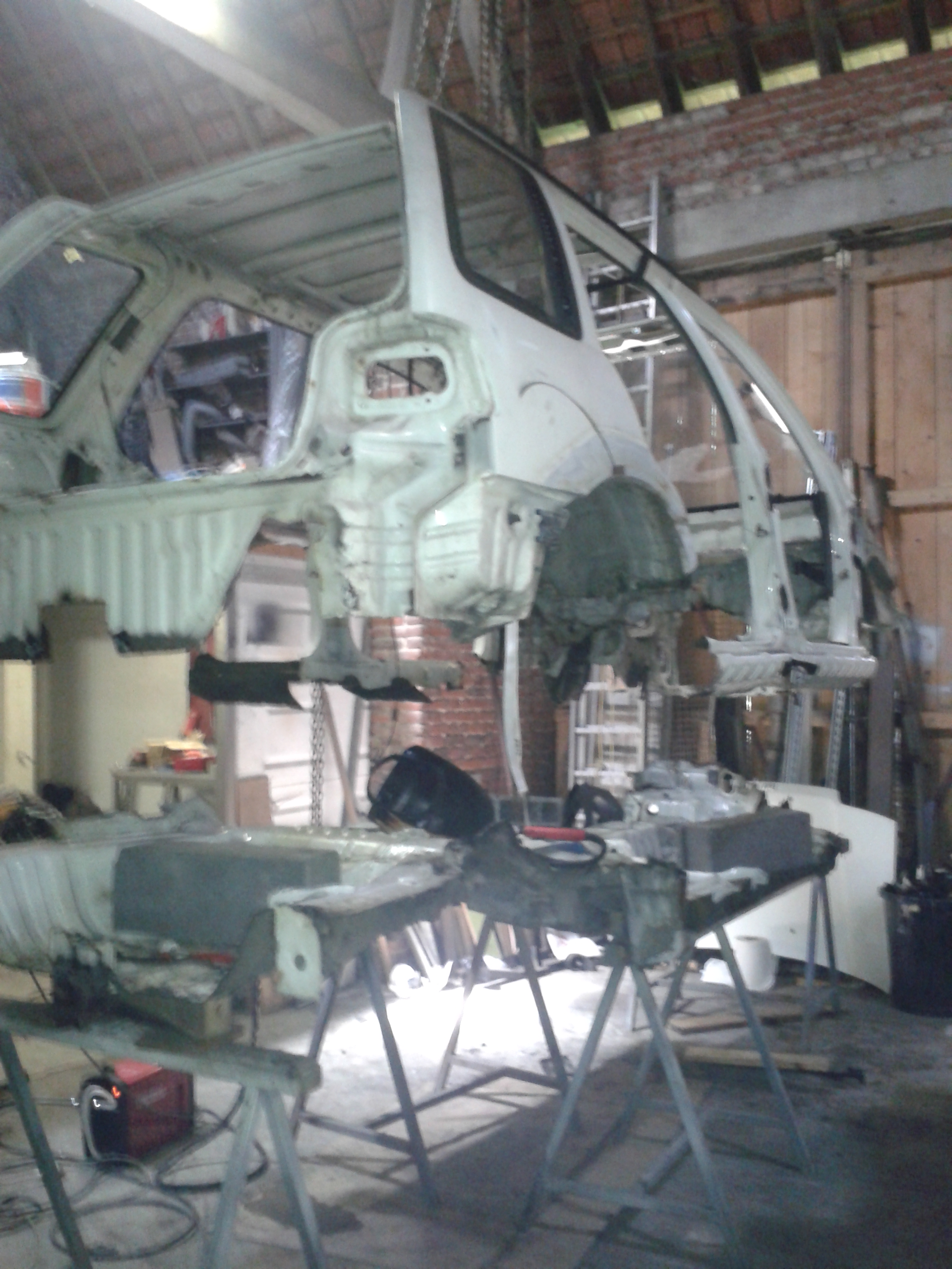

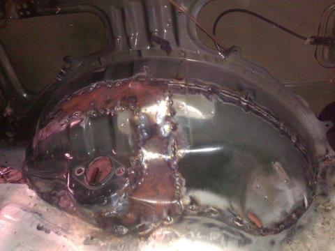

Now rear suspension has to be 5cm more in the rear and 2cm lower
So we are modify the rear wheel arch:

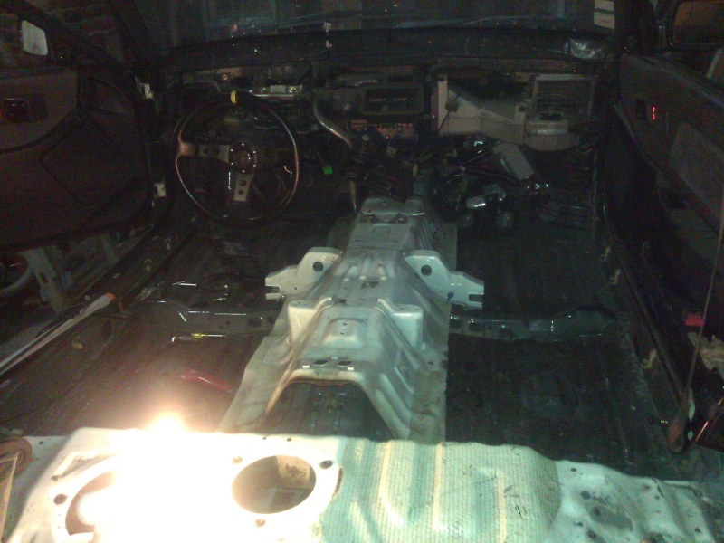

Now we will finish the other side, the back is already finish, and after we have to modify the tunnel!!
ditto.
very impressive.

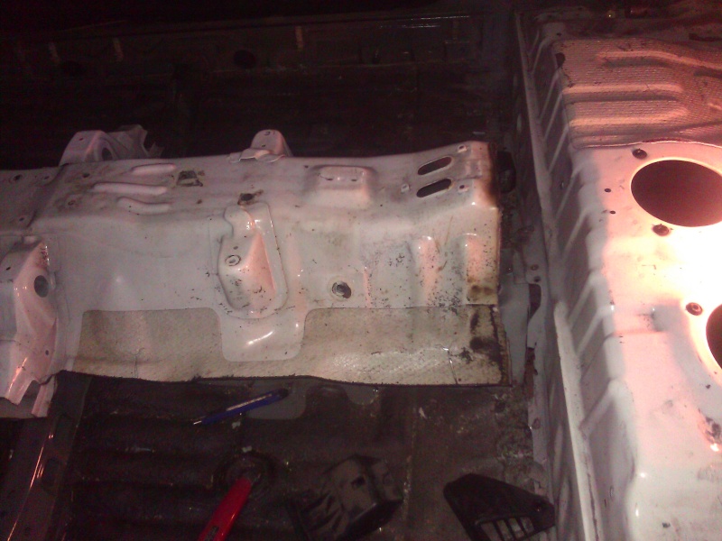

so your floorpan swapping the rt into the ef9?

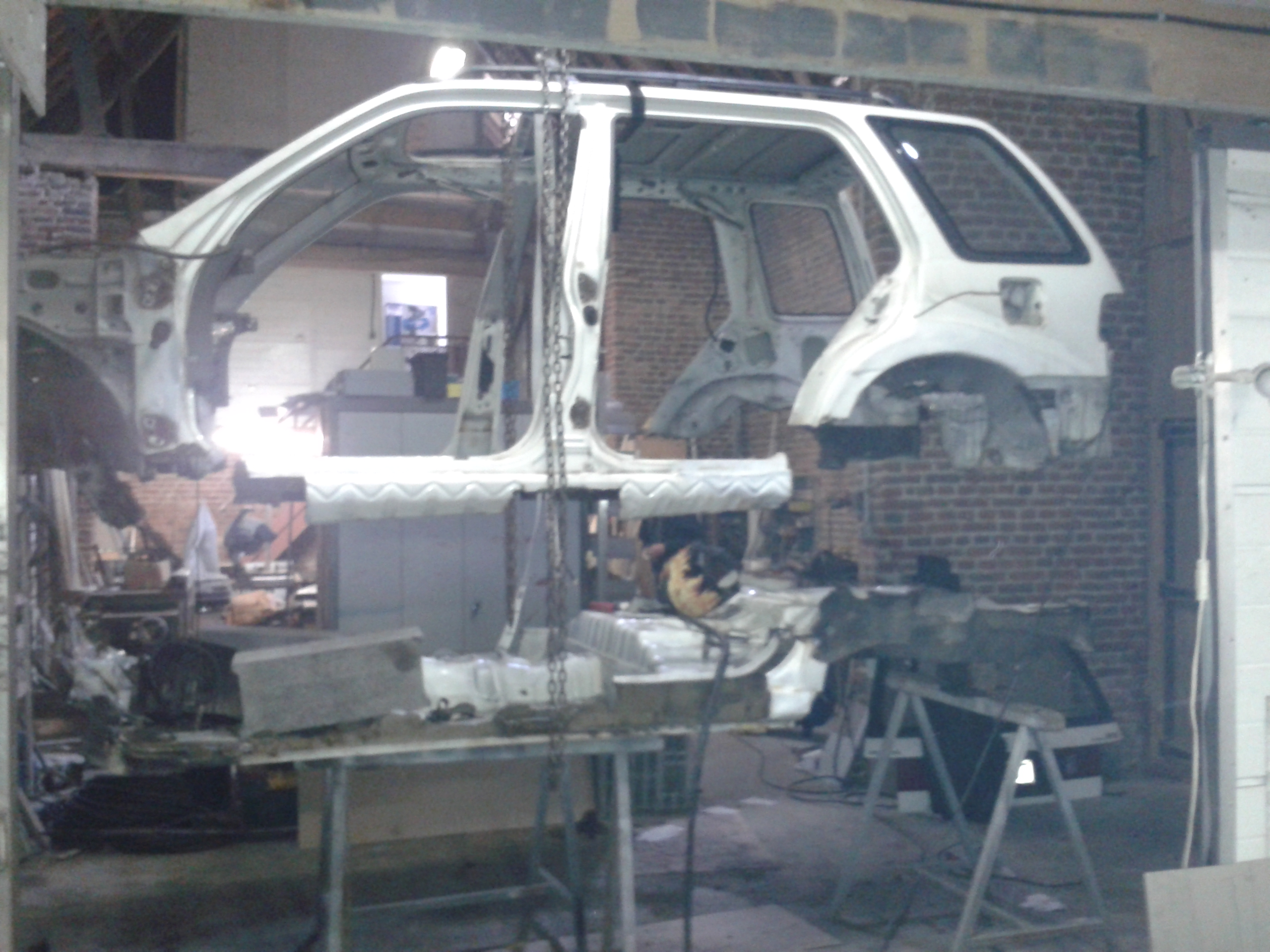

There are others ways to do the conversion, maybe easier, but my purpose is to have something discrete, something like Honda could do.

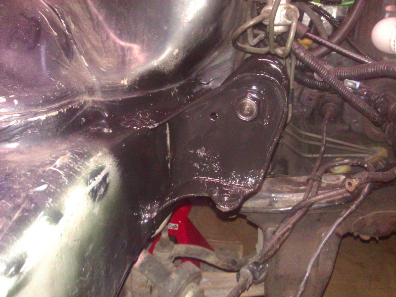

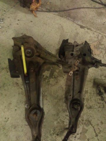

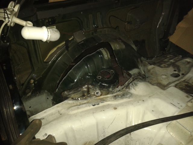

Some pictures of yesterday:
rear right
rear left
rear right
rear left

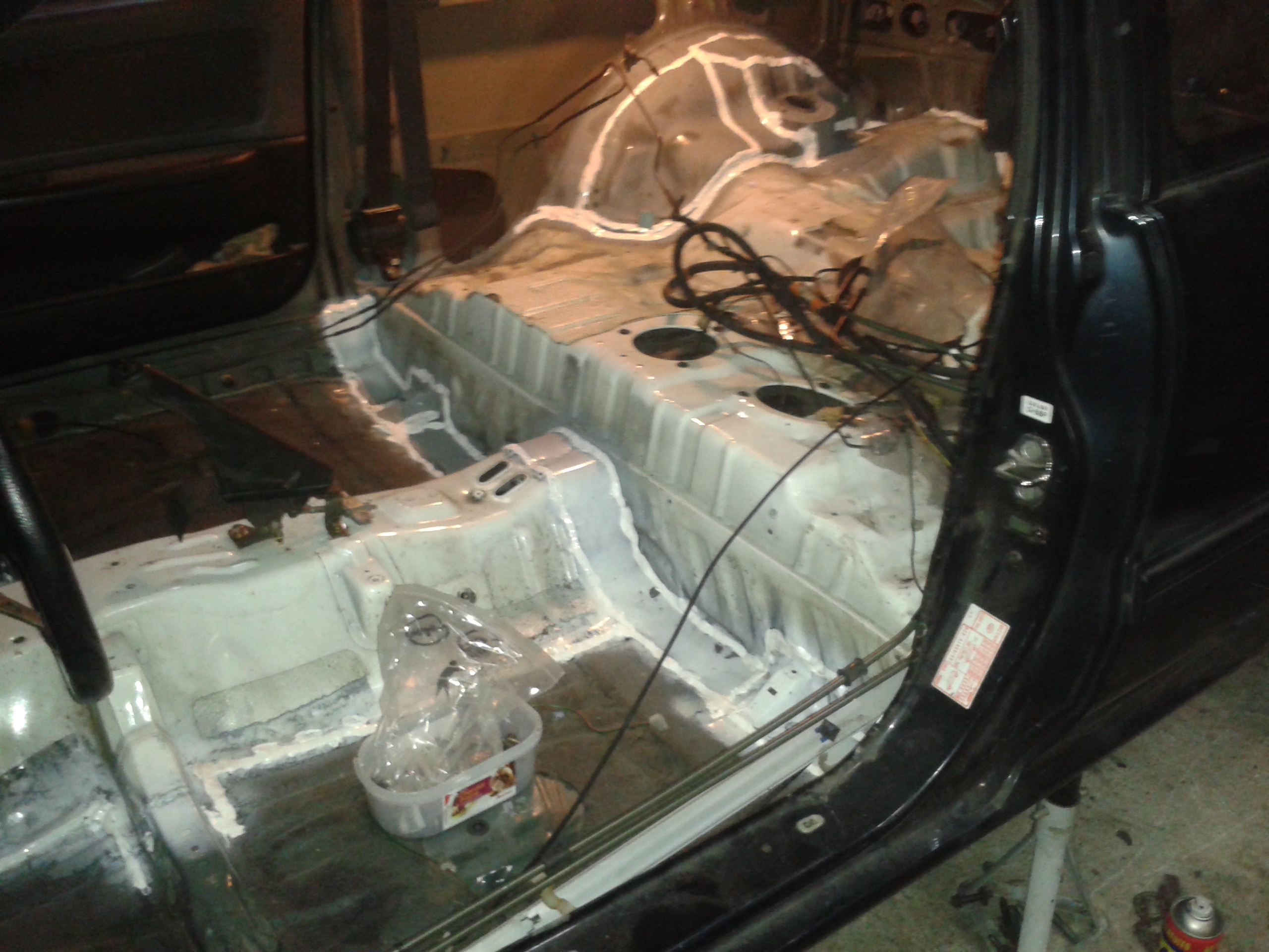

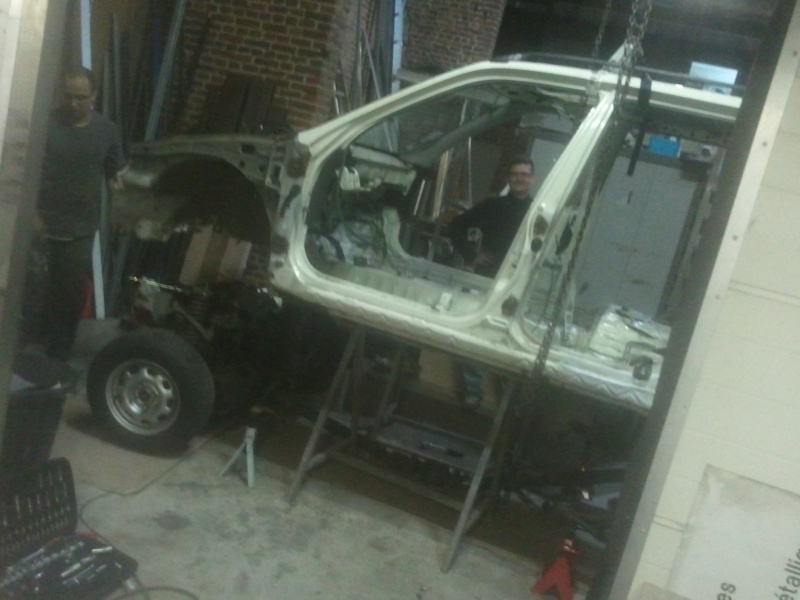

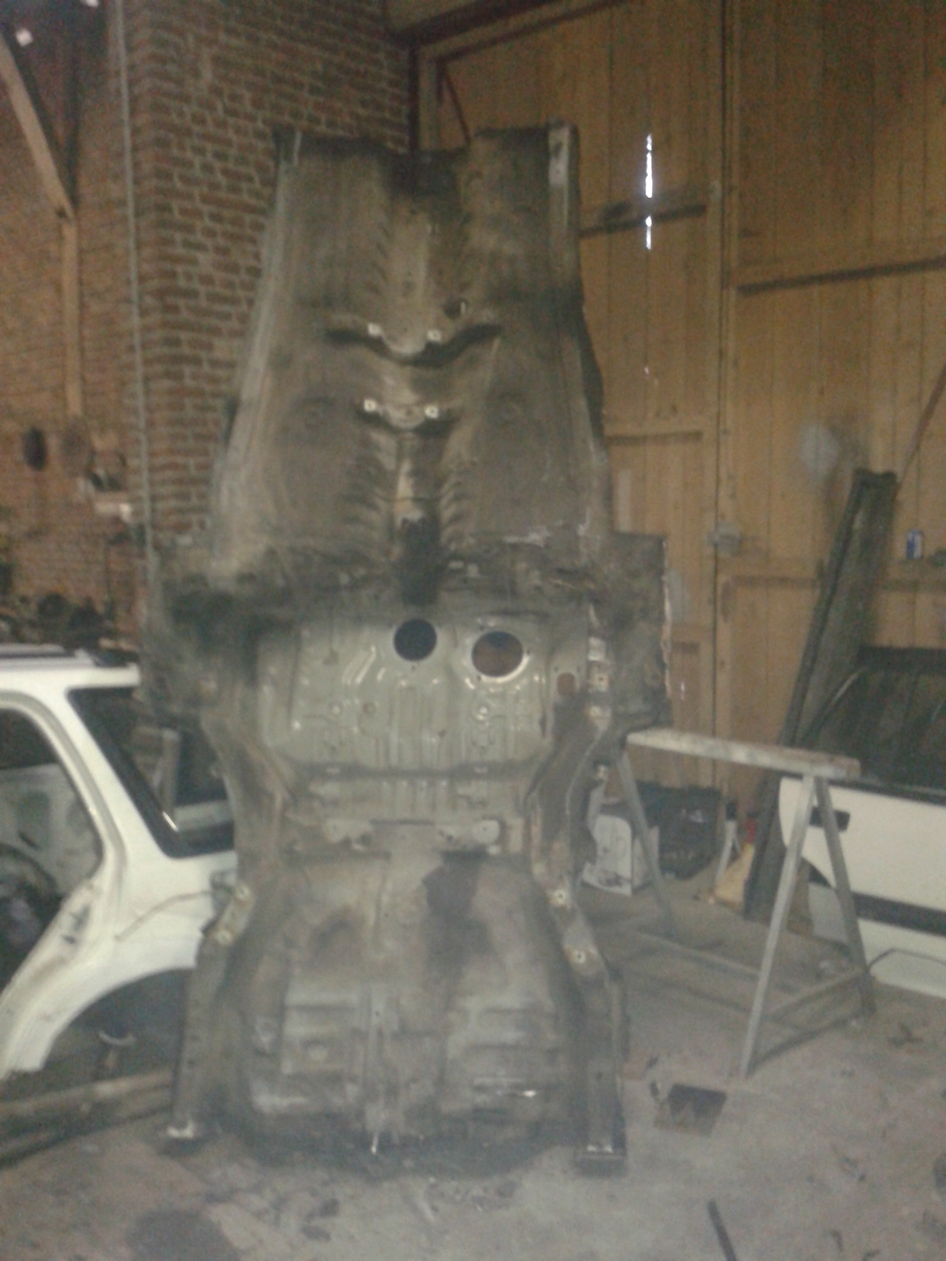

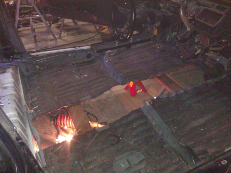

Just to see the difference:

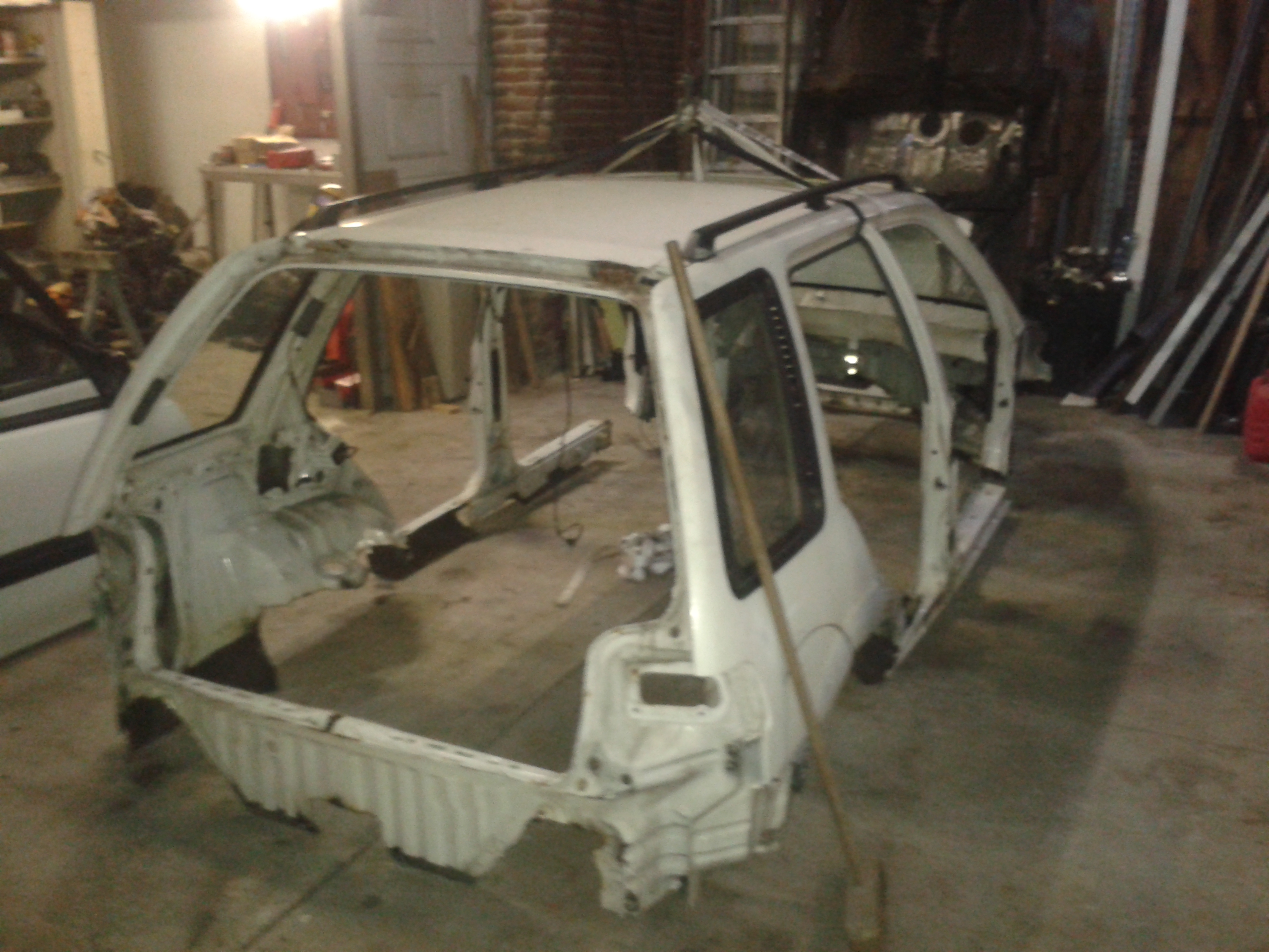

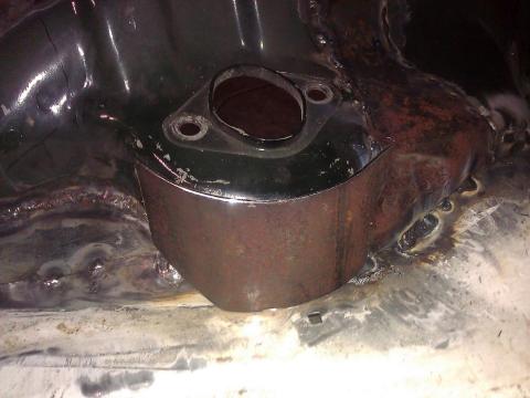

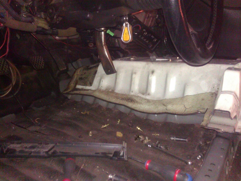

At the beginning, I wasn't thinking that we will need to swap the tunnel so we have cut it too short at the rear end... So we will have to adapt a little... Nothing compare to the rest lol
I will have to modify the fixation of my seat too, on the tunnel side they are higher than on the Civic...

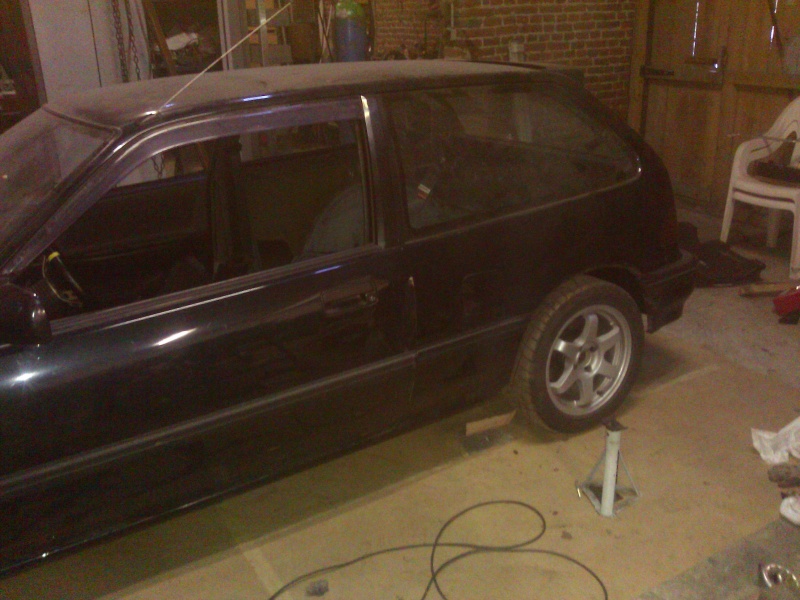

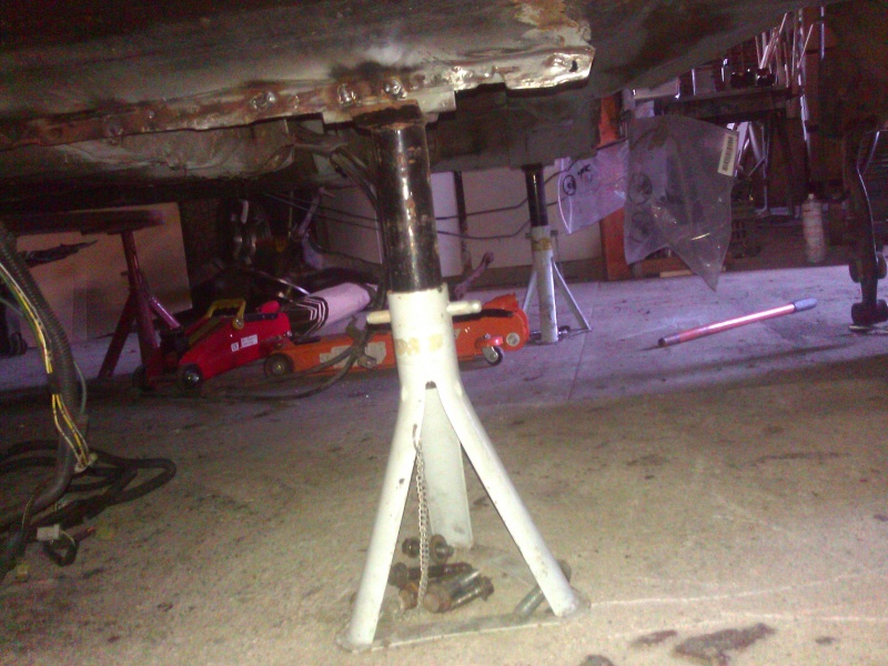

The car is back on his jack points, welds seems to be stronger enough ^^

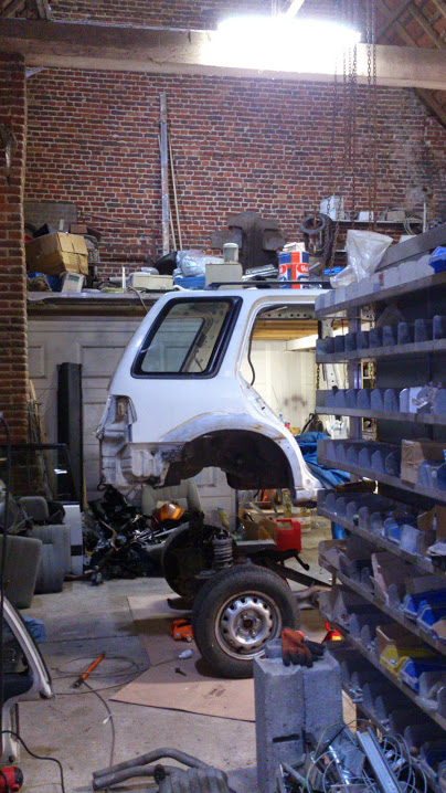

Want to come off with that shuttle roof rack?

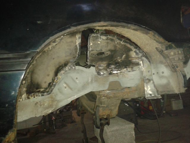

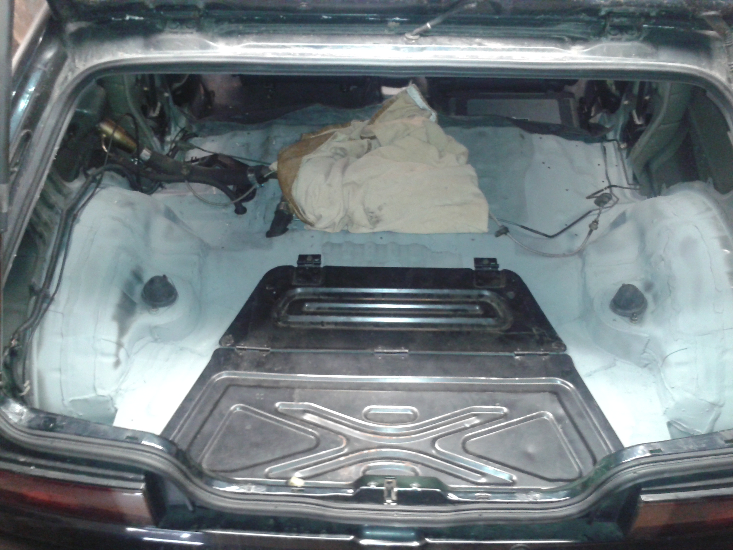

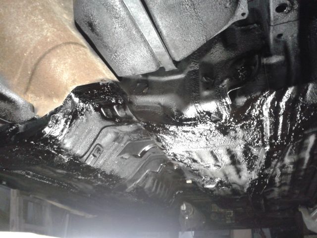

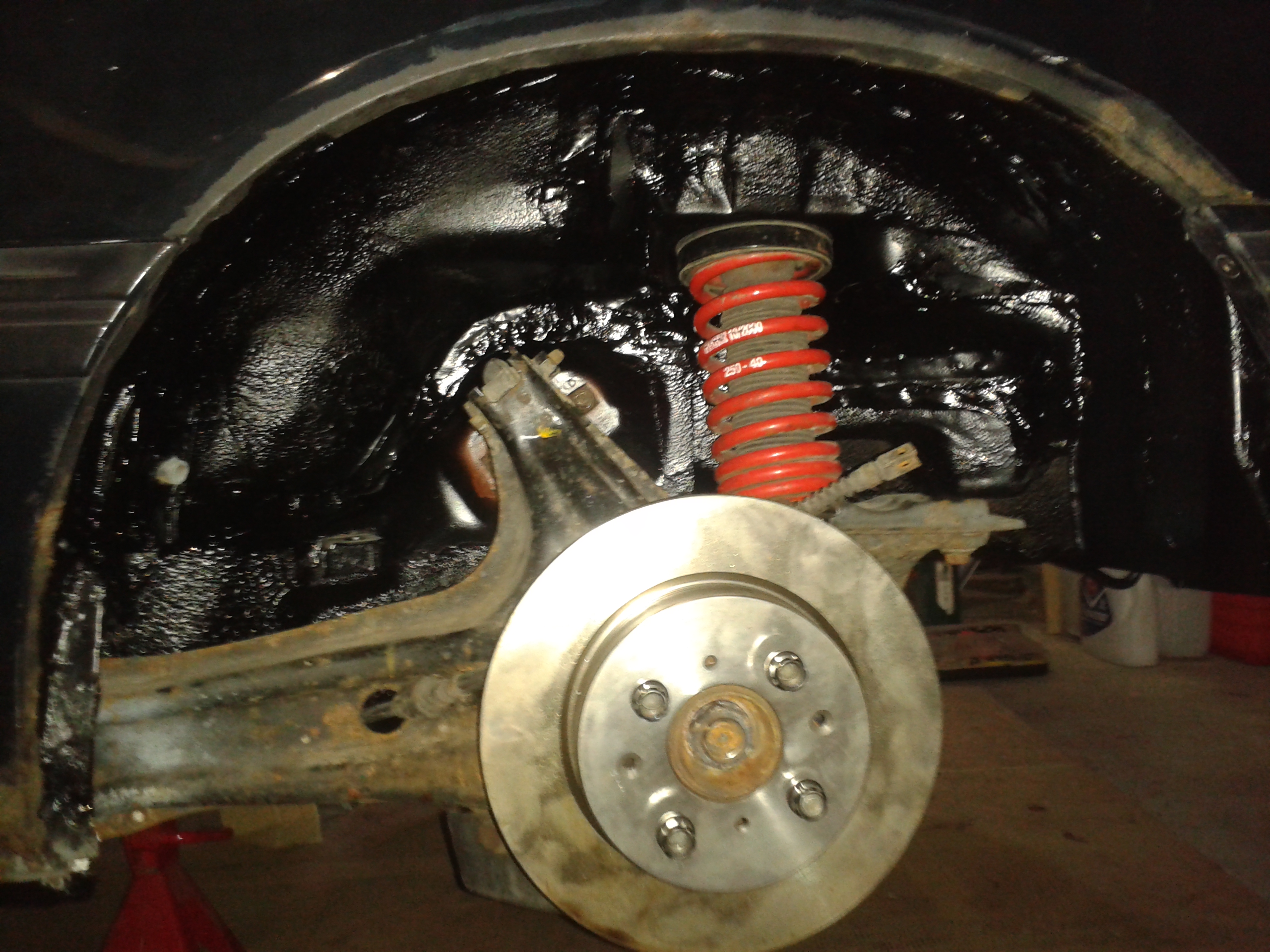

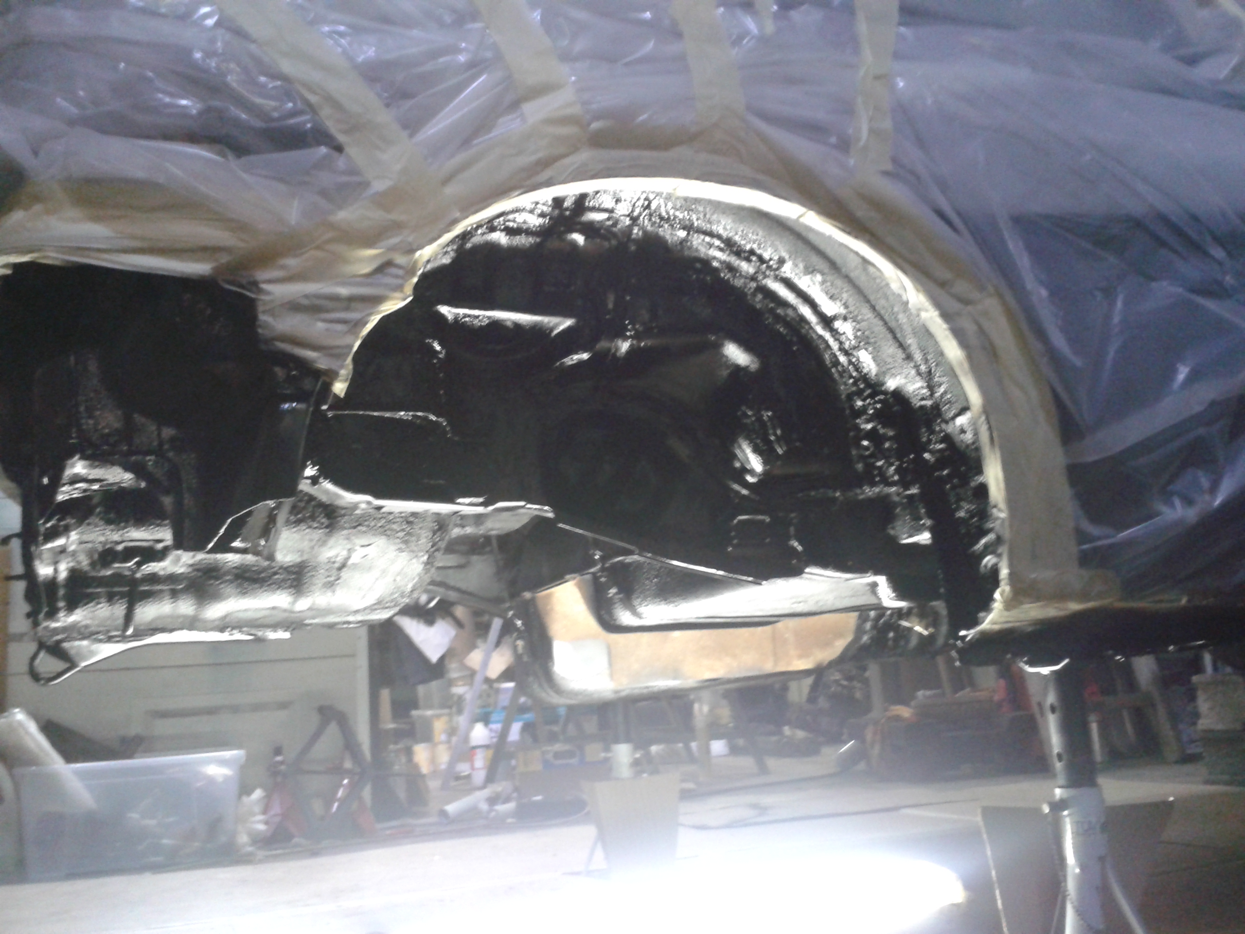

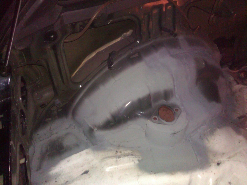

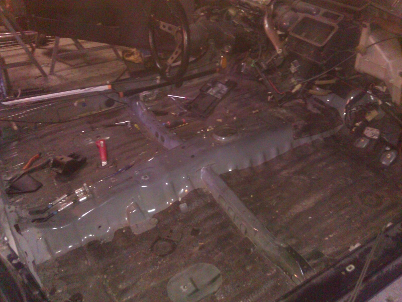

Welding is finish, sealing too, now we have to protect the underbody. And maybe next week end put the 4wd gearbox !!
Some pictures:
Next step is fuel lines, brake lines, seats etc...

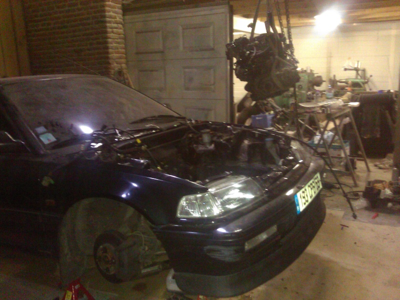

For the moment, I have never try the car in summer so I never met any problem. Now I have a jacket on the turbine and with the next step, I will delete the Tbar to take away the radiator.

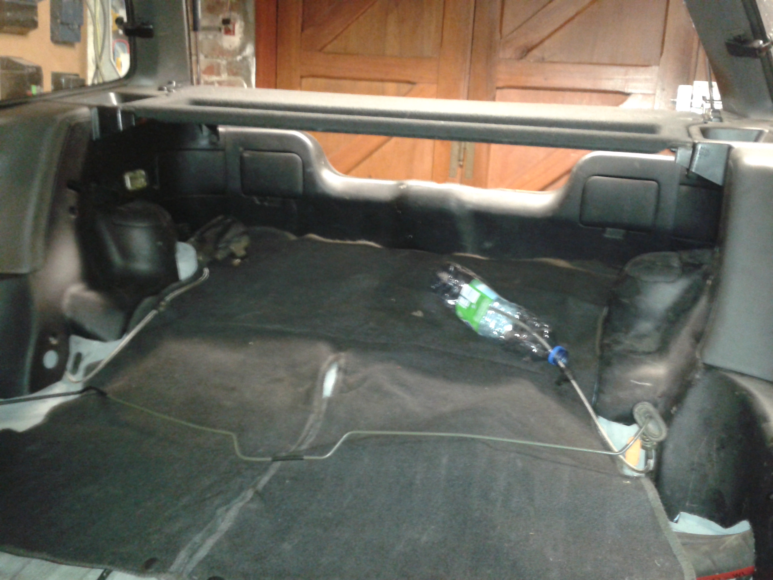

We have mounted the rear drivetrain, fuel lines, now we are modify the fuel tubing from the fuel trap, we have also made the hole for the tranny cables... Sorry I don't have any pictures and tomorrow I will leave for 2weeks in Portugal...

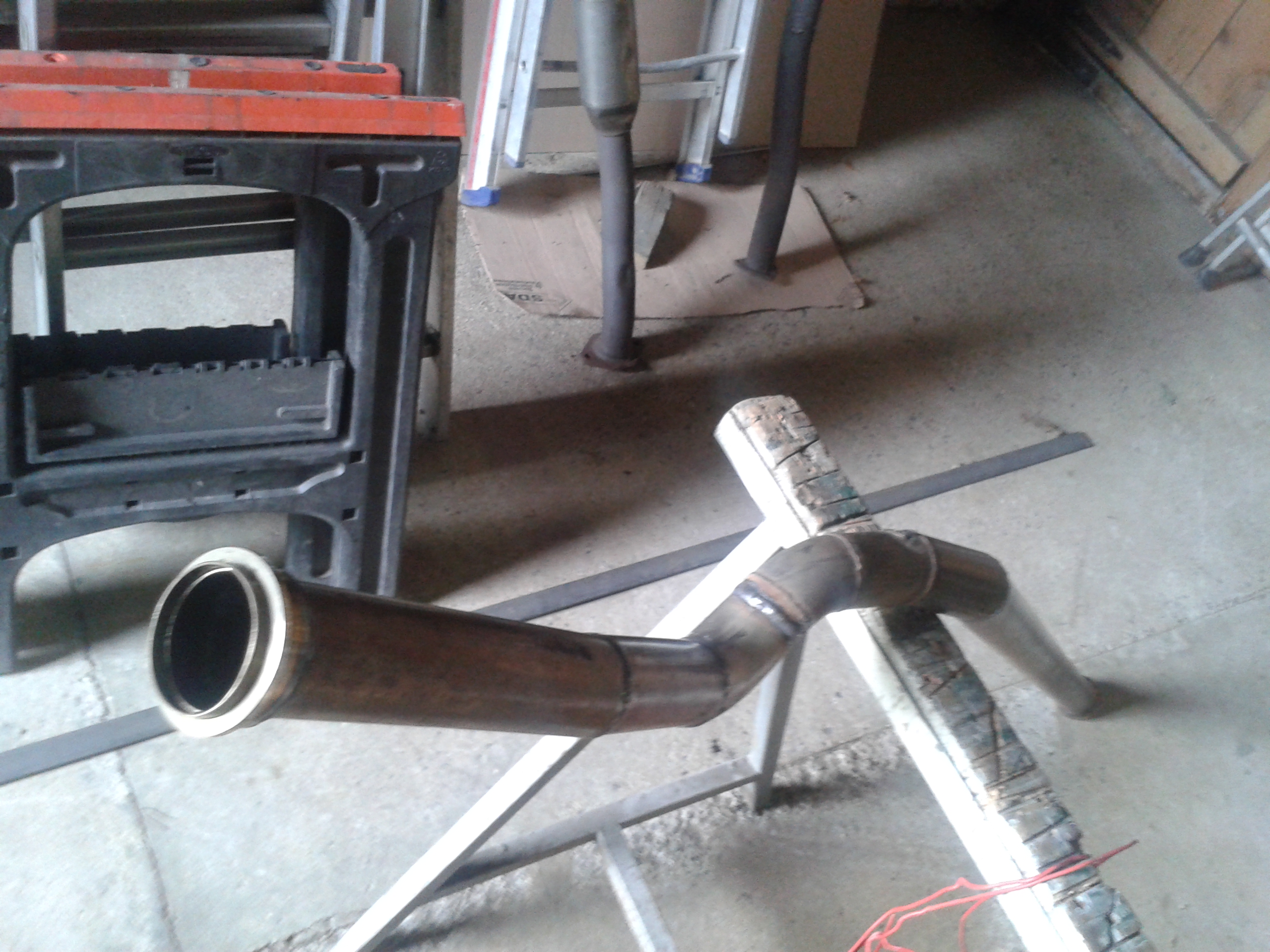

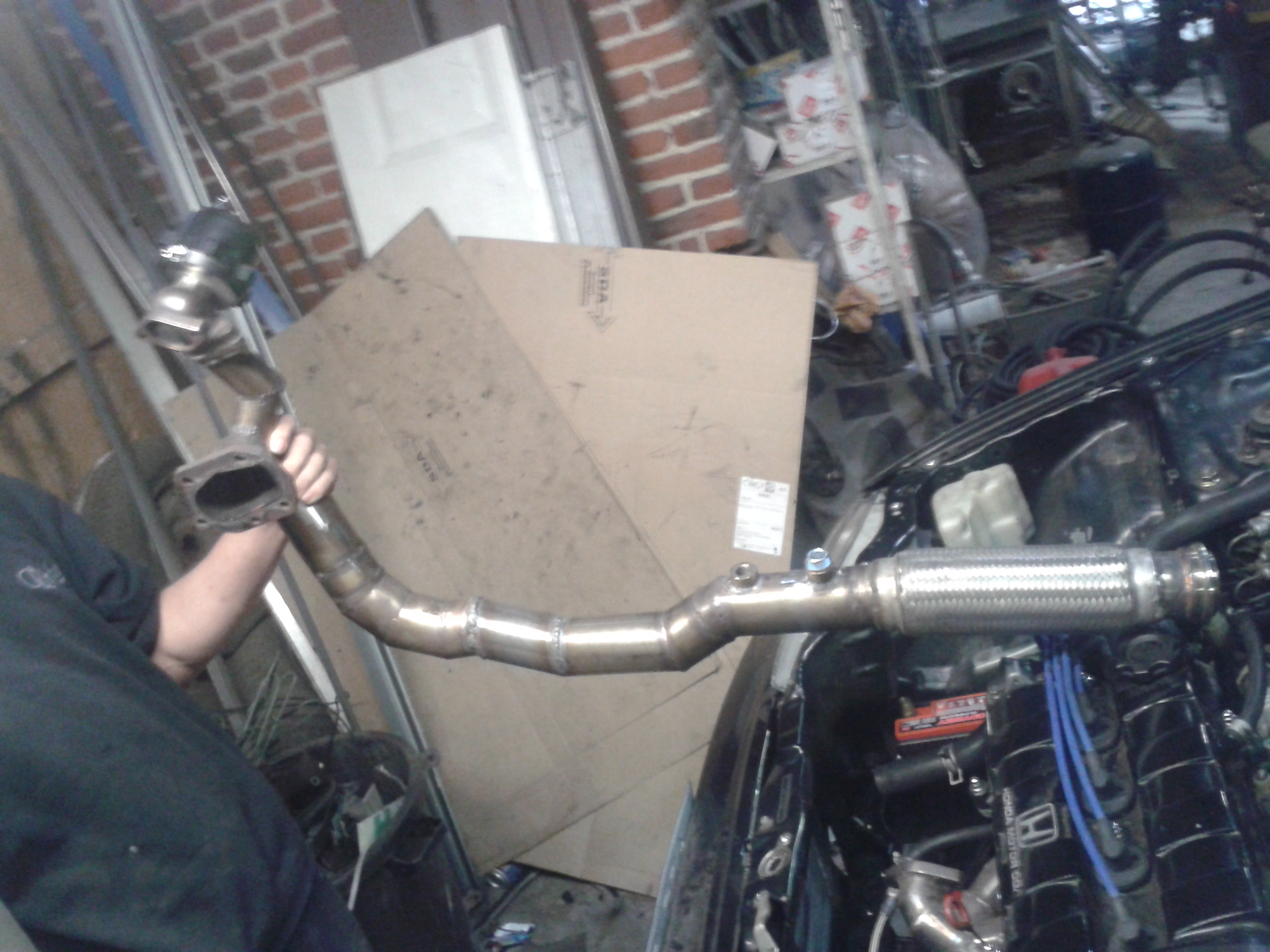

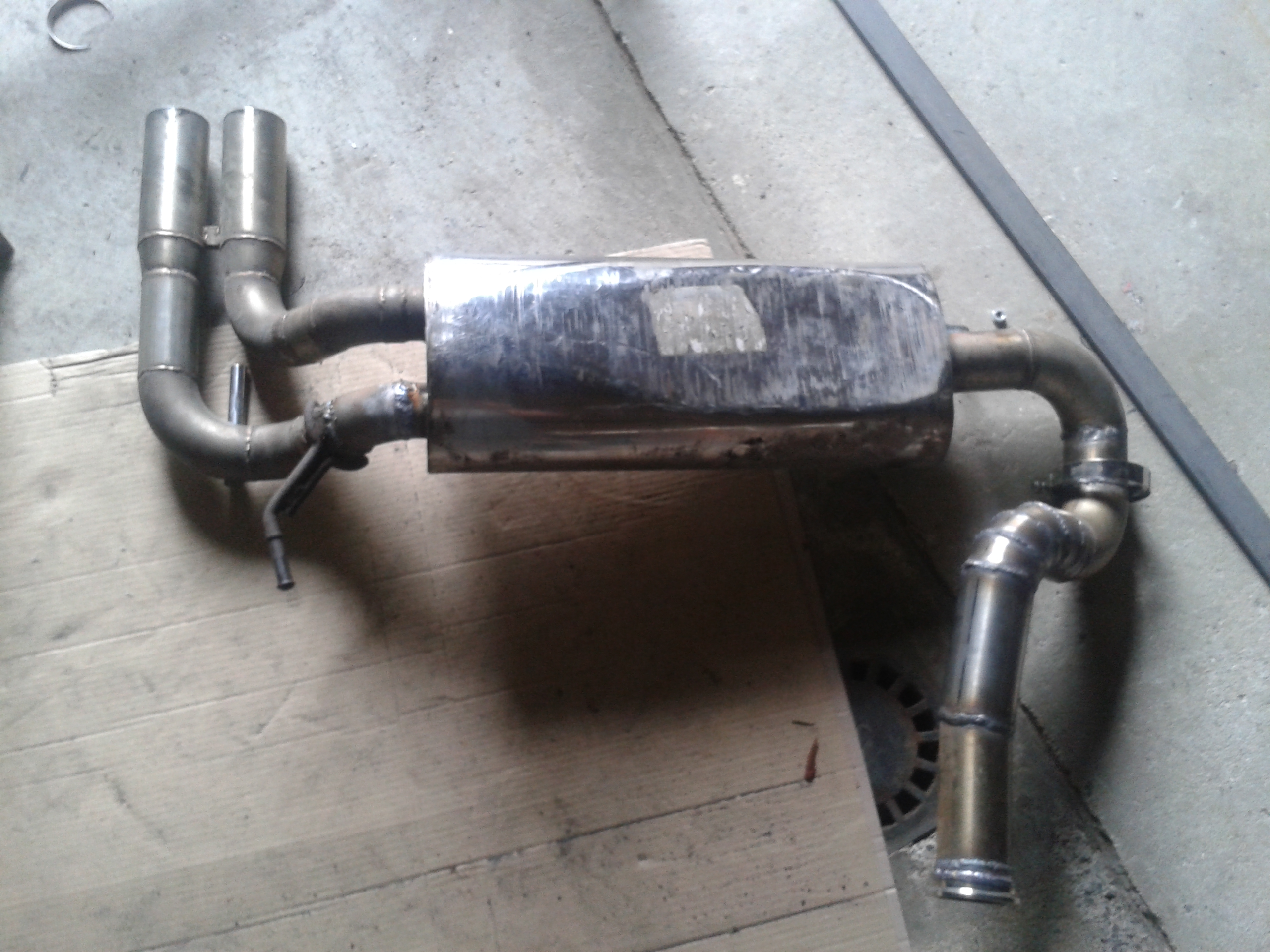

And the exhaust:

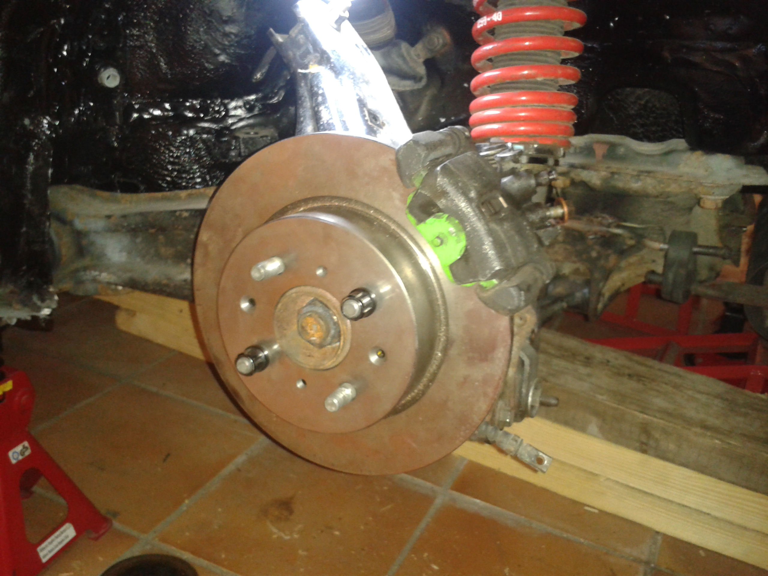

We will finish the car maybe next week, but I don't have brackets for the rear disc conversion... Maybe I will wait for the Lowflyin' brackets or if it is too long we will have to fabricate them...

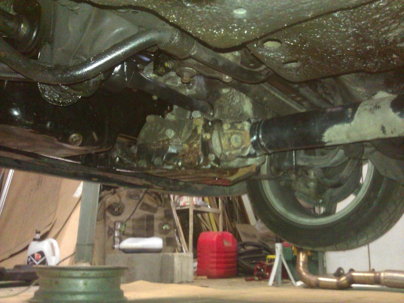

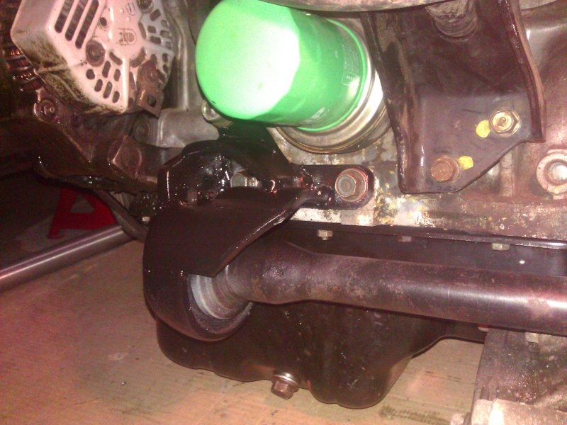

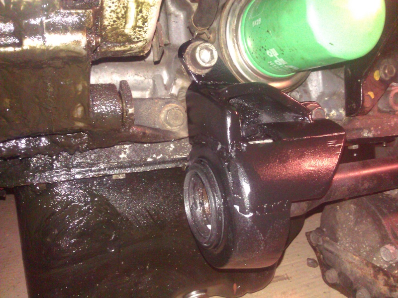

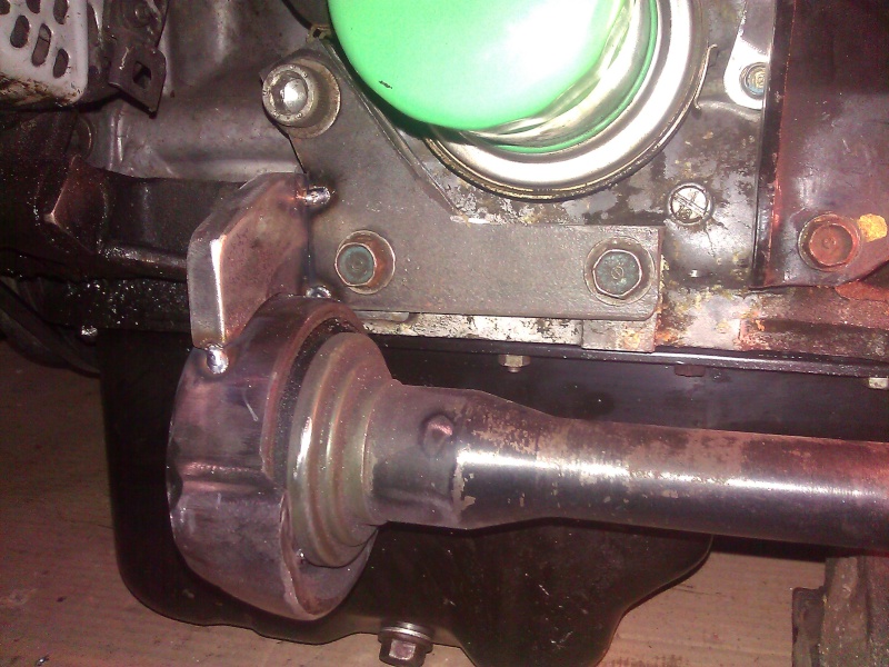

I need to change differential mounts, it shakes a lot and hits the rear subframe apart this all goes well, for the moment...;)

Tomorrow I will try to design some brackets to hold rear calipers and contact some machinist this week...
I see what you did there
First drawing of the calipers brackets is sent to the machinist for quotation and feedback.
It needs some minors modifications but for quotation should be enough.

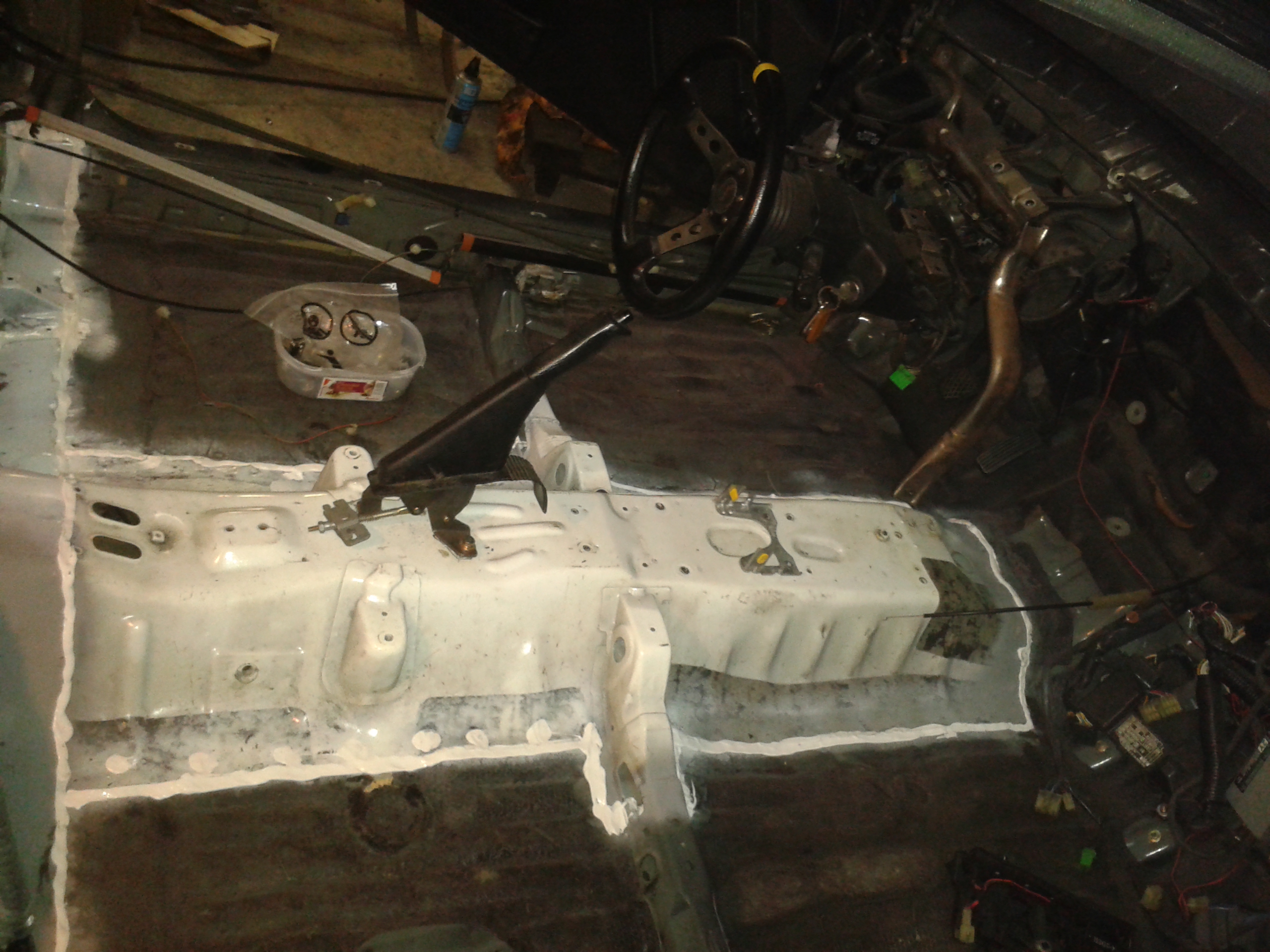

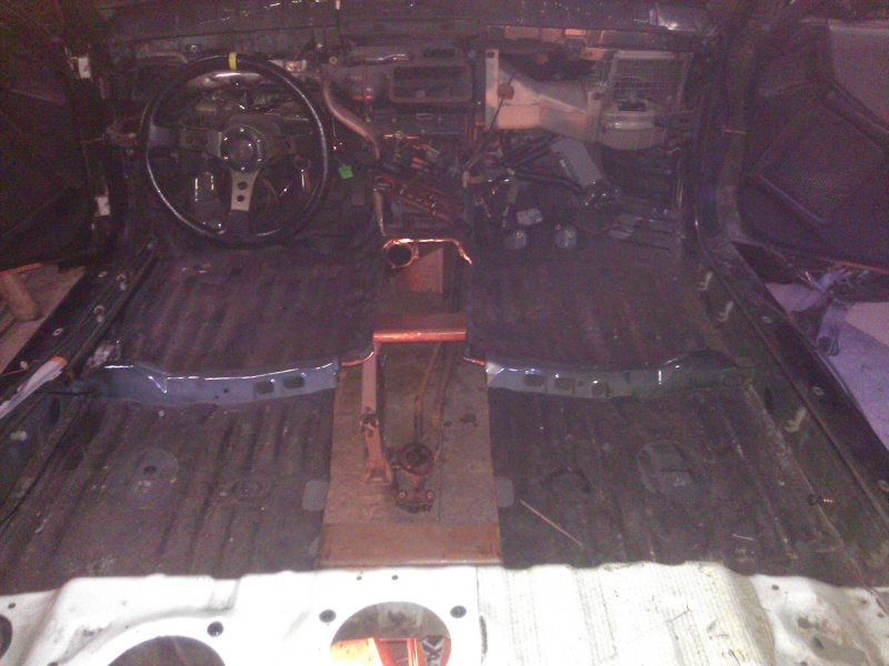

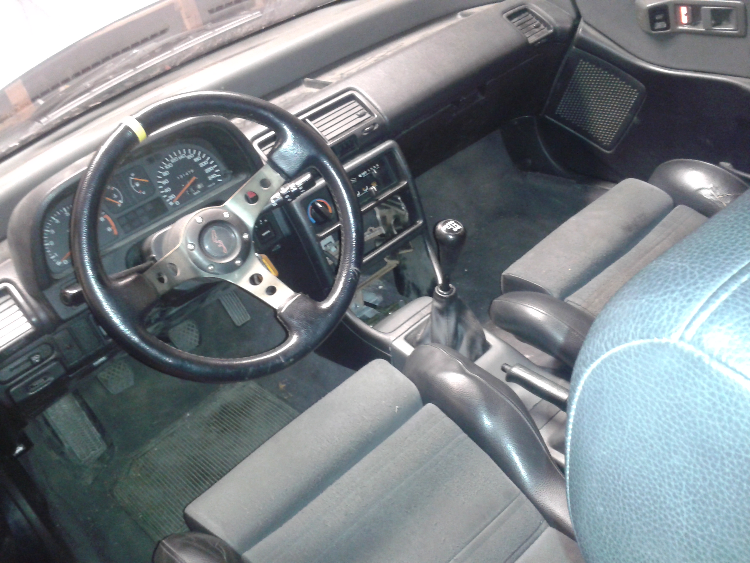

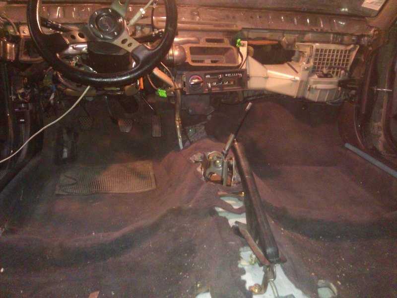

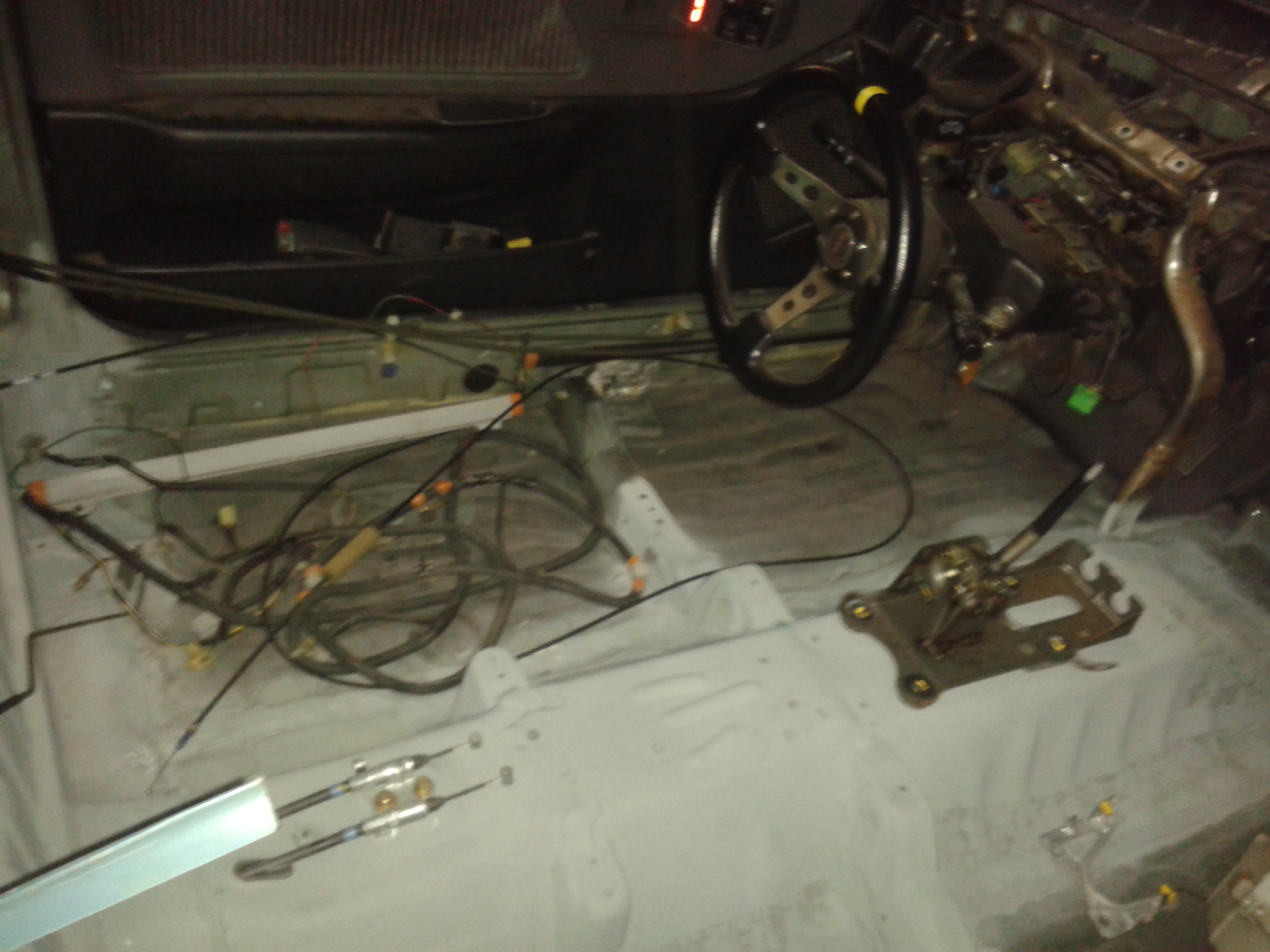

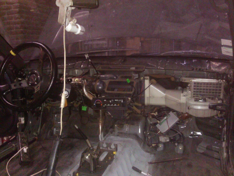

Interior after some cuts:
only thing that looks out of place right now is the brake line.

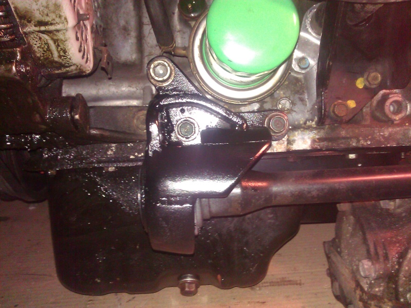

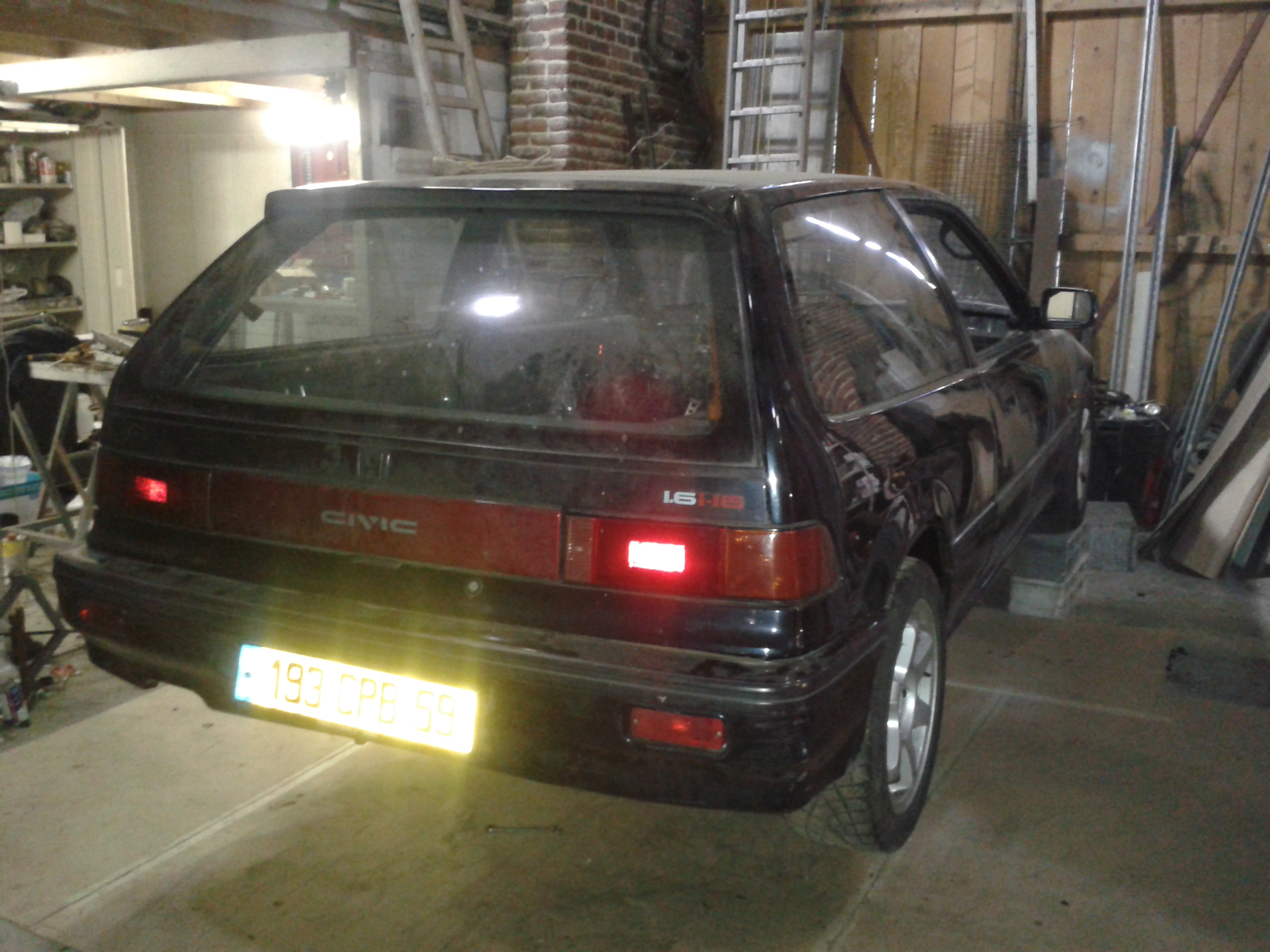

Need some work to be perfect, fuel level sensor doesn't work, some boost cut or something like this, need to install rear diff bushing mod from VIPWryann... I hope i will be able to do a track day in few months!!

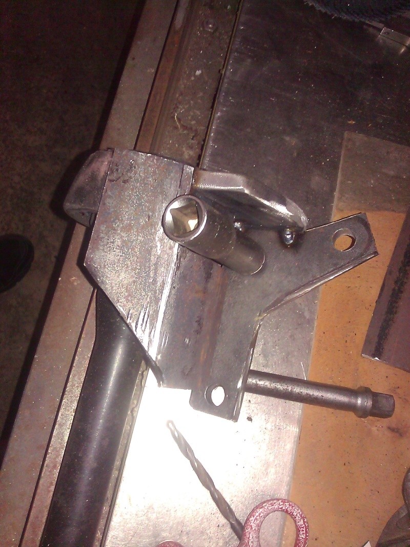

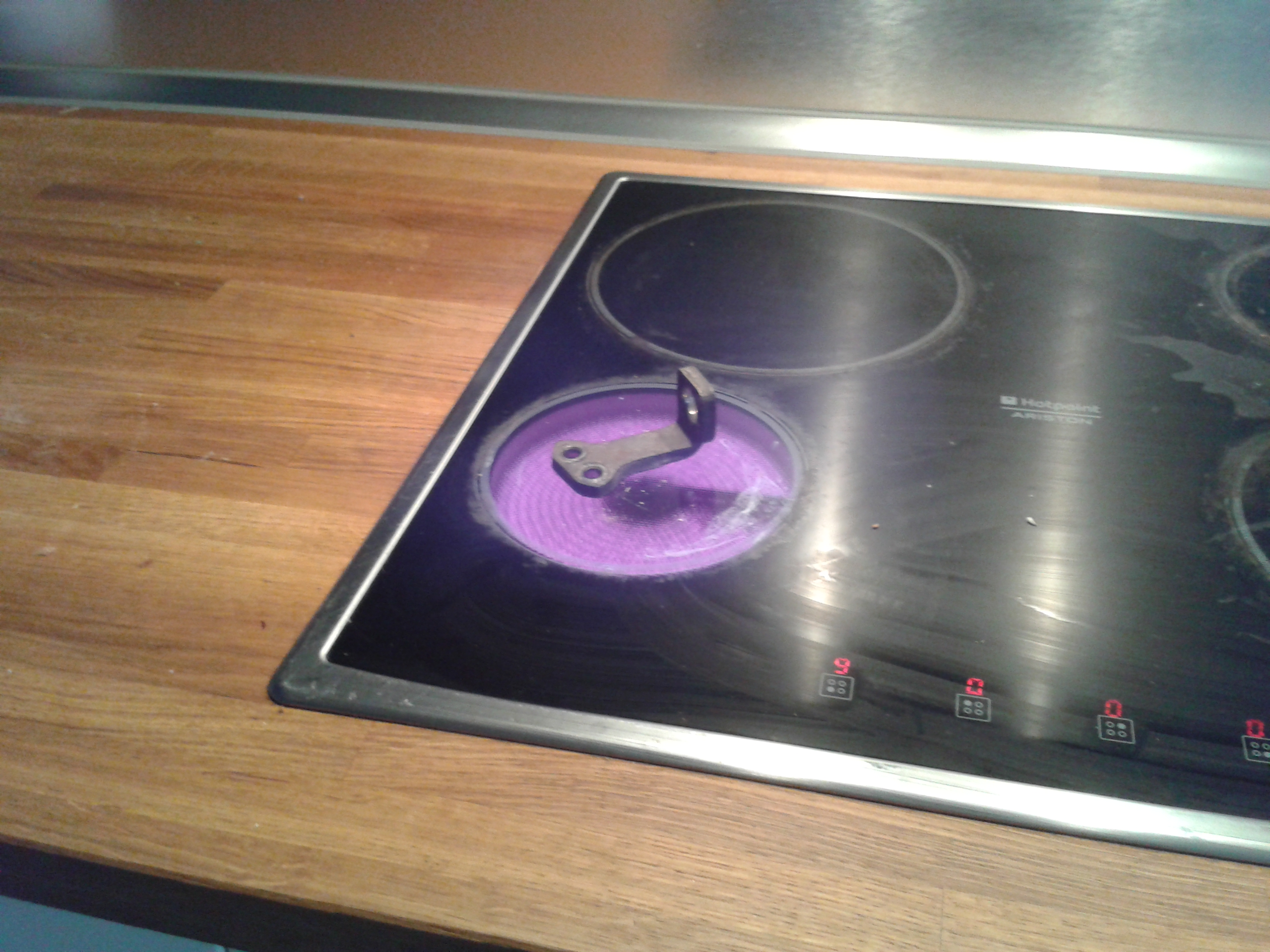

To bend the hand brake bracket
