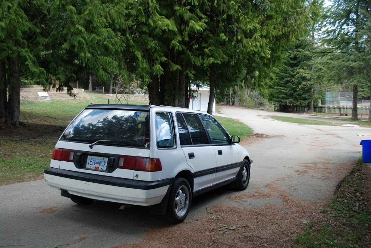

MODS:
Cosmetic:
- nothing, painted bumpers and added the side view mirror. OEM flaps.
- lots of terrible body work, but rust is being held back for the time being.
- rust-o-lium white / tremclad white spray job.
Drivetrain:
- fresh d16a6. was sitting in my friends shipping container for 5 years. it had been rebuild top to bottom for an SCCA car, internals unknown. 10,000kms on engine now.
- crx si transmission. 91 with the bigger bearings.
- new clutch, 10,000kms ago.
- DC 4-2-1 ceramic
- AEM CAI
- new wires/plugs/cap & rotor.
Brakes:
- Russel stainless lines.
- Hawk HPS pads
Suspension:
- Prothane bushings almost everywhere.
- Koni Yellow adjustable's
- ITR springs 250f/ - 140/250r progressive.
- Godspeed rear LCA's
Wheels/Tires:
- Centra Type II's. 14x6 et30. (ugly, but i love the offset and size.)
- Dural SDLA tires
Interior:
- mostly gone. I am a drywall taper/finisher and i haul need to haul a lot of tools. (8' ladder and plank fit perfectly with glove box gone).
other maintenance:
- everything. everything mechanical has been replaced. ball joints, tie-rods, rack bushing, radius arm bushings, rear trailing arm bushings, rear drums hardware and pads, rad.
