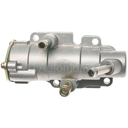

  • DKW 86DKW 86 Band Wagon
    Yes, this is the one for the 1.5L Carb car.

    i never did find the contraption pictured above.. i did change my radiator though from the small to a new large. the small cooled fine till i hit interstate then it would run at about 3/4. once off interstate, even in bumper to bumper traffic it would run bout 1/4. anyway.... after the swap.... no more erratic idle. it idles smooth as silk, so i assume i had a pocket of air in cooling system..
  • tpar1220 wrote: »
    you have a fitv on your throttlebody and a iacv on your intake manifold in the back with coolant lines running to it. if its a carb model im not sure.
