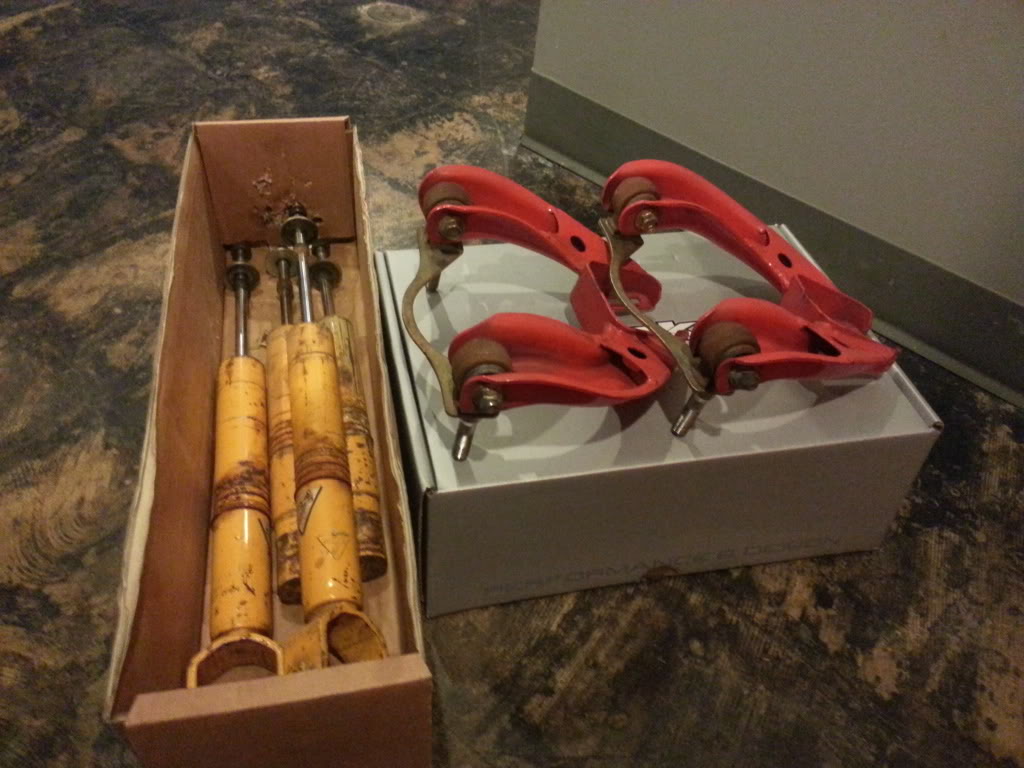

Have these on their way to Koni right now to be shortened and rebuilt for the wagon >

The Konis are the ones Neuspeed sells for their race kits, 5 heights instead of the standard 3 and shortened a touch. They'll still need to be a little shorter to fit on the back of the wagon, though.
