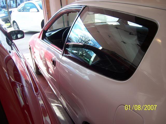

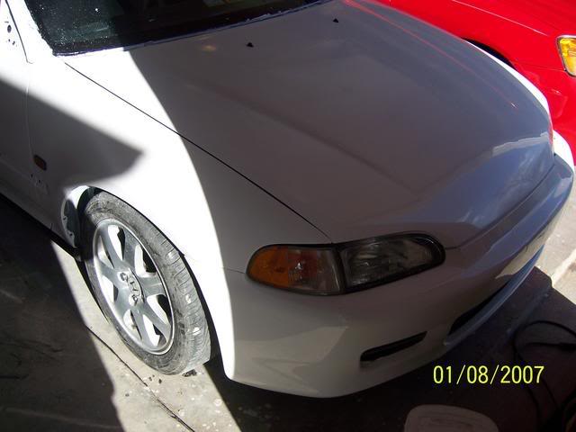

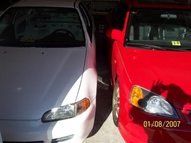

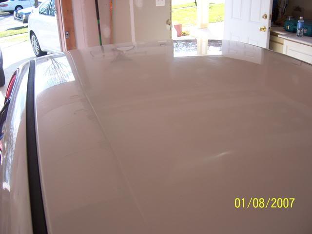

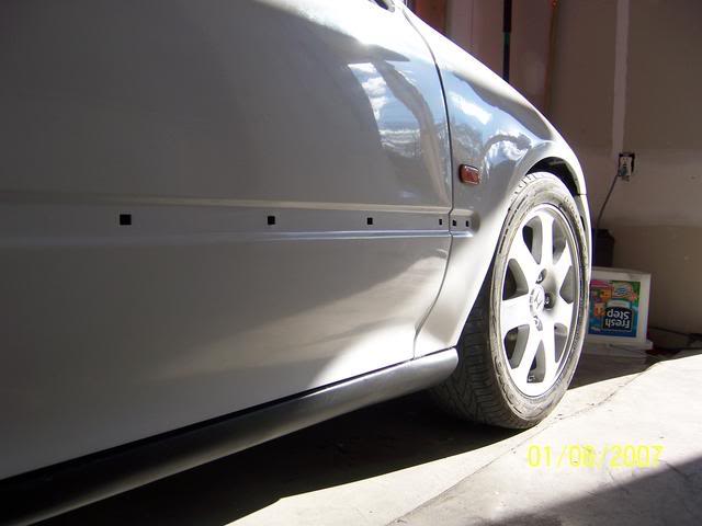

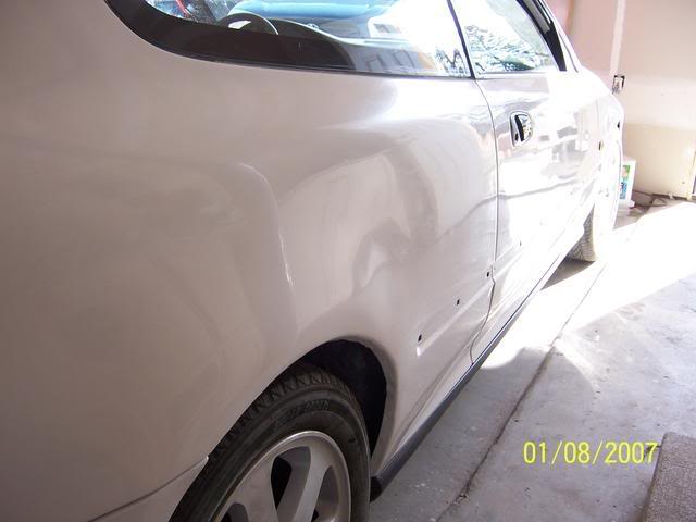

i let it sit for about a week or so before doing the final wetsand and polish. i wetsanded with 1000, 1200, 1500, then 2000.
here's pics of the final polish - i used rubbing compound first, then some cleaner/polishing wax from maguiars. i used a buffer to apply both.
:thumbup: :thumbup: hope you enjoy. IMO, this paint is going to be comparable to an oem paint job, there's barely any orange peel and there's a really nice shine to the paint. after rolling the paint, and spraying it - the only difference is that rolling the paint will lead you to 2-3x more work if you're wetsanding with 800grit in between coats. i recommend you do about 3-4 coats before wetsanding with 800, let the paint sit for about 12hrs to dry completely before doing another coat. if after you do the 3-4 layers and you wetsand you need better coverage, do a couple more layers. the last layer is when you take care of all the orange peel.
