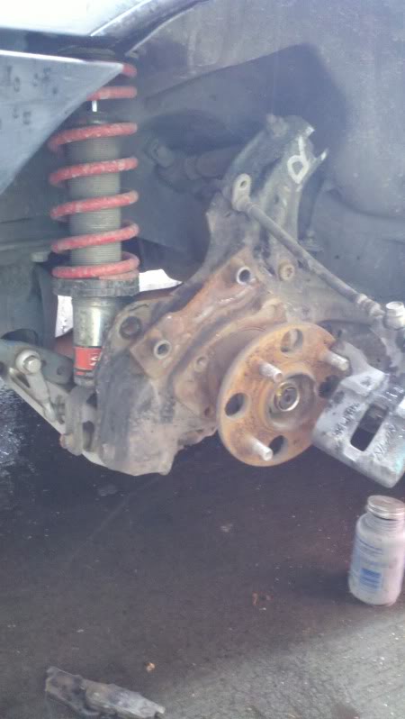

anyhow, i got the 95' integra LS rear trailing arms, everything on it..but had to replace one of the calipers cuz it was sticking..and replaced both discs, pads.
you'll also need a blow torch, hammer, electric saw, welder, and a whole lot of patience. it took me about 5 days to do it. it was not fun.

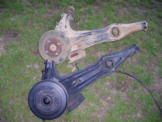

the main problem is that the trailing arms are different on the wagon than on the other civics. the wagon is bigger, wider and slightly longer.
(i have a photo of both of them side by side that i sent a few people on this board before.)
Below:Front Disc
Below:Teg Rear Disc

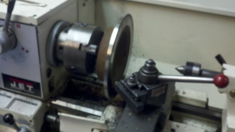

    With a 11'' disc it's & the right adapter it's PNP.The BAD is the added cost of the 11's & caliper adapter. .thatdoodle's used a 10.2''(or10.3'' ITR) disc so it minimizes the arm flange bending.With the right 2/4WD conversion adapter it's not that much work.The 2WD conversion is the simplier design,but require mo parts.
    Si you think the 4wd are easier? I dont think so. Not even with those adapters. But then again I dont know how you would approach it.
    Those adapters are hard to come by. Well at least the ITR spec ones I have; 10.2". Another thing is that the adapters dont just plug and play. They wont line up to the drum holes. By the way ek drums have a different pattern. And that pattern doesnt line up either. Reason being the size of the 4wd spindle its larger than any other civic/teg's.

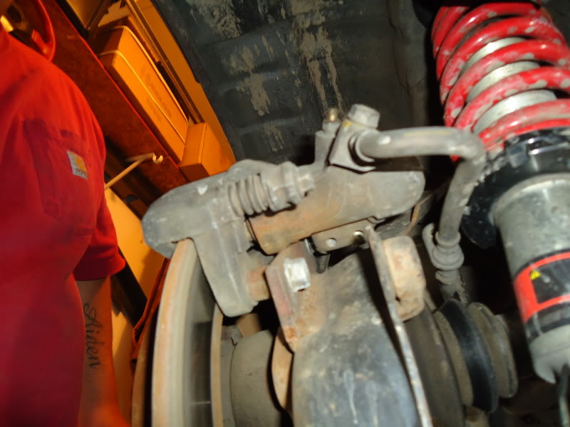

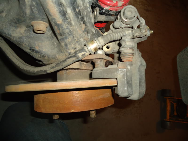

    My 4wd 5 lug disk is almost done and damn was it tricky. I just need to do the fronts. The holidays have left me with no play money.lol
    Are you saying your not happy with my rear disk conversion?
    Where did you see 4wd rear disk?

    It wont work. Wagon trailing arms are longer than any integra or civic. You have to modify the wagon trailing arms and swap the parts over from the integra trailing arm.

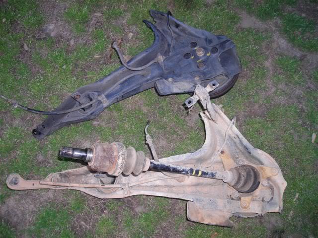

    That wont work either. The RT4wd trailing arms are different.
    Ooops! :oops: I just noticed he said AWD....Thanks Doodle...Nah...That wont work neither...I was refuring to 2wd....
  • So it still wont work if I switch everthing of the ls trailing arms to the wagon trailing arms.
    No. your 4wd trailing arms are different than a 2wd

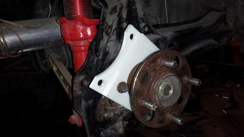

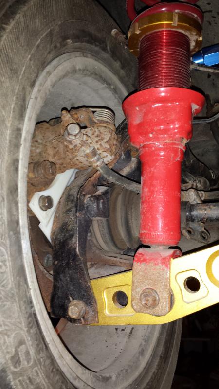

    Some updated links for RT4wd rear disc conversions would be thuper!
  • BrakeExpertBrakeExpert New Wagonist
    Not to get everyone's hopes up, but bam bam is getting some extra parts, of which a pair of RT rear trailing arms will be lent to me. Then I can get started playing with metal, maybe I can mill some type of adapter. I've got ideas, so I'm figuring how to go about it. I'll do my best!
