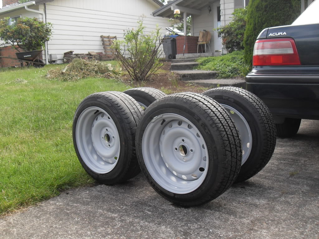

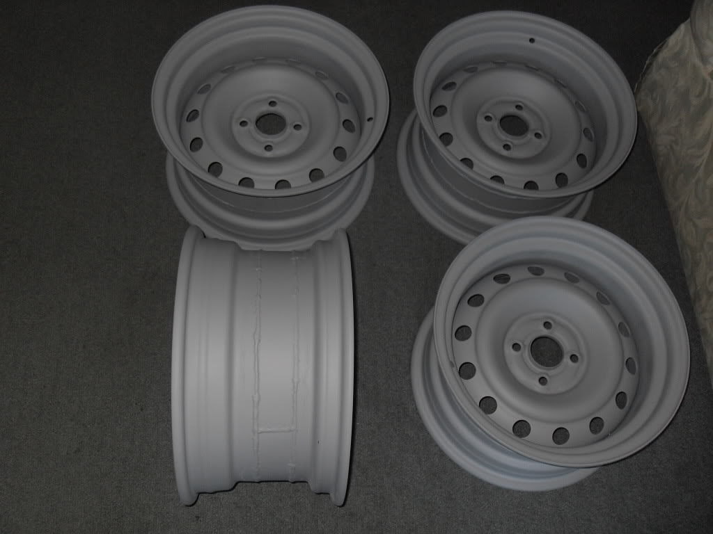

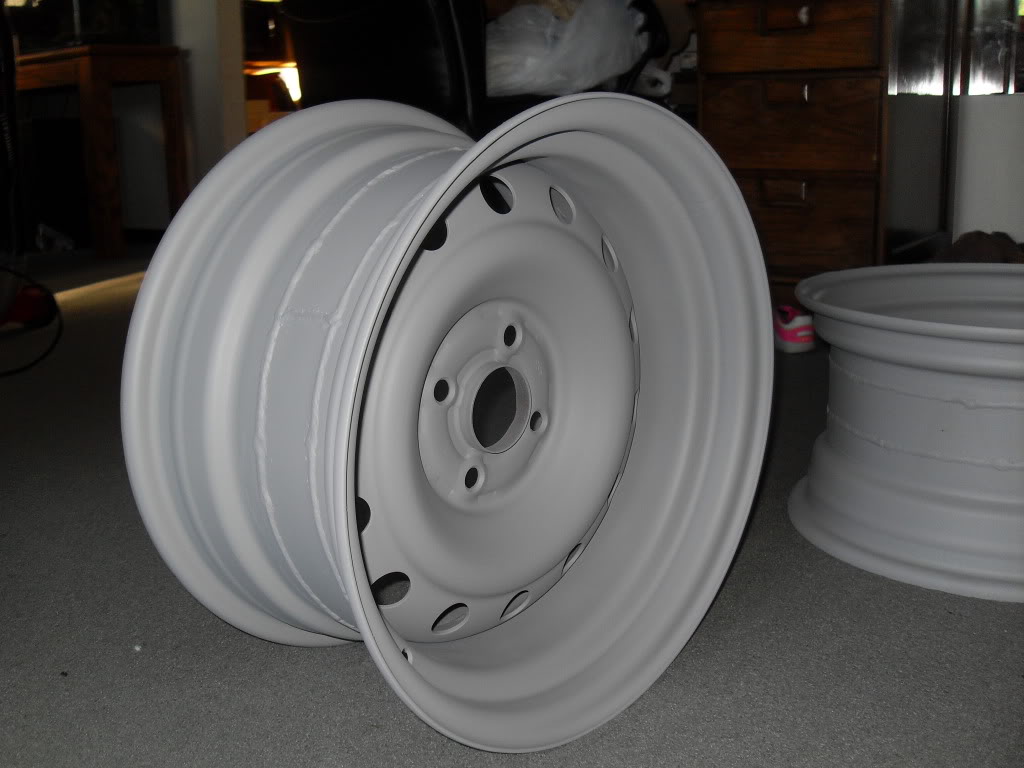

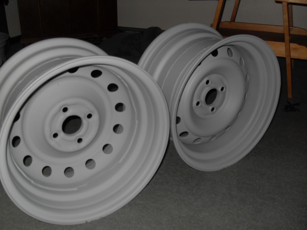

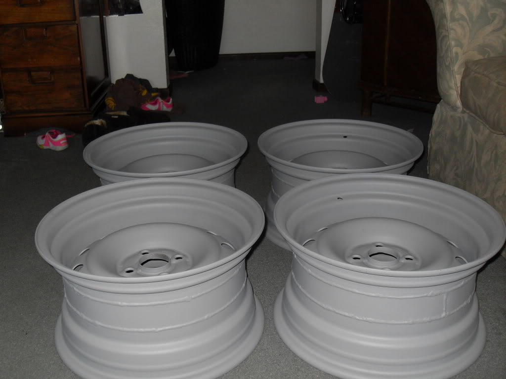

So I haven't posted on here in a while. I sold my wagon a while back and still kicking my self in the ass for it. I snoop around from time to time. I started a new project and just curious how interested people are in banded steelies. I'm almost done with my first set they are 15x8 4x100 et+10. I'm capable of doing any size any offset and any lug pattern. I live in Vancouver Wa. just north of portland. let me know what you think of banded steelies/widened steelies.

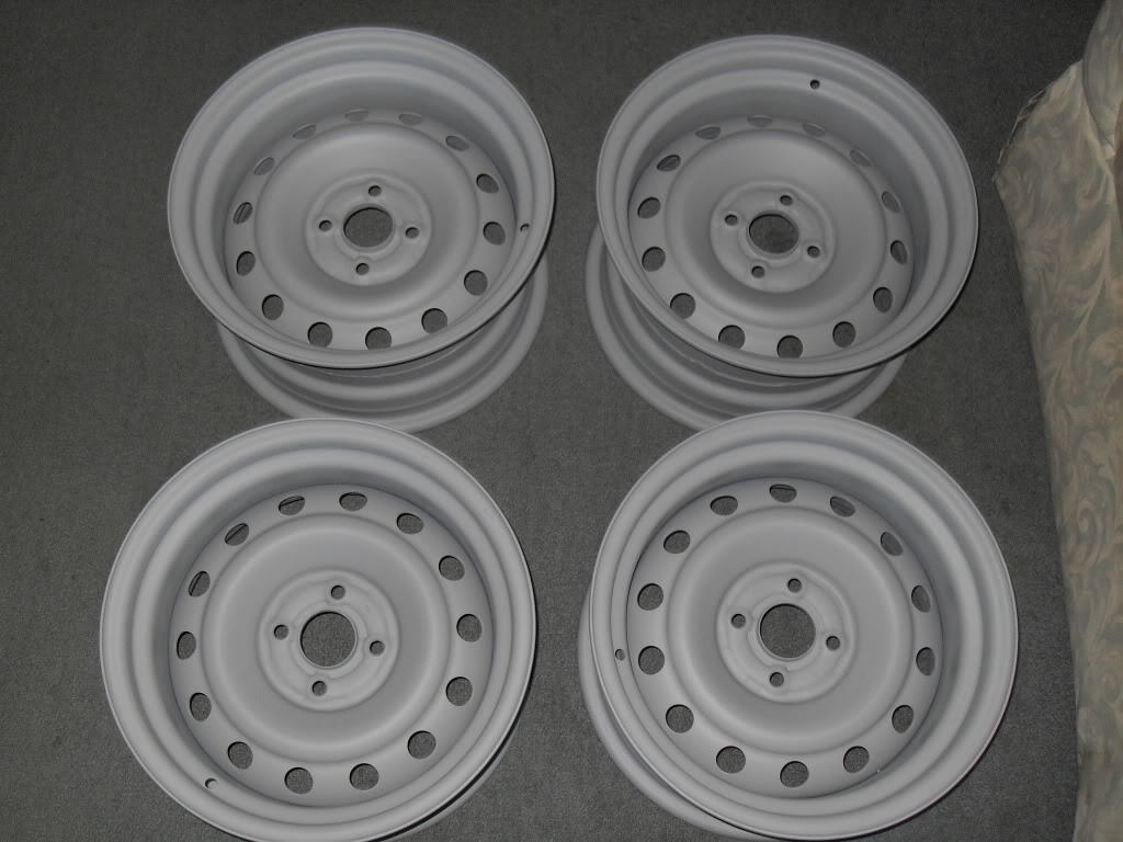

One stock and one banded not painted yet need to clean more before paint.

are you starting with a 15" wheel?
Yes I bought 4 4x100 15x6 steelies cut them and added 2 inches now they are 4x100 15x8 with a +10 offset. I finished them today so now I need to get tires and see if they balance and hold air.

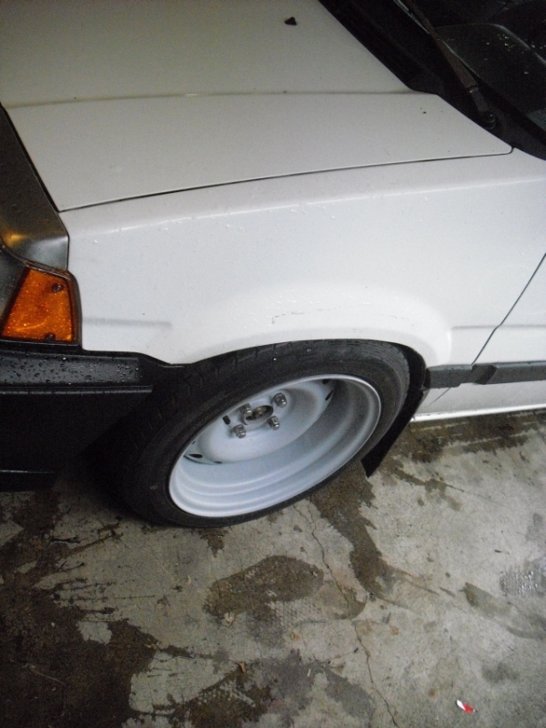

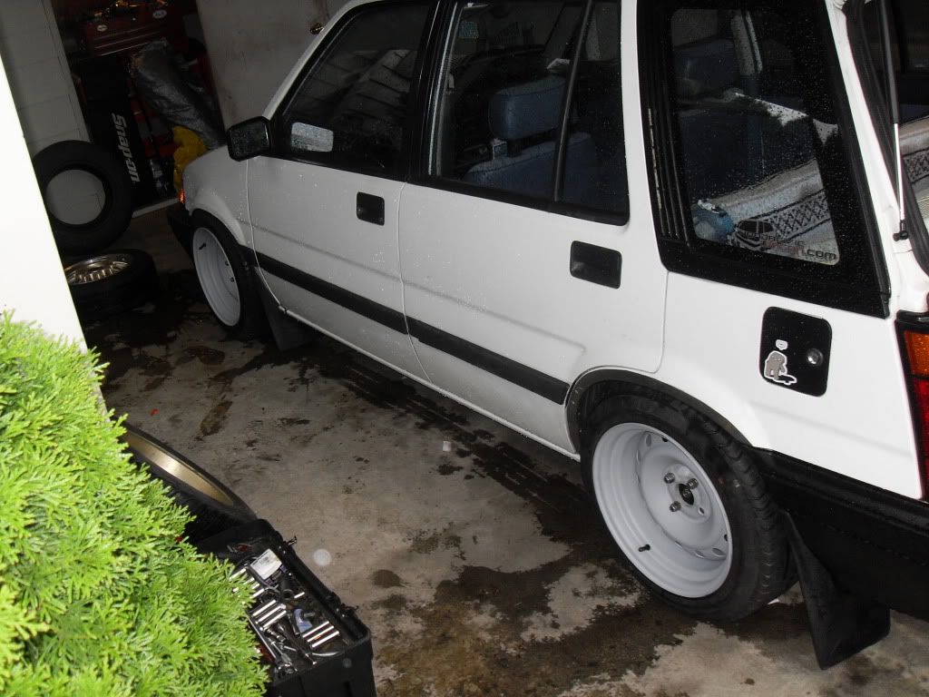

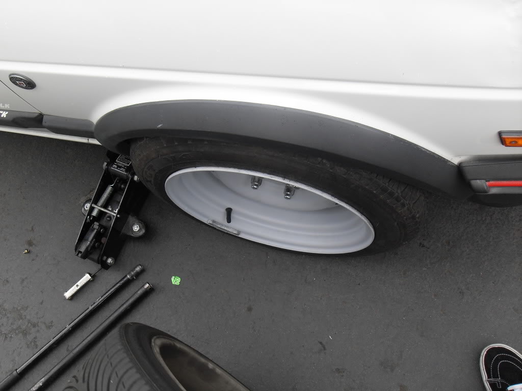

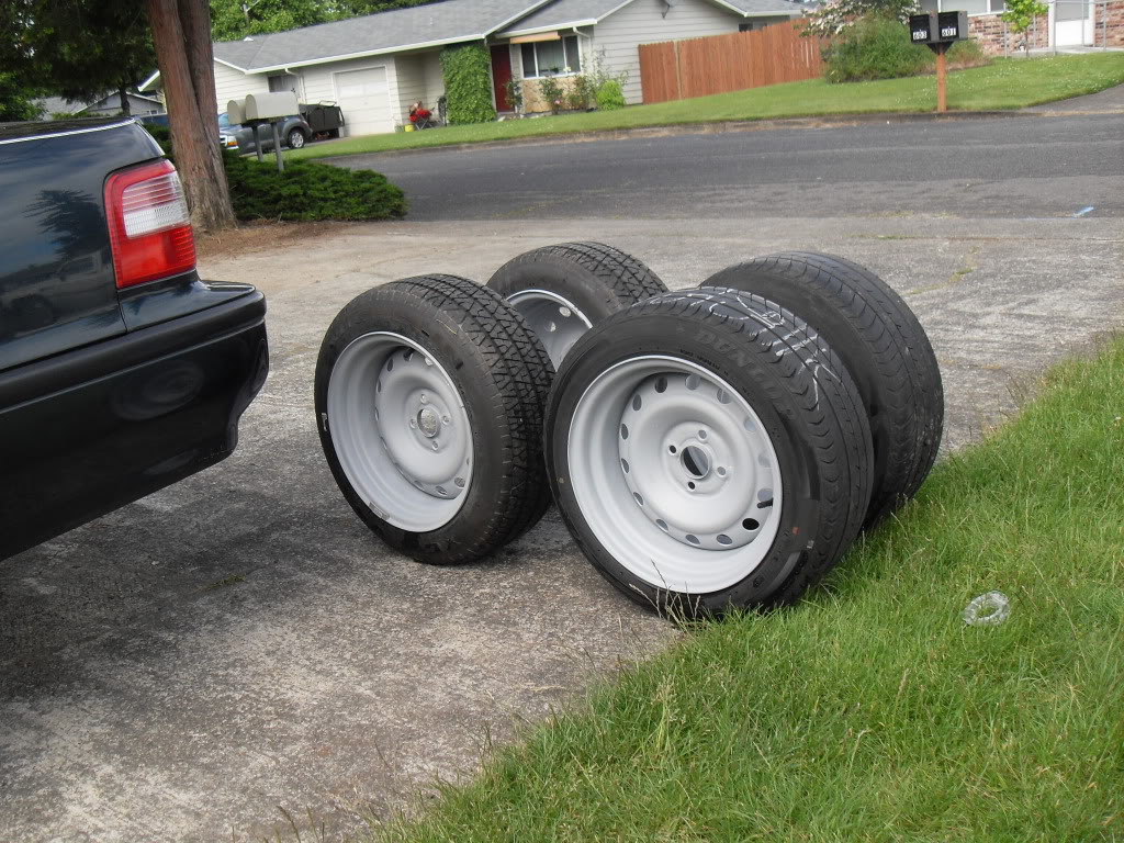

left is back right is front

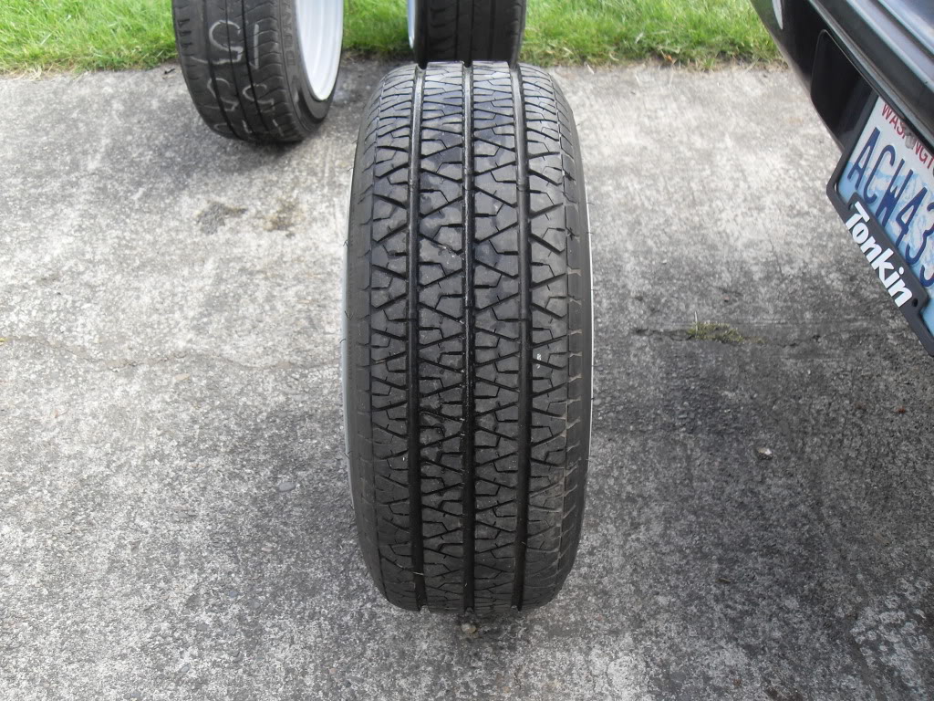

Not bad small stretch. I would like 195/45/15

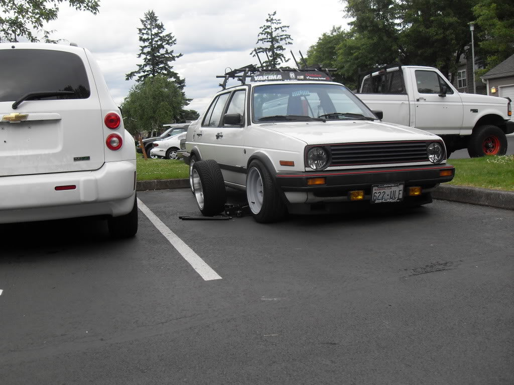

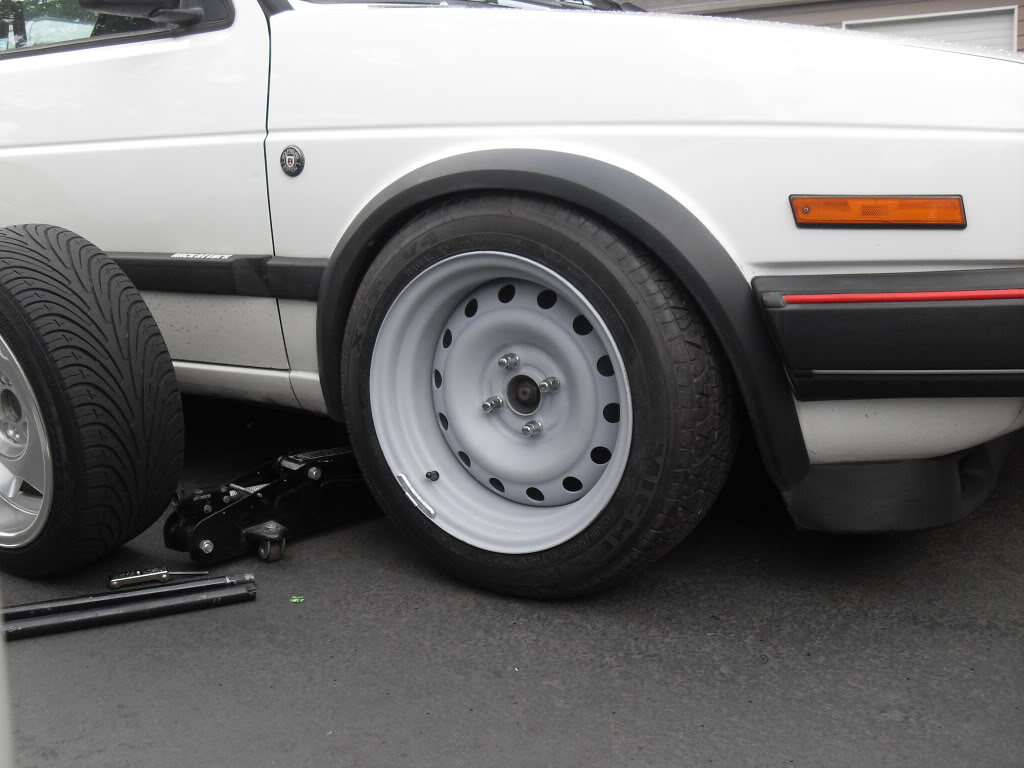

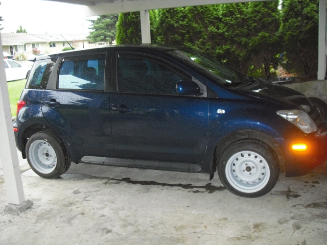

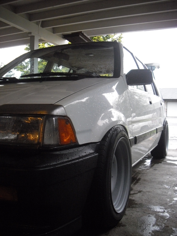

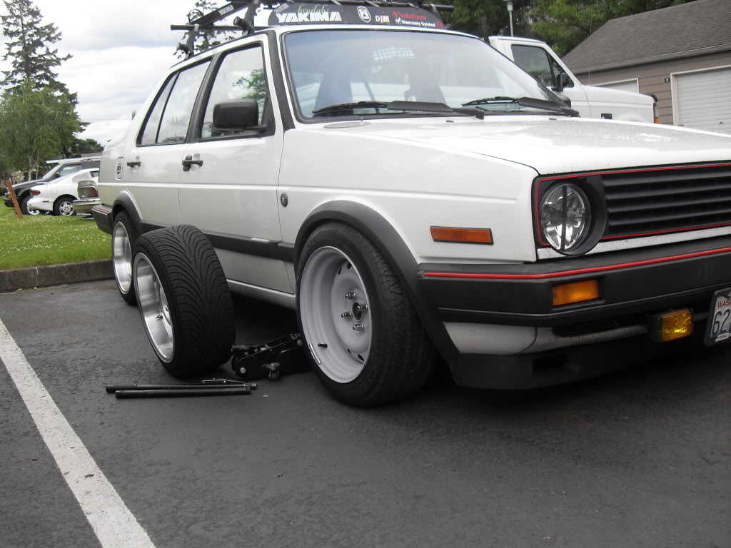

So they look good on steve's wagon but we weren't able to go anywhere they dont fit 3rd gen without a little modification. He went and got his girls scion XA (also 4x100) we put them on it. My wife followed us to see if there was any crazy wobble or anything that seemed unsafe. We also felt no shake or any thing that was off while driving the XA. I did not take pics of them on XA but steve did and he should have them up soon.

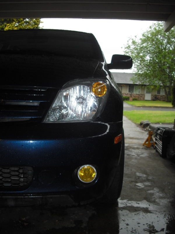

And my wifes Scion... she needs more lows :P
