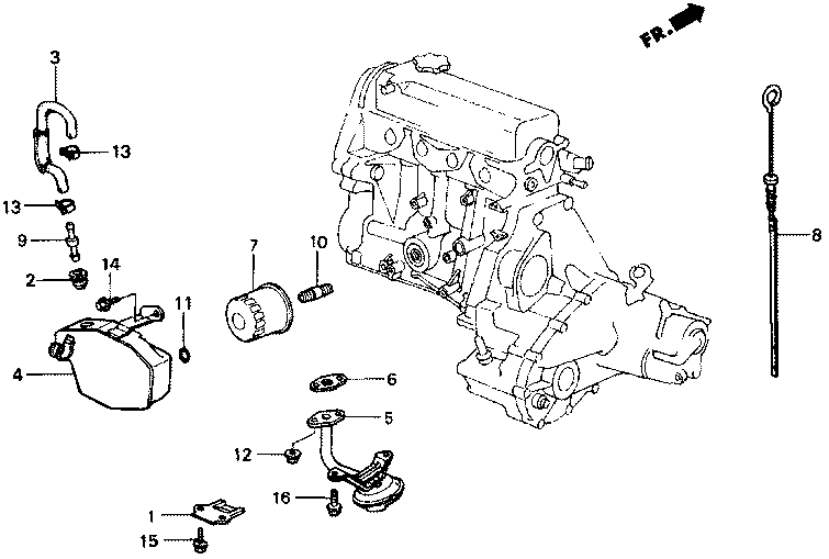

I've been trying to find the PCV valve on my 87 rt4wd, but have been unsuccessful in my attempts. If anyone could find a diagram or picture as to where it's located on the back of the engine, I'll be greatly appreciated. Thanks
Part #9 in the diagram. It attaches right to the breather box on the back of the block by the oil filter. It shows being "unavailable" though so might try an auto parts store. From what I can tell, it looks like the same style PCV valve as the 86-89 Integras so that might give you more options if looking for a replacement part.
