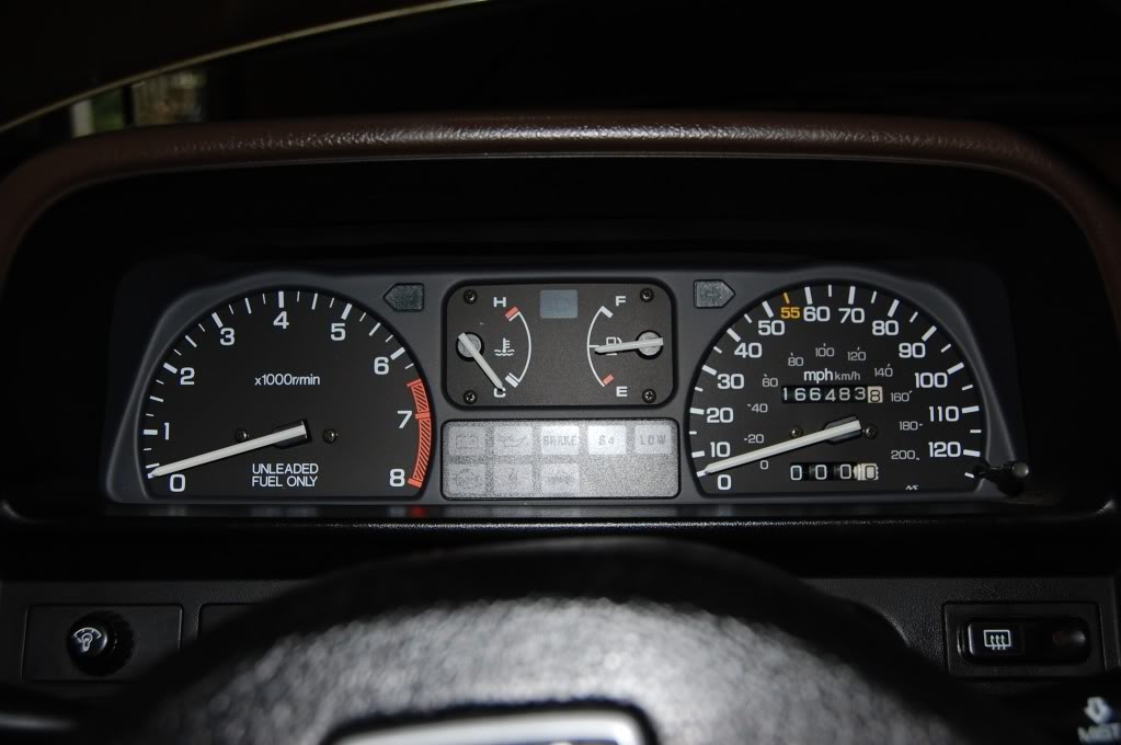

    It is glued on pretty good. You can heat the glue and try to pry it off. Mine was cracked when I got it and a crack would never do. I preyed mine off but it broke in like three pieces. I tried some others in the junkyard, most of them broke. I ended up rocking mine with no cover. The gauges never looked better. Just have to be careful not to damages when cleaning etc.
    Before:
    After:
