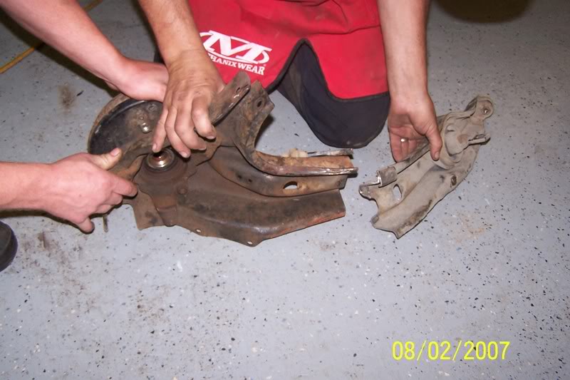

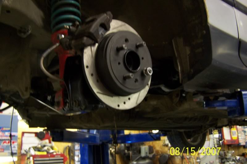

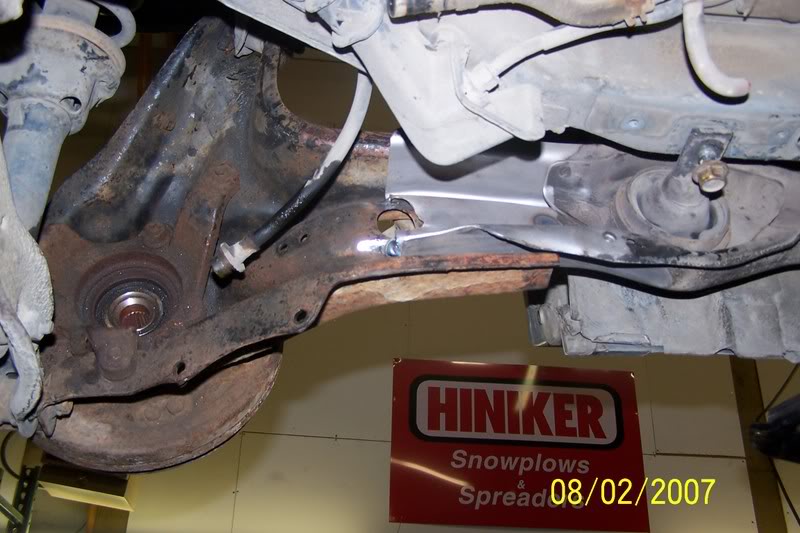

    yeah thats gotta be all my old swap parts. I didnt buy it cuz i knew it was just gunna be a money pit AGAIN.... that isnt my old car just my old set-up. my buddy and I built the trailing arms and did the brake swap on her. heres some build pics...
    And for fun i ran it RWD one day. it was super scetchy when the car was turbo'd i came around a corner on the throttle and it just about whipped me around and into a tree... thats what ya get with a super super short wheel based turbo car...
