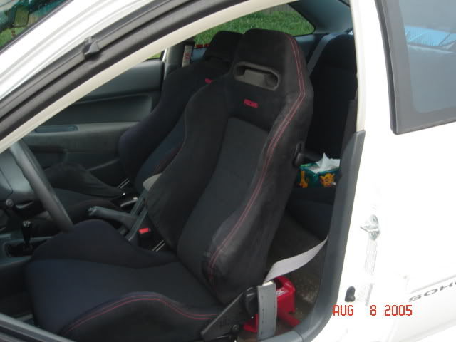

  • how bout this seats on the wagon? would this fit? im using it on my coupe right now using the stock ITR railings (can only bolt 3) would there be a lot of work to be done?
  • duckie8310duckie8310 Senior Wagonist
    hmm...you can pretty much make any seat fit with modifications. one guy made a completely new frame to fit his new buckets. others (including me) just mod the whole dang thing.
