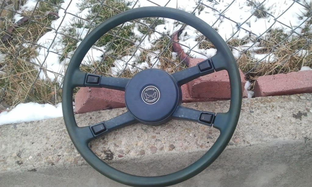

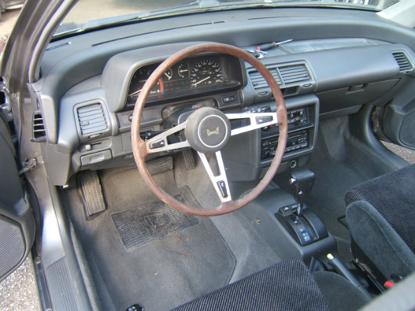

So first off big ups to billboard for spawning this idea in my brain. After I saw his restoration of an OG Honda steering wheel I went on a hunt. And look what I found
Now I plan on restoring all of them and keeping one for myself. I figure I'll throw up how I did it and if anyone shows interest in one of the other two I'd make a sale ad over in the market place.

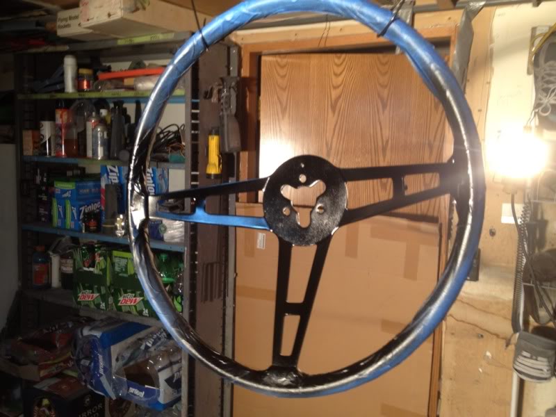

First step is take it completely apart, sand down to bare metal, and mask.
Then I cleane it with wax/grease remover and sprayed metal etch primer.
And then a bit of regular primer to fill any minor imperfections.
That's where I am right now. I have not decided what color I want to paint it yet. I'll figure that out later. Feel free to ask questions and such. If you're interested in purchasing a finished one from me let me know and I'll make a for sale thread so nobody gets angry for selling things out of a regular thread.

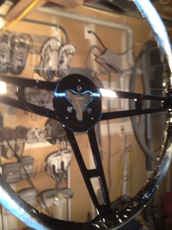

anyways, i got one completely done and its just drying right now. i decided to go with gloss black because it was easiest and quickest for me. I spent about four hours on this first one doing the restore. Everythign is cleaned up except the center pad piece. I will clean that up tomorrow and hopefully have time to get it all put back together and get started on the other two.

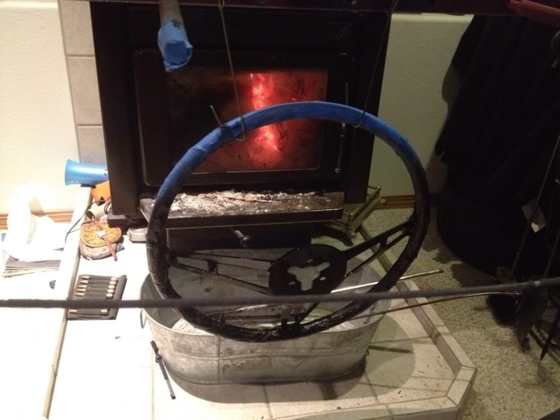

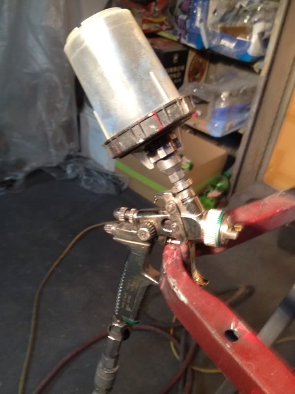

For the current updates, i Decided to go with just straight black for this one. Unlike most i dont like to use spray paint at all. Im a painter and i try to use automotive paint whenever possible. I think it gives you a better finish in the end.
Mixed up some clear and sprayed it on.
sorry for the garbage pictures, they're just my iphone shots. once its done and put back together i'll break out the D300s and get some good shots. What do you do when you dont have a booth to bake your clear coat? You hang it in front of the woodstove for the night

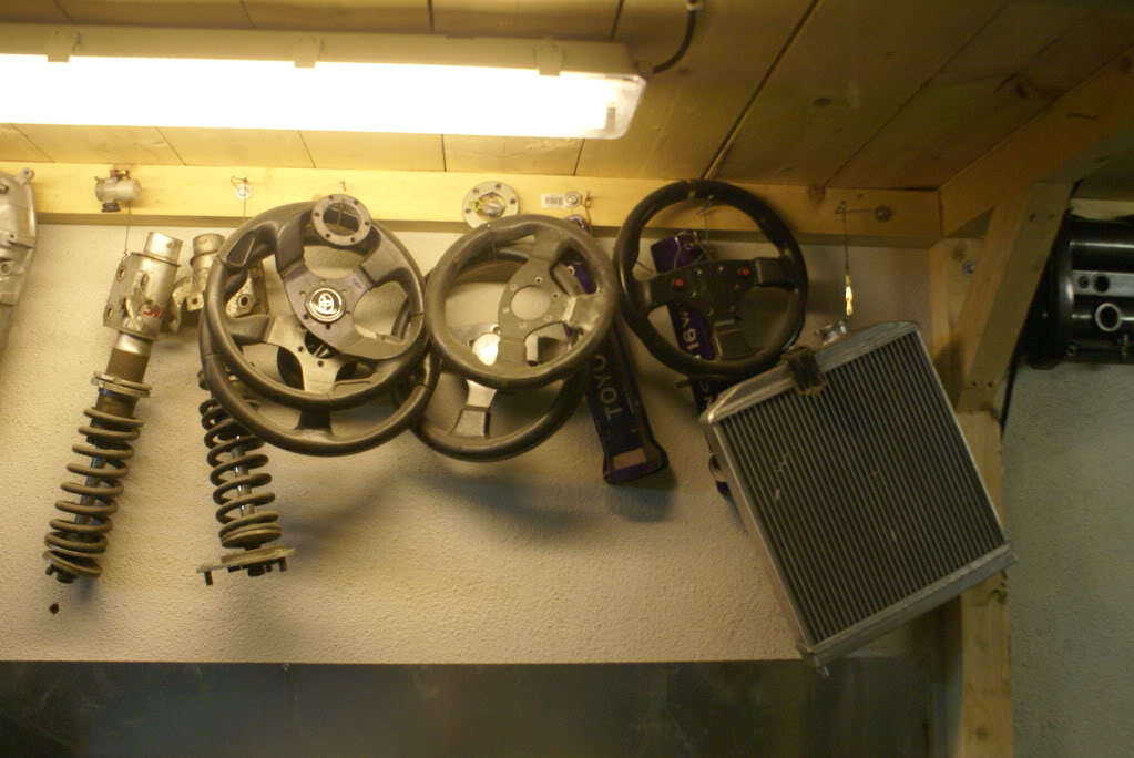

Pix or it doesn't exist
he has a compulsive disorder or some crap .....
take a day or 2 and go thru his posts some of the stuff he has is amazing ...
i swear he has more sets of rims than scrappy has mitch matched colors and parts ..
and half as many steering wheels..
