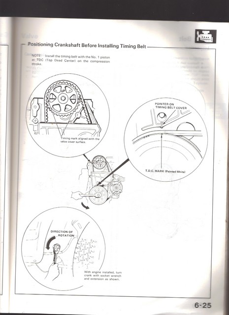

Im about to tackle the job of changing the timing belt, water pump, and belt tensioner on my wagon. I have changed the timing belt on my brothers 1992 civic hatch. The only thing that is stumping me is how to get TDC because this d-series engine is a 12 valve and the spark plugs are horizontal and now vertical. Can I just undo the #1 spark plug and stick something in there to check for TDC like the other d series engines?
If the belt is still intact, just replace the belt without moving anything!
