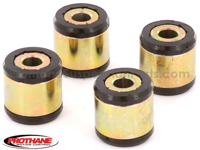

    Those are the bushings for the two outer pivots. Prothane uses steel shells sometimes just like the oem one's.

  • Those Prothane parts are actually for the toe control link at the front of the rear trailing arm (compensator arm). Energy suspension don't make a bushing for that location.
    Part #7 from this pic:
