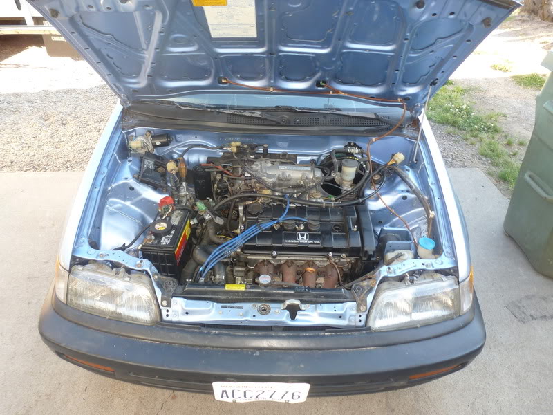

Depinned orange c1 & moved to b10
Depinned white c2 & moved to b12
Ran c1 to blue/green dizzy wire
Ran c2 to blue/yellow dizzy wire
Matched up the rest aside from the fat white wire (ignitor) which went to the yellow/green wire
Twisted everything at first to make sure it worked, and it did. So then I took the time to solder/heatshrink eveything and it fired up again. Drove it, parked it, now no spark...

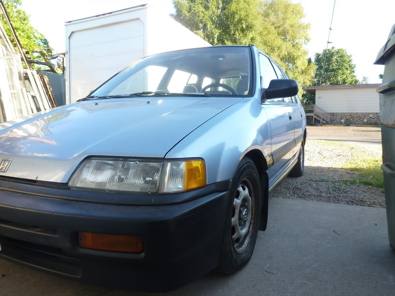

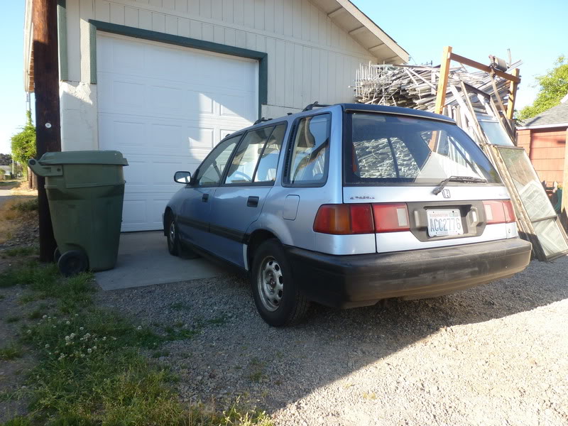

Here's some pics if anyone's interested, btw it hasn't been cleaned up in months.
