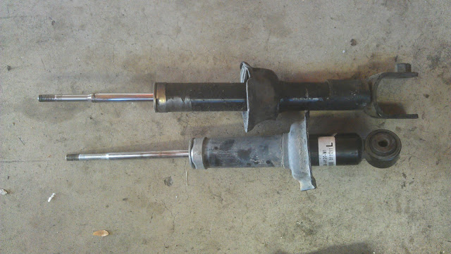

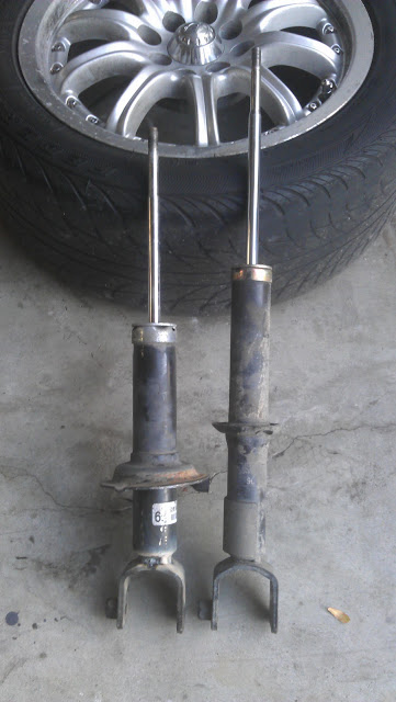

    I found a shorter oem strut, but it needs a little modding. I currently just installed a set of 2003 (I think) rear struts. I had to cut off the eyelet on the bottom of them and weld on a fork so they would work with a my stock lower control arms. I rides much smoother in the back now. I'm also running 1.5" tophats in the rear with the 03 civic struts.
    Pic below is stock for stock of the rear struts before any modification:
    Pic below is after cutting the eyelet off and welding on a fork from a blown da teg rear strut:

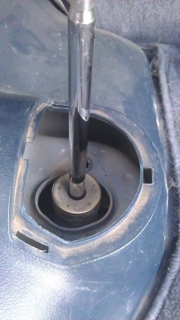

    Below is a picture of the stock strut with no spring installed. I wanted to see how far the suspension would go down before the tire bottomed out in the wheel well. The stock strut goes through the frame by about a half inch. This is why my car kept bottoming out in the back easily.

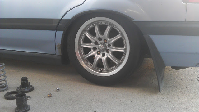

    This is a picture of as low as the wagon can go on 205/50-15's:
