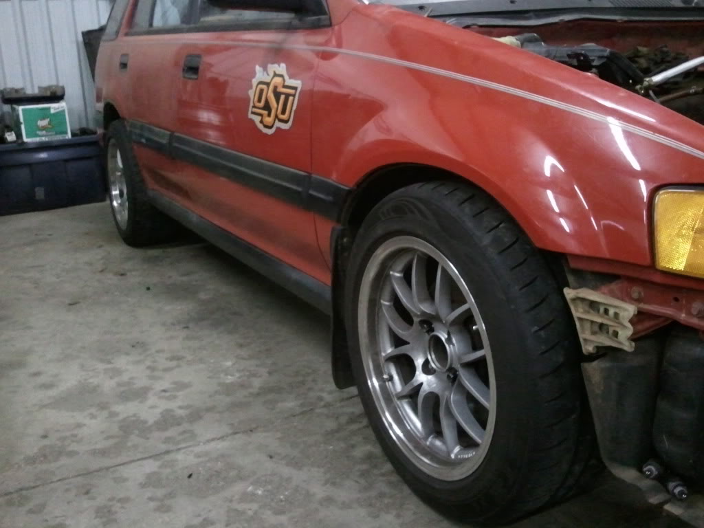

anybody ever run anything like this? for reference, here are a couple photos of an EF with 15x9s up front (15x8 et36 rears). i cannot tell if he had any issues, he doesnt say but some people with EG and up say that there might be clearance issues with the UCA, requiring spacers.

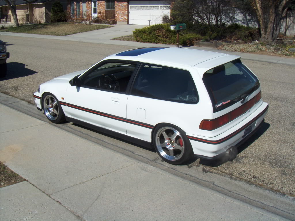

Unless hes running SiR spindals. I run 16x8 w/40 offset on my white hatch with no issues, but any other DA or EF spindal (my other cars), I have to use a 1/4" (ish) spacer with this wheel/tire combo.
Tires are either 215-40-16 v710's, or 205-45-16 R6's. Cant remember which tires, but the Hoosiers were almost a half inch wider than the Kuhmos and fit with no problems.

Nope no need, and it seems like youll hit the trailing arm well before you hit the uca. Next time I have them on the car, Ill get a pic or at least give it a good look. On Maui right now, but Im getting those 16x8's mounted up with street tires when I get home early next week.
