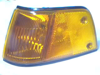

DYI:orange corners...
Sanded down my corners i painted black: :?
Then, i sprayed the entire corners with krylon
stainded glass orange paint (which is a PITA to find):
Baked them: (10 min at 200 degrees)
Finally: cupow-
Finally: cupow-

I tested it on a spare 88-89 wagon corner light I had lying around and it looks good.
You will notice that the right hand side of the corner light still has the original amber color while the middle and left of the corner light show the Glass Coating color.
