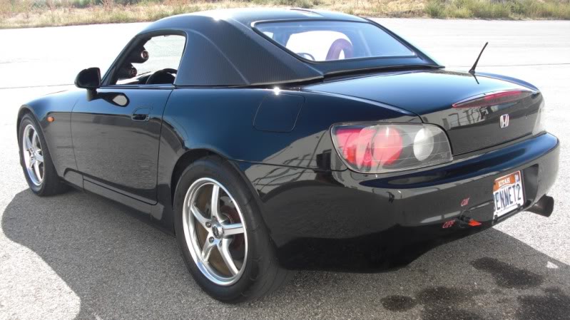

    In our crew we have some pretty ridiculous cars and all of them run K&N and Mobile1. These cars include a 760whp S2K, 620whp Integra, 560hp 240sx... many more, we all stick with the best quality and usually means most cost but do you really want to take the chance with your motor? I gladely spend $8+ on a filter if it means my high performance car isn't having metal shaving get to the combustion chamber or bearings. I did a write up on my car clubs
    Completely off-topic, but was this black with a hardtop and ran E85, just traded it for a built white EG on E85 from Utah?
    If so, I work down the street from the guy, and bought the 1600cc injectors from that same car for my Starion. :mrgreen:
