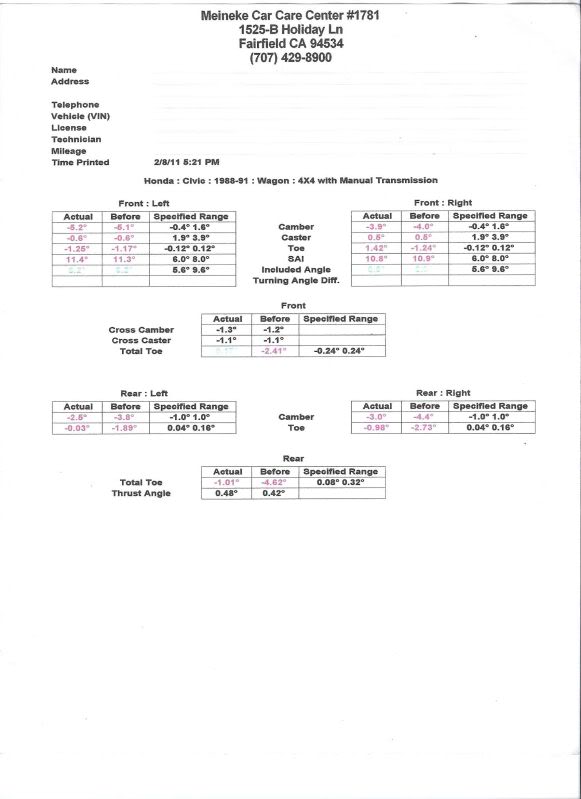

i recently got into a little accident slid into a curb and ****ed my allignment up something crucial. so after i got my car looking better i took her in for an allignment they did wonders to the rear suspension but the front is still a little off it has a little push from the oppisite end im turning into and when i turn the wheel more than 3/4 of a turn left or right the steering wheel will lock up to the left or the right and i can actually just let go of my steering wheel and it will just go in circles not sending the steeringwheel back to the centered position..

heres the before specs -_- they didnt give me the after spec
innovative offers caster adjusting bushings to my knowledge so far that ive gathered i just need a bigger outter bushing and a smaller inner bushing to push the caster more positive..
maybe just getting a innovative cross member will be a better choice.. adjustable radius arms..
I wasn't aware of that. Makes sense, though.
BUT... if it was ok before, then not ok after the accident, something's bent.
The front crossmember is interchangeable between 88-91 Civics. Sounds like it might be time to add traction bars since you are already going to be replacing it anyway.
subframe, steering rack, lcas, radius arms, cross member im going to pick and pull to see how much it is after i get my tax return im going to do a hefty write up here
