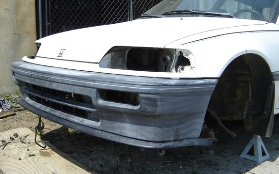

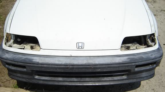

I just tried this out today, works pretty well in my opinion. There is enough plastic left on the ends to cut a little off and then wrap it around the corner with the heat gun to make it look clean. The only modification I had to make so far was to cut the little fins off of the top of the bumper filler so it would sit flush with the bumper (if you go look at yours you will see what I mean). I still need to go at it with a heat gun, maybe readjust some of the screws a little, and maybe add a few more here and there. I just used a little fastener kit from Harbor Freight, screwed right through both pieces of plastic with the biggest screws in the pack with just a screwdriver, not too hard I just used 4 screws. A drill would be much easier though....
I need to cut a little more plastic off of the bumper filler on the side here to make it sit flush, and wrap the end around 90 deg with a heat gun.
