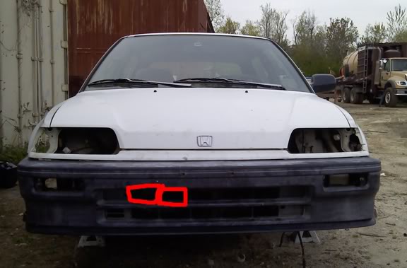

So here is what I did.
1. Take out the outside screws on the bumper lights and slip them out of the bumper, remove the bulbs and push them back through the holes in the bumper where the lenses were.
2. Take out the phillips head screws on the very ends of the bumper, they face towards the rear of the car.
3. Looking through the hole where the bumper light was, you will see two 10mm bolts. Use a 10mm socket and long extension to remove the two bolts from each side of the car, four all together.
4. Then all you have to do to remove the bumper is pull the side of the bumper at the wheel well away from the car to unhook it from it's little mounting clip. Do this on both sides and the bumper will come right off. It's definitely easier with two people. If you don't have someone to help, use something to support the unhooked side of the bumper while you undo the other side.

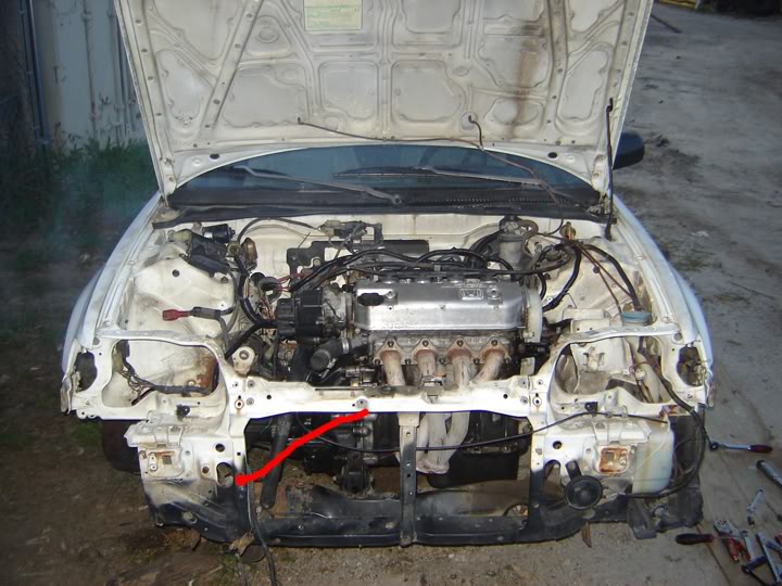

5. Now you can use a flashlight to inspect the latch mechanism. Looking at it from the passengers side of the front of the car, you should be able to see a small square tab with a hole in the middle, and a slit in the side (so the cable can get into the latch). You can use a flathead screwdriver to pry (carefully, but it does take a little force) the latch towards the passenger side of the car, releasing the hood.
6. If you can figure out how to fix the problem, awesome! I could not, so I took some nylon string and wrapped three strands between the hole in the latch, and a hole in the radiator support on the passenger's side. You can see approx where on the picture below. So now I can release the hood by pulling on the nylon cord through the holes shown below in the front bumper.
I would suggest pulling the string as a release a few times before putting the bumper on, it is a bit hard to do and you should know what to expect. You can't just reach through the bumper and yank the string real quick. You will need to use both hands and pull as perpendicularly as possible to the latch (parallel to the ground, pulling towards the passenger side of the car). It's still kind of a bitch, but now I can release the hood without having to go into the cabin.
