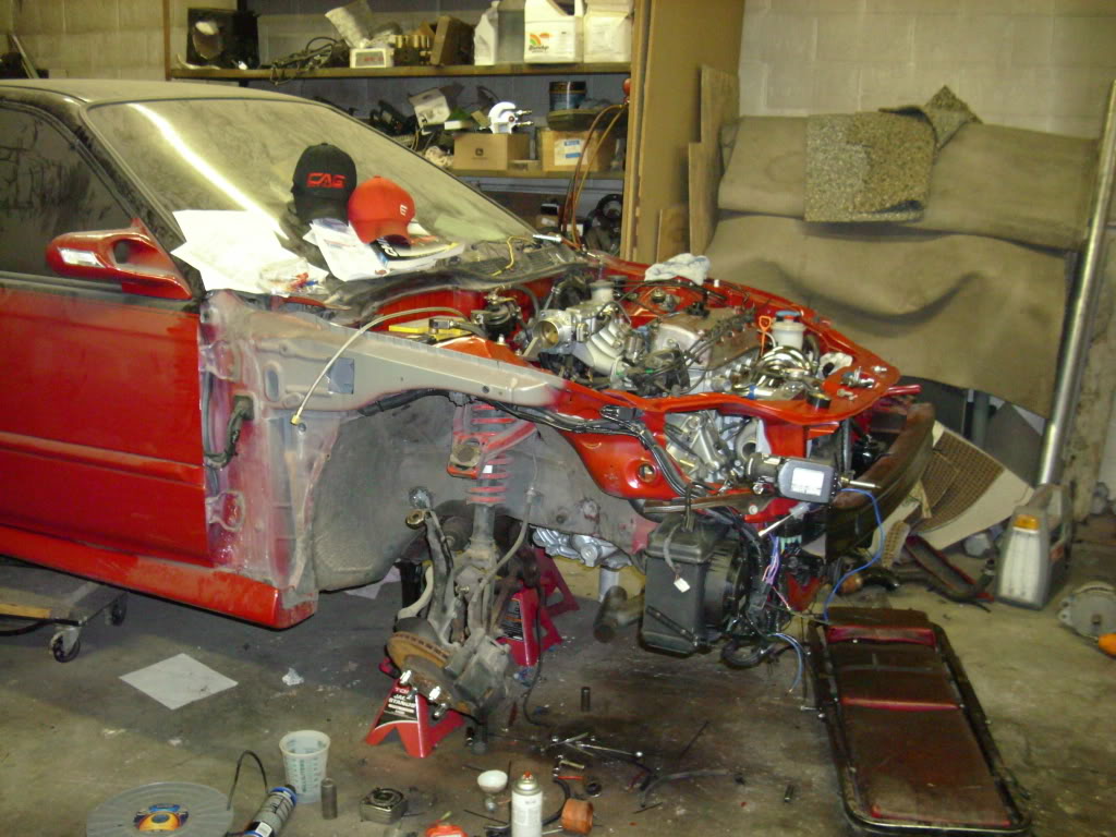

I did a dsm t25 for quick spooling action. 11lbs...soft

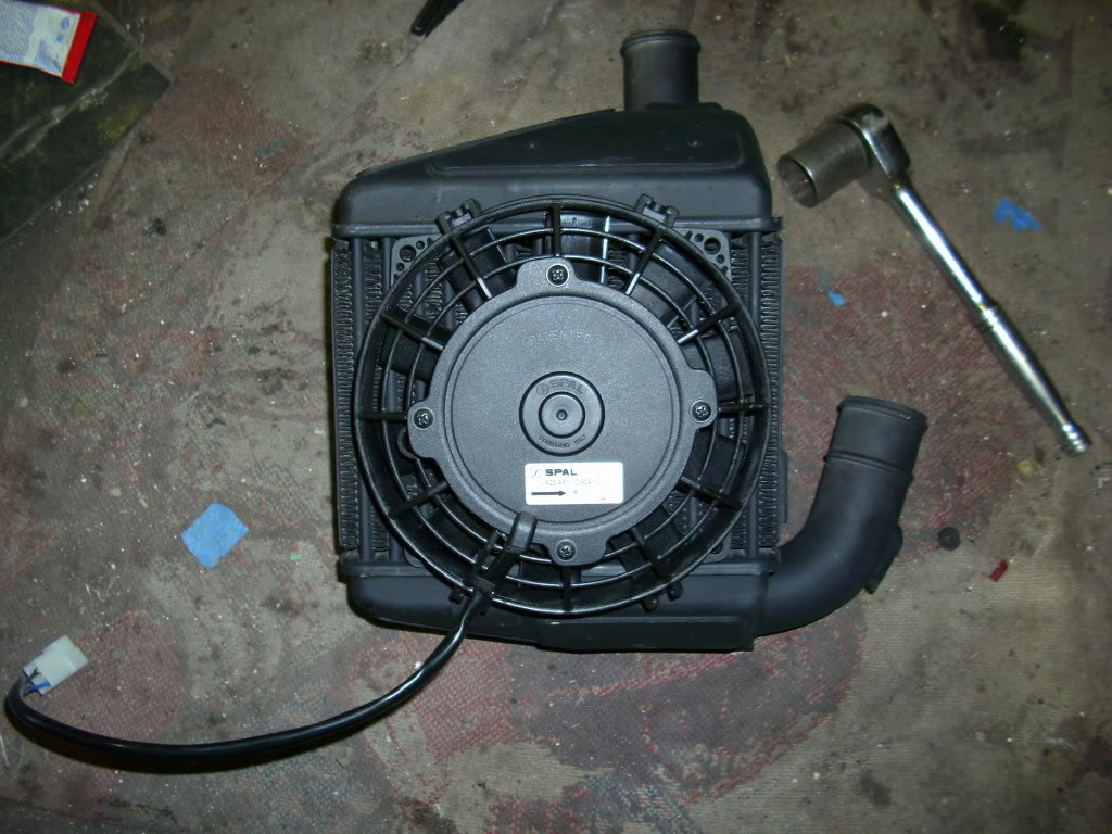

DSM 2nd Gen sidemount IC with a 5" spal atv fan to fight heat soak

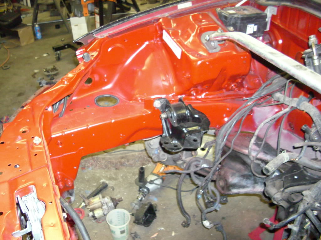

Wire tuck in process

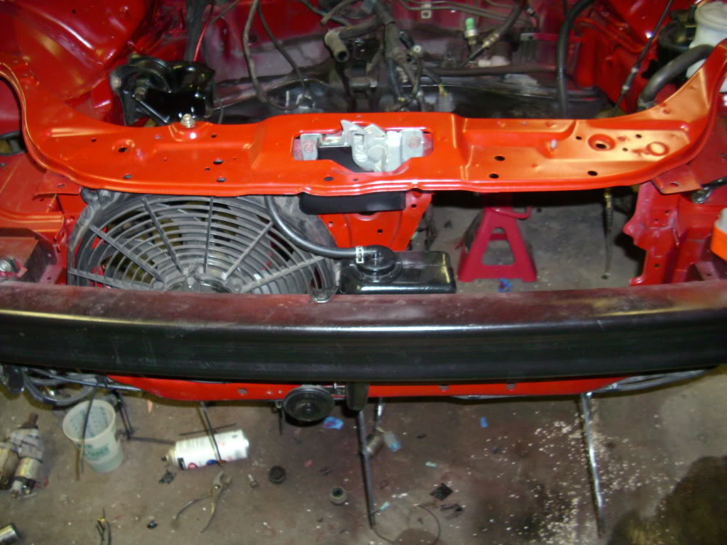

Reversed the fan for stealthy operations:

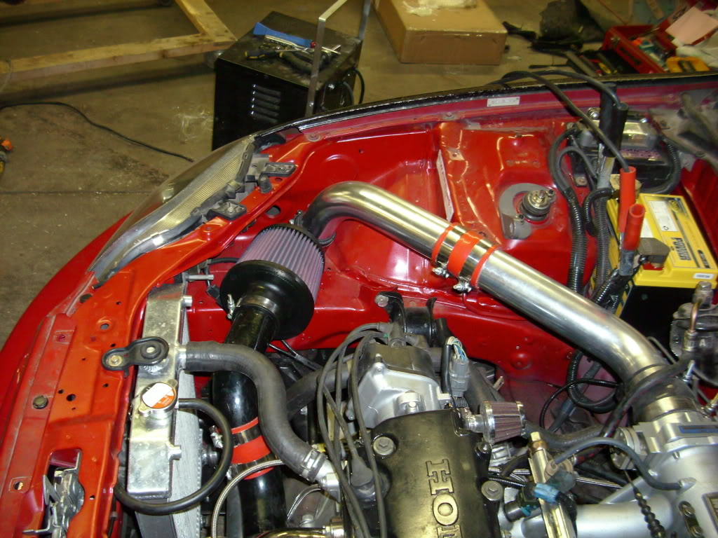

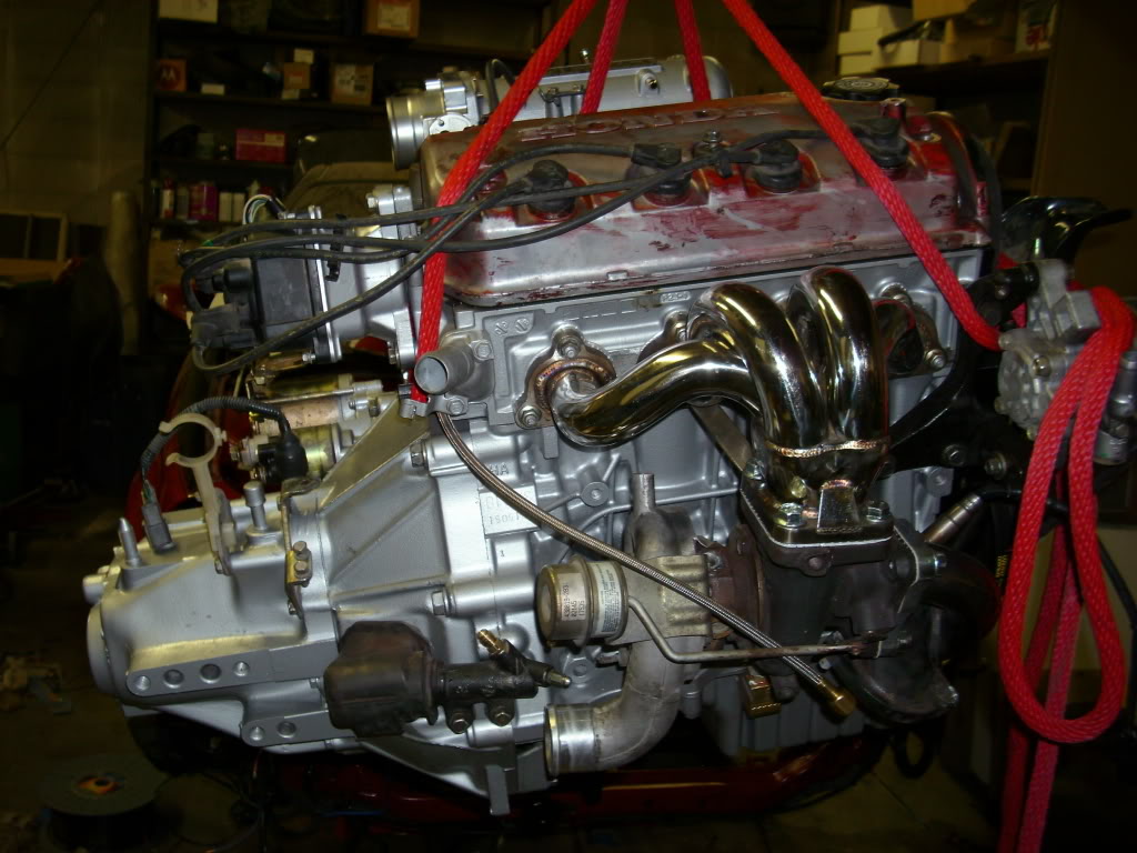

Motor in with the sidemount piping and K&N operations. Relocated coolant bottle(into the bumper as well) with the reversed fan:

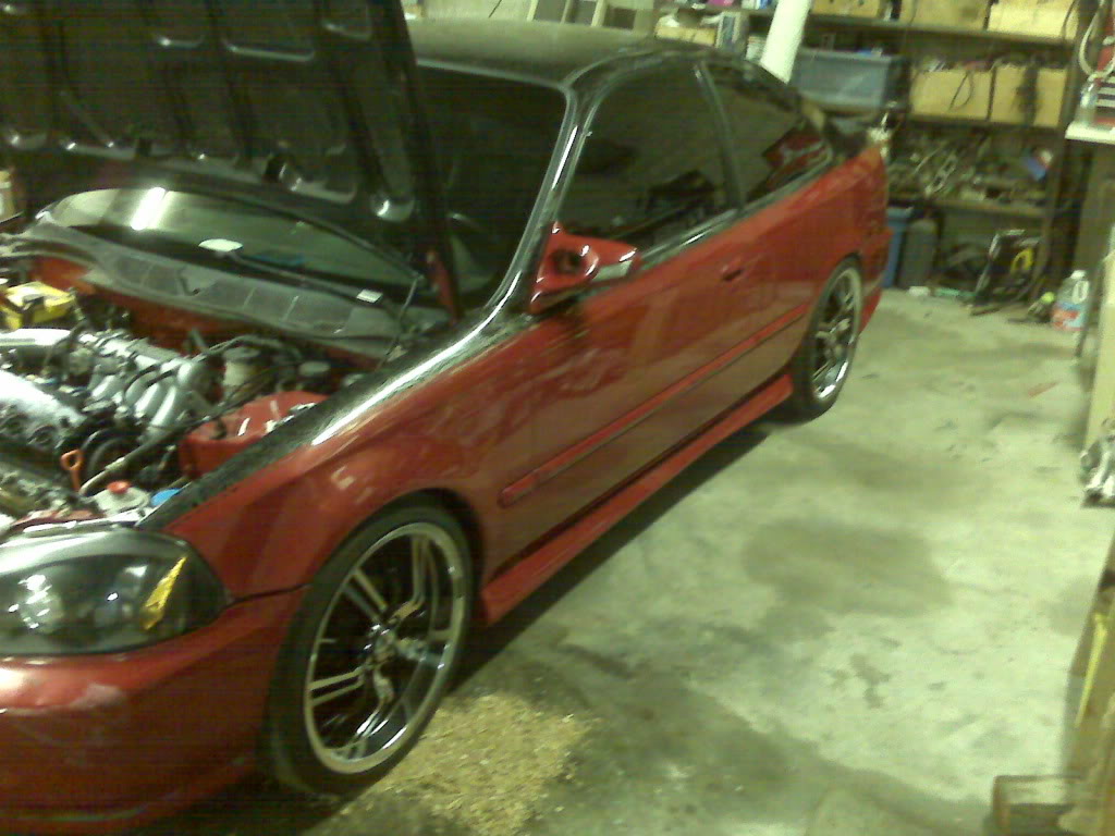

Car all washed:
I was into the vitara build very little the first time... but the oil pick up tube picked up some shavings I didn't not notice in the pan and I spun a rod bearing while tuning it on 11lbs and 200 miles on the motor. So I'm on the second build with vitara's and eagle rod's again. Other mod's were the mini me head swap, dsm 450's, crome, aem wideband, skunt 2 im, skunk 2 70mm tb, ebay dsm manifold, dsm t25, y pipe, greddy evo II cat back, skunk 2 knob and short throw, si tranny, and that's all I'm coming up with now.
I'll keep the updates on the current vitara build that's in it. If I were keeping the car I would have done the z6 block with y8 head though for those who are thinking of putting one together.
