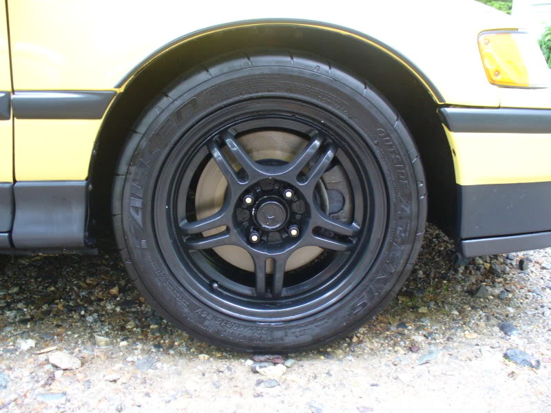

Nice work cleaning them up. The beauty of these center caps is you can make them work with a lot of aftermarket wheels. Although mine are chipped up a little now because of out gravel roads, here's mine...
I'm thinking about painting the H yellow but I dunno.
