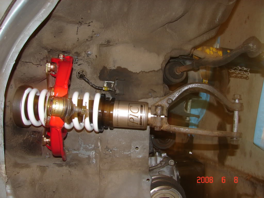

...and the car sits this low:

^^^This last pic....the strut is not seated all the way in the fork. You could gain a 1/4" of travel if it was seated all the way. Unless Im not seeing something of corse...
Also the lower section is turned 180 degrees backwards. The bolt should be inside and the hoop should be in the front.
But there's no spindle so I'm sure the install isn't done yet.
