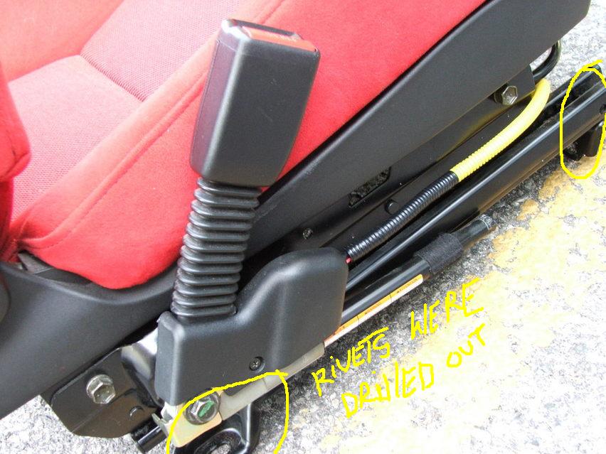

    When i did the integra seats in my old EE, I had to use the outer rails, I think i used the integra inners, and i swapped out these brackets on the inner rails by drilling out the big rivets.
    Play around with it a bit and you'll se what im talking about. start with the passenger side so you dont disable your car in case you need to move it. If the seatbelt chime bothers you just jump the terminals on the plug with some wire and it will stop.
    this was my first EE.
