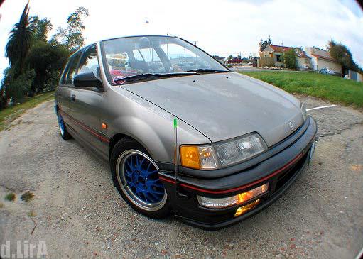

Was it difficult to mount? Any major monifications?
Ive got one sitting in my garage too. Im assuming its a relativly easy swap, Im just wanting to get the motor setup first. Umm ya, looks kick-ass though, but then again, Ive always liked your car;)

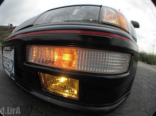

I love it!!!!!!!! Fogs Too!!!! You're killin it!!!!!!!! Good Job!!!!!!!!!!Can't wait to get mine. Any problems mounting it that you want to share? Tips?
best tip... make shure the bumper comes with the ef9 bumper support! NOT THE RADIATOR/T-BAR! the bumper support will be your best friend on this swap! all you really need to do is bend the tabs that bolt onto the frame a little bit inwards, and the bumper will bolt right on!

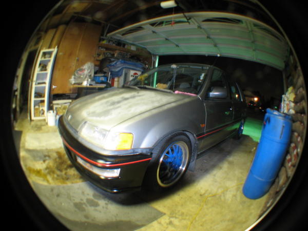

THIS IS HOW IT LOOKED WHEN I PICKED IT UP! THIS PIK IS OF THE BUMPER JUST HANGING ONTO MY RADIATOR
AND AFTER...
