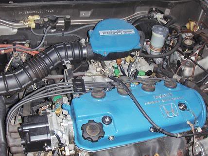

well i got the valve cover wrinkle painted but i wanted to make specific parts on the cover to have the aluminum show. such as the H, round holes, or even the small openings. the place who did the paint painted everything and left me the duty of making it special, by highlighting the areas i want.
so, what tools will i need and whats the procedure?
i am worring that when i bring out the letters i may make the paint crack as i am working on it. any advice on that will help as well.

took about 5 minutes and worked fine.
do you have a pic of your tools setup?
you can buy the attatchment at walmart man, and the sanding pads are round and are sticky on one side.
you'll know what to get when you see it, it's common sense.
the attatchment is around 4$ and the sanding pads are around 3$, if you have a drill which im sure you do then you're good to go.
my letters ended up looking like below, i sorta rushed, it could look better if you have paitence, which i dont.

*when you said drill i was also thinking of using a dremel. some have called it a drill to. and since its sanding or fine polishing i have not seen anyone use an actual drill. so this is interesting to see.*
id still just stick with regular hand held sand paper as it would be easier to control and keep even.

what i did do was clear out the four holes for the spark plug wires.
i may or may not do the letters. the red letters are starting to grow on me.
man i am tired. i did the sanding mostly by hand and i didnt tape off any sections. so i had to take it really slow and steady. :shock:
it looks good to me so far so i may not do anymore then this.
the only other thing i would probably do is the round outter part of the spark plug lips.
it might look better if i sand those. just not sure if the plug wire coupling would mess those up at all anyways.

sand the paint off the letters and let them shine
ok since you all recommend to sand the letters and words, this would be the max.

so here it is. the final product. what you all think :?:
what grit did you sand the letters with?
well i started with 160 grit then used a 360 then a 400 grit to refine it down.
400 was the lowest i could find at "Home of De Pot" ...
almost messed it up a few times cause the ole hand was getting tired. there was slippage but the tape i used to cover the areas around the sanding spots covered me a few times. there were taped spots that i didnt notice was wearing out cause of the protection it was doing. i almost went down on some spots. lucky i did it slow enough to catch it.
