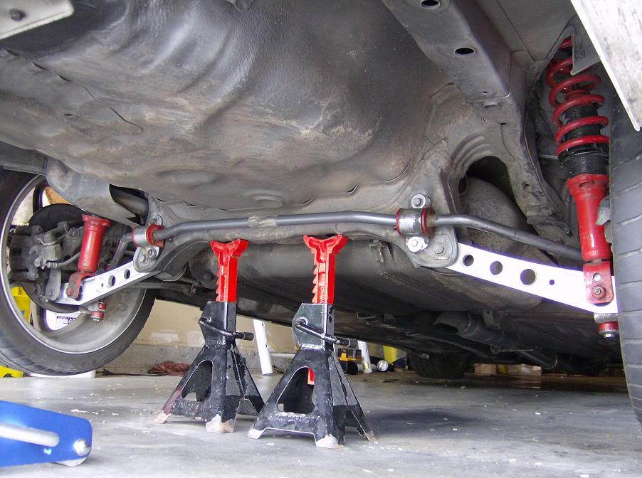

So I install my Progress coilovers, rear 22mm swaybar, Suspension Techniques Proarms, Dropforks, and front 19mm swaybar. Heres a pic of the rear setup.
Its hard to see, but I drilled some different mounting holes at the bottom of the rear struts to bring hte back down a little since the DA rear stuff is generally on teh tall side. Well it worked great. Dropped the back almost 2" and gained me a ton of camber, which is what I was really after. What was also cool is I was able to raise the rear coilover up afterwards and gained some ride quality back. Turned into a win win. New pic with the rear dump installed.

SPC and a few others make them in aluminum but they have no camber adjustments like the ST ones did. You can tell by looking at them that the drop from the ST setup is far more than aluminum equivilant. Heres a pic of a friends car with a similar setup. Look at how far up the bolt is that attaches the spindal on my car versus this one. You can also see where he drilled his shocks out for a little bit more drop too. His are made by Megan Racing.
