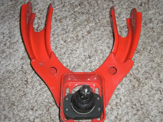

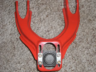

Compact design adds minimal height to suspension and provides clearnce as to not smash the shock towers:
As you can see they completely revised the upper balljoint area, and the adjustment bolts and mount for the upper balljoint is a much sturdier design that the first-gen EG/DC/EK kits.

As long as the allen heads are properly tightened with an 8mm allen socket or longer allen wrench there should be no reason these will slip or fail in any way since the design is much beefier than the first-gen kits on the EG/DC/EK.

I don't like the way B/J is held by 4 machine screws...Questionable IMO...
personally i have suspension with four screws on them like this and it holds up very well. this is on my camber plates on another car.
i also have seen some knockoff of this with only 2 screws. four would seem to be a very good upgrade to the two.
i didnt pay much for them so i didnt care but i couldnt believe the guy was trying to pass those off for skunk 2. even got them in a nice skunk 2 box.

Sliding ball joint kits suck for the 88-91 Civic because they smash into the pinch welds where the fender meets the unibody. They are too tall, and add suspension height to an already very cramped fender well area. Skunk2 completely redesigned their already proven 92-00 Civic/94-01 Integra kits to be shorter/more compact to keep them from hitting the undersides of the EF/EE/ED shock towers.
The four allen bolts are a non issue IMO. I've ran Skunk2 camber kits on my other car, a 1992 Civic for SIX+ years with zero issues.

Those are the old style Skunk 2 kits where the balljoint plates are not reinforced. I've ran those same kits on my 1992 Civic that has been auto-x'd numerous times, and they've never given me problems. I did do the balljoint upgrade that Skunk2 offered a few years back, but again mine never failed on me.
