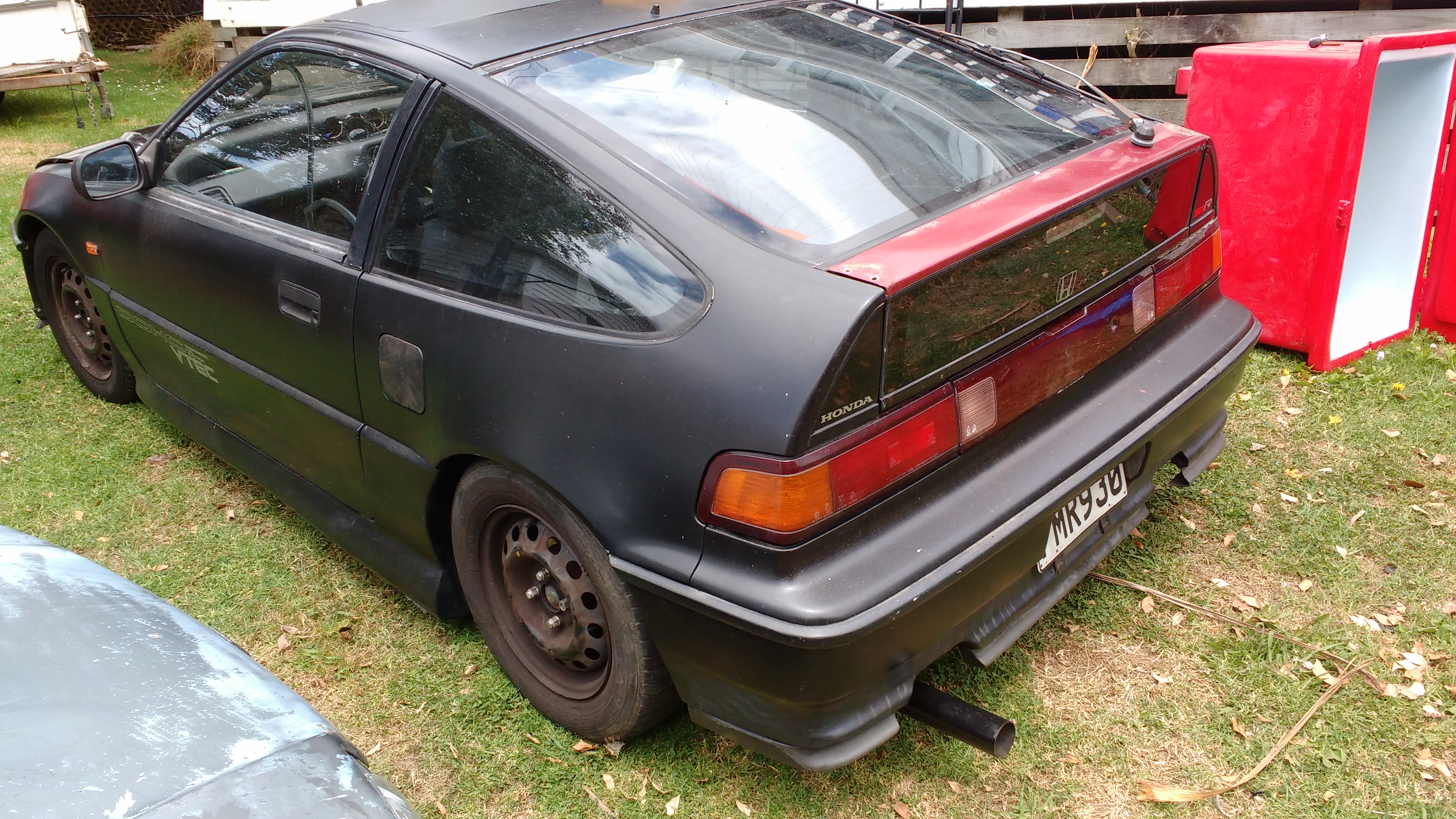

I missed my old crx soo much I had to get another one. I had a look at it about 6 months ago and didnt have the time or money to get it, Texted the guy and he still had it. It has a 97 B18cr with some skunk2 goodies on it. wiring was a mess and i'm slowly sorting it out. I've replaced the fiberglass bonnet/hood with a stock one, also have a set of non tinted taillights. I've taken out the adjustable suspension and put stock stuff back in for now. taken off the 16s and put my mr5s on. Replaced the hood slam panel with a beagle one, I was surprised it fitted!3.jpg

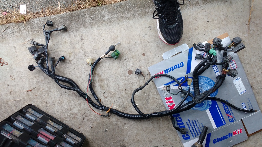

Obd1 loom ready to go in, ITR obd2 loom and battery cable routing
I moved the battery jumpstart post and reinstalled the factory fusebox as somone had chopped everything off. The radiator fan wiring is all sorted now and turns off with the key!

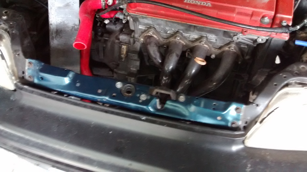

    Here is the bay pretty much as I got it. The fiberglass bonnet was toast and was held in by pins, The whole lot has come off and surprisingly the ef5 beagle bonnet slam panel t bar (whatever you call it) bolted in with minor encouragement so I can use a stock bonnet

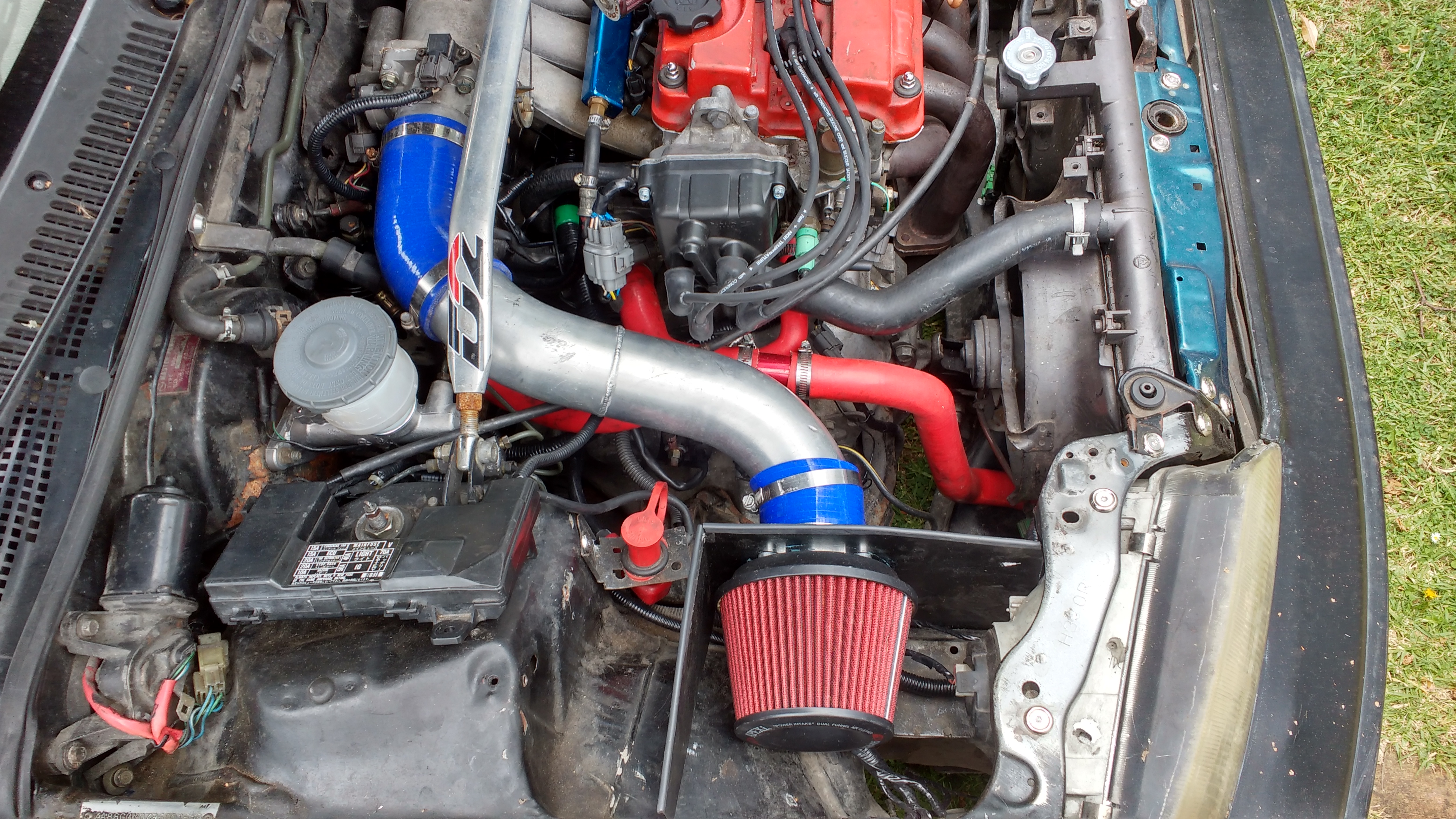

    I got a d series vtec obd1 loom and re used the ef alternator cable so I could reinstate the stock fusebox. Man the parts beagle was a godsend for fixing that mess! I have tidied and re routed the body looms too and made a cold air box of sorts.

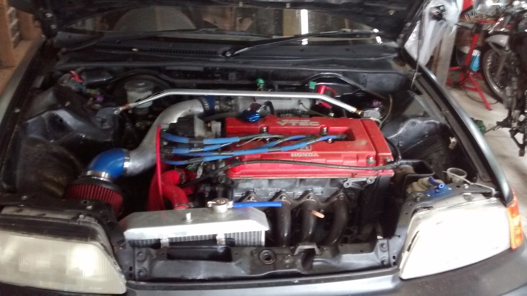

    The bay is a little tidier now. Still more stuff to do but we'll get there eventually

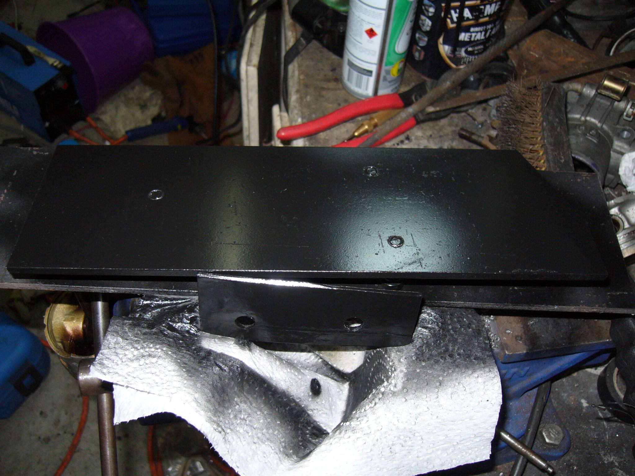

    The battery box was bolted to the spare wheel mount and battery was free to fly around and take your head off. I found some plate steel and it'll on the passengers side just above the jack. The smaller plate goes between the frame rail and the spare wheel well. I'll Drill and tap some holes and nicely (ish) mount the battery box and somehow work out how to get a battery clamp in there

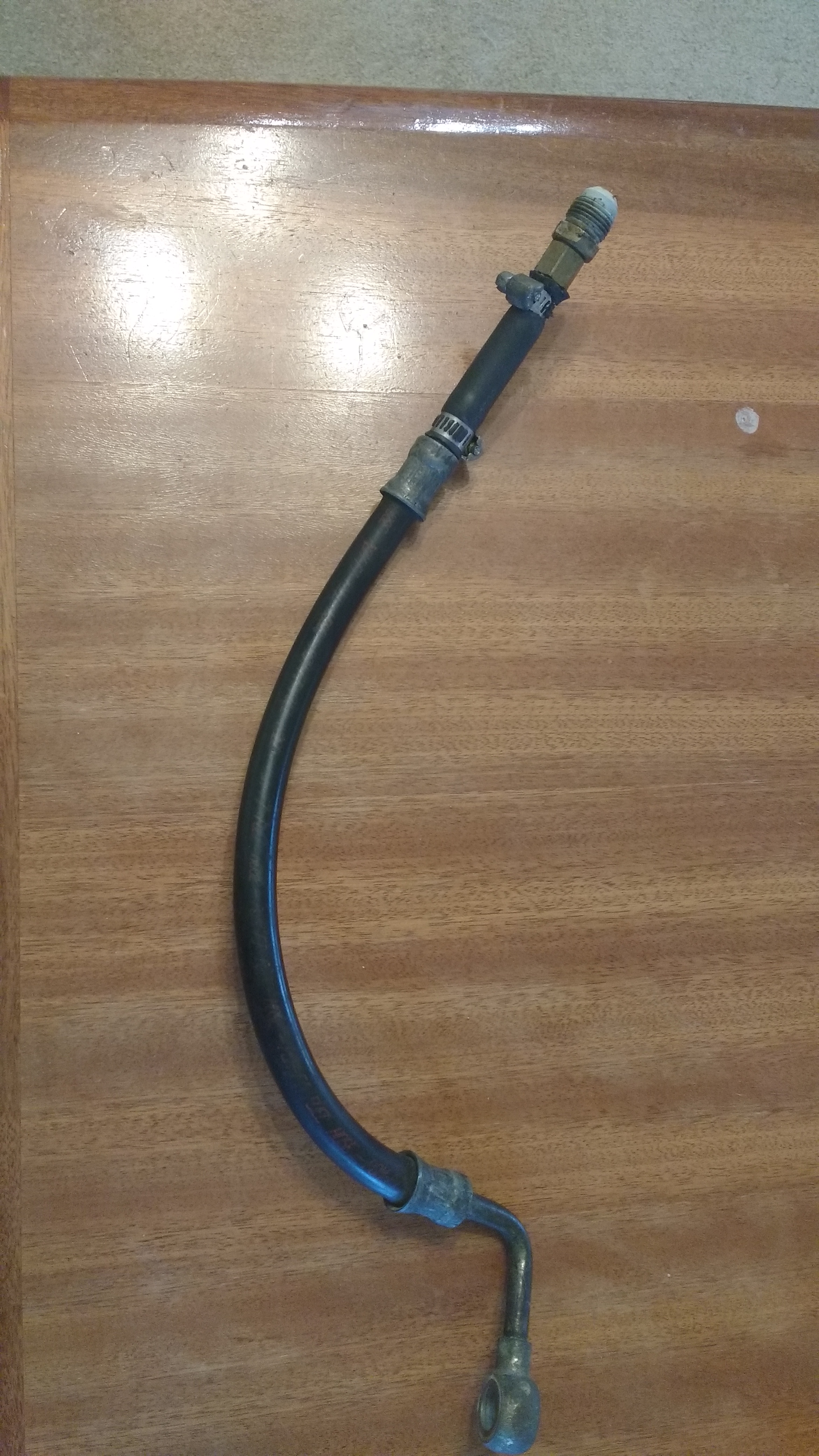

    I took the fuel supply hose off as It was leaking a bit and will get a new one made up

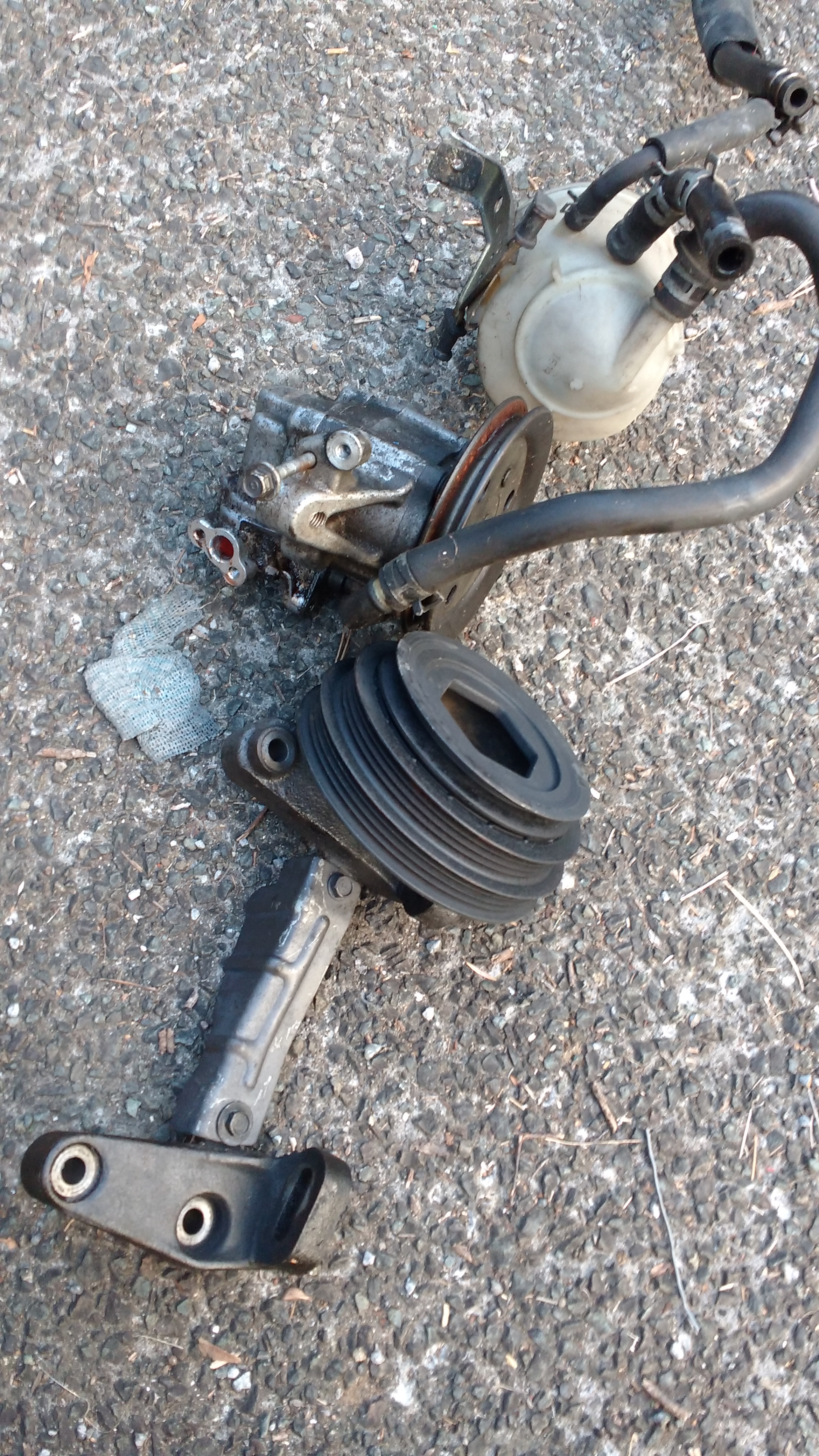

    I was looking for something else in the garage today and picked up a bracket and thought that looks familiar. Turns out it was a power steering pump bracket for a B series ef i've done a quick test fir and the profile is correct but the lower bracket is too high as the B18 block is slightly taller than the B16.. Luckily the brackets are only held together by a 10mm bolt so I'll whip that off and test fit the pump another day. Picked up a ef/da crank pulley so thats everything sorted. I'm thinking about doing the cam belt while I have the crank pulley off. Probably will be a good idea

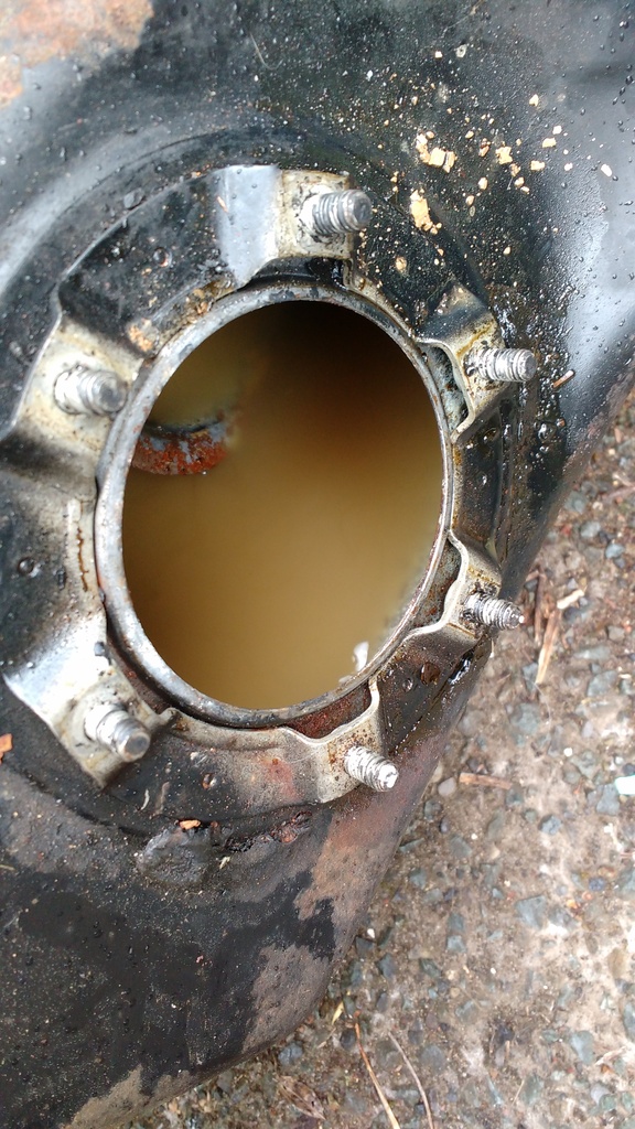

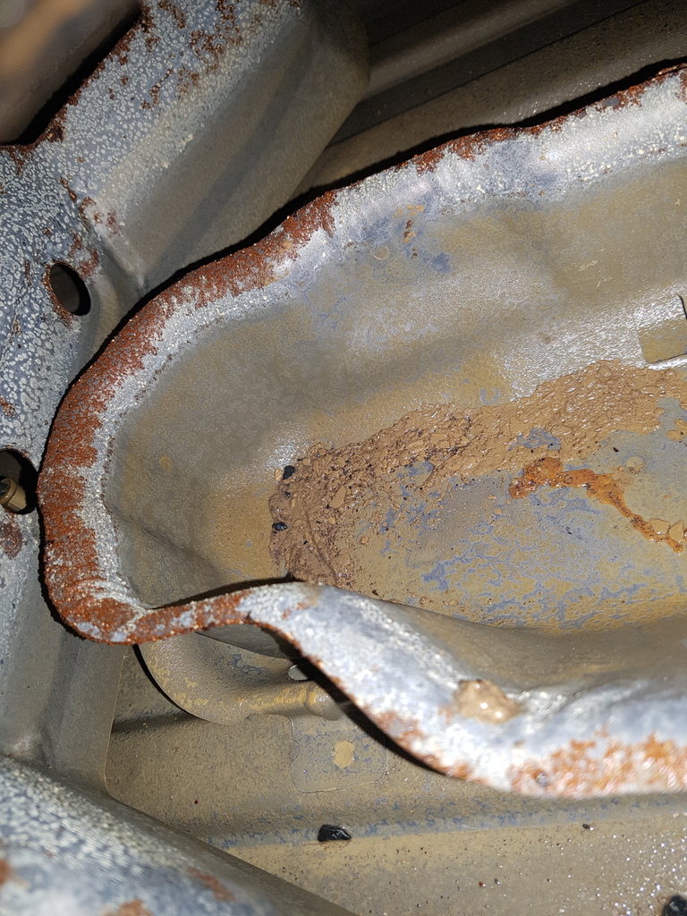

    I dropped the tank again on this and turns out I didn't clean it out enough as there is more sediment and rust flakes that s time around. I'll see if I can fit the beagle tank into this. Failing that I'll source a replacement tank. I called and got a estimate on cleaning/coating the existing tank and it's pretty expensive

    The tank is still fucked in the crx, According to the Internets the shuttle tanks can fit the crx/hatches. It doesn't. The filler is on the wrong place, the pump is on the opposite side and last of all it doesn't even fit and hangs too low so at the first bump it'll rip open. Rock auto has a new tank reasonably priced so I'll get a estimate for shipping it home.

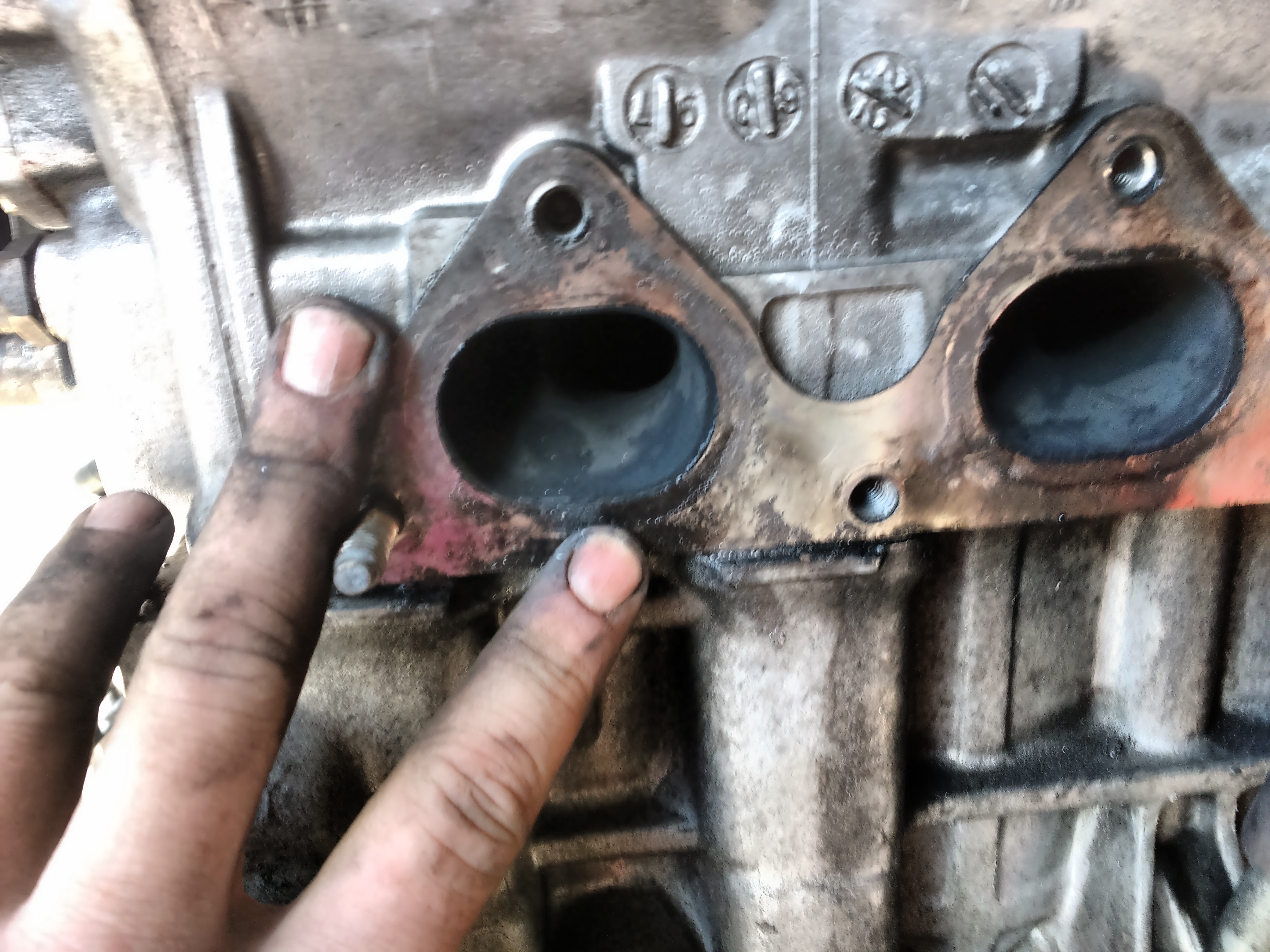

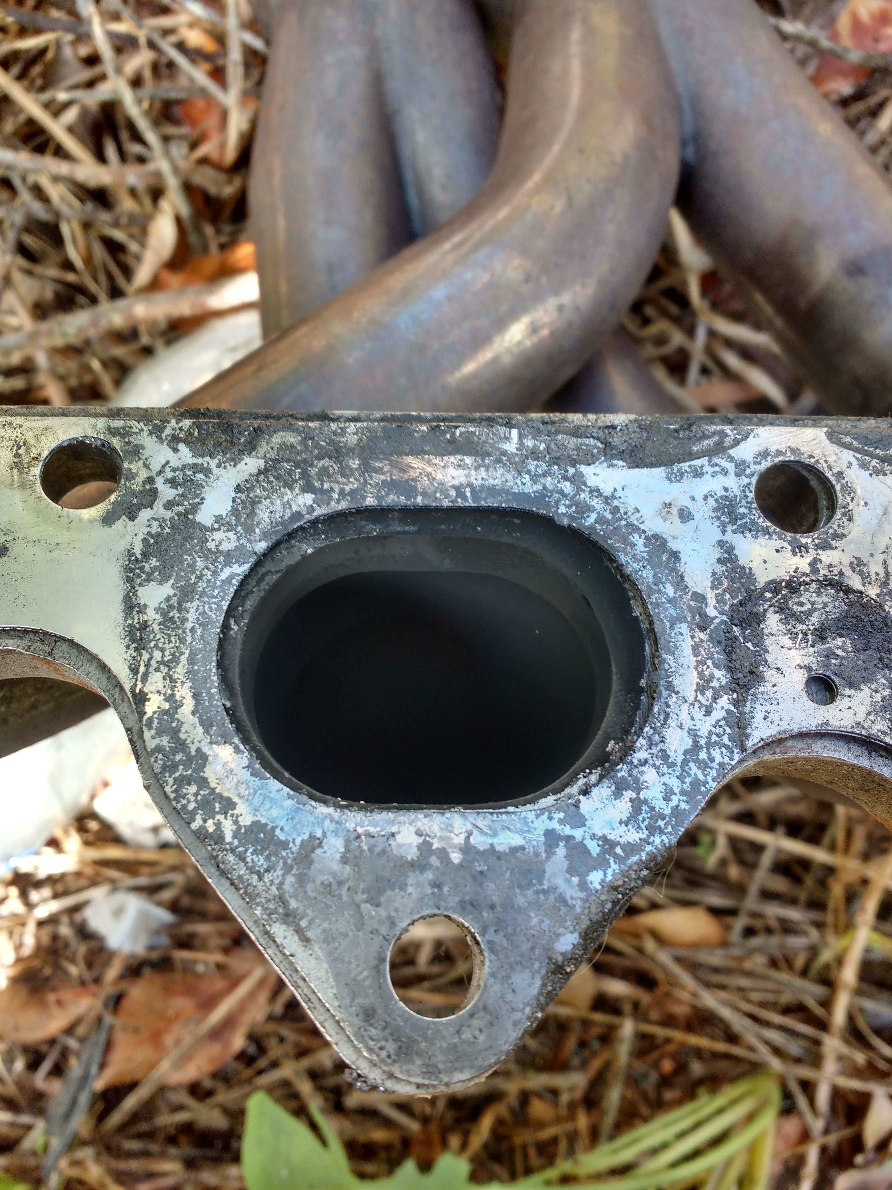

    I was tidying up and had a look at the headers and noticed lots of carbon around the flange... I had a quick check with the gasket on the head and back on the headers and they are way off. There is a huge lip inside them where the pipe meets the flange. I'll attack it with the die grinder and see how much better I can get it. the collector pipe is also only 2" so I'll chop that off and put a bit of 2.5 on it

    The tank is still getting cleaned with electrolysis, I'm cleaning the anode electrode a few times a day so it's still tidying the tank internally. I have a por 15 tank sealing kit to put through but I want to get as much rust gone as can before I put that through
