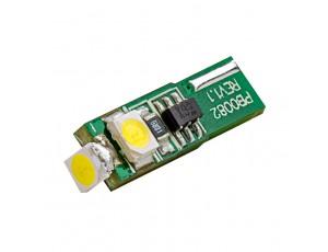

The five circled in the image below are size 74 bulbs. So use whatever 74 LED equivalent you see fit. I am going for red for best night vision on them. All of the rest if the bulbs are for the indicator lights which are all behind colored panels anyway and I'm not changing the paneling so those can stay.
This one happened to be burnt out on me as well so all the more reason to replace. Notice the bulb has a blue sleeve over it. This is because the gauges also have two smaller front lights that shine through a red panel on the under side of the top of the gauge housing. So they balance each other out a bit. No idea why this is done, I'm sure someone else knows though.
One thing to note the LEDs themselves are polarized, which means they only work when installed one way. So check your lights before screwing the gauge cluster back down as you're liable to have some that don't light up. I was only 2 for 5 the first time =(

The red bulbs installed are https://www.superbrightleds.com/moreinfo/boat-miniature-wedge-bulbs/74-led-bulb-3-smd-led-wide-angle-wedge-base/228/1071/
Killa's will be the same bulb but in Cool White.

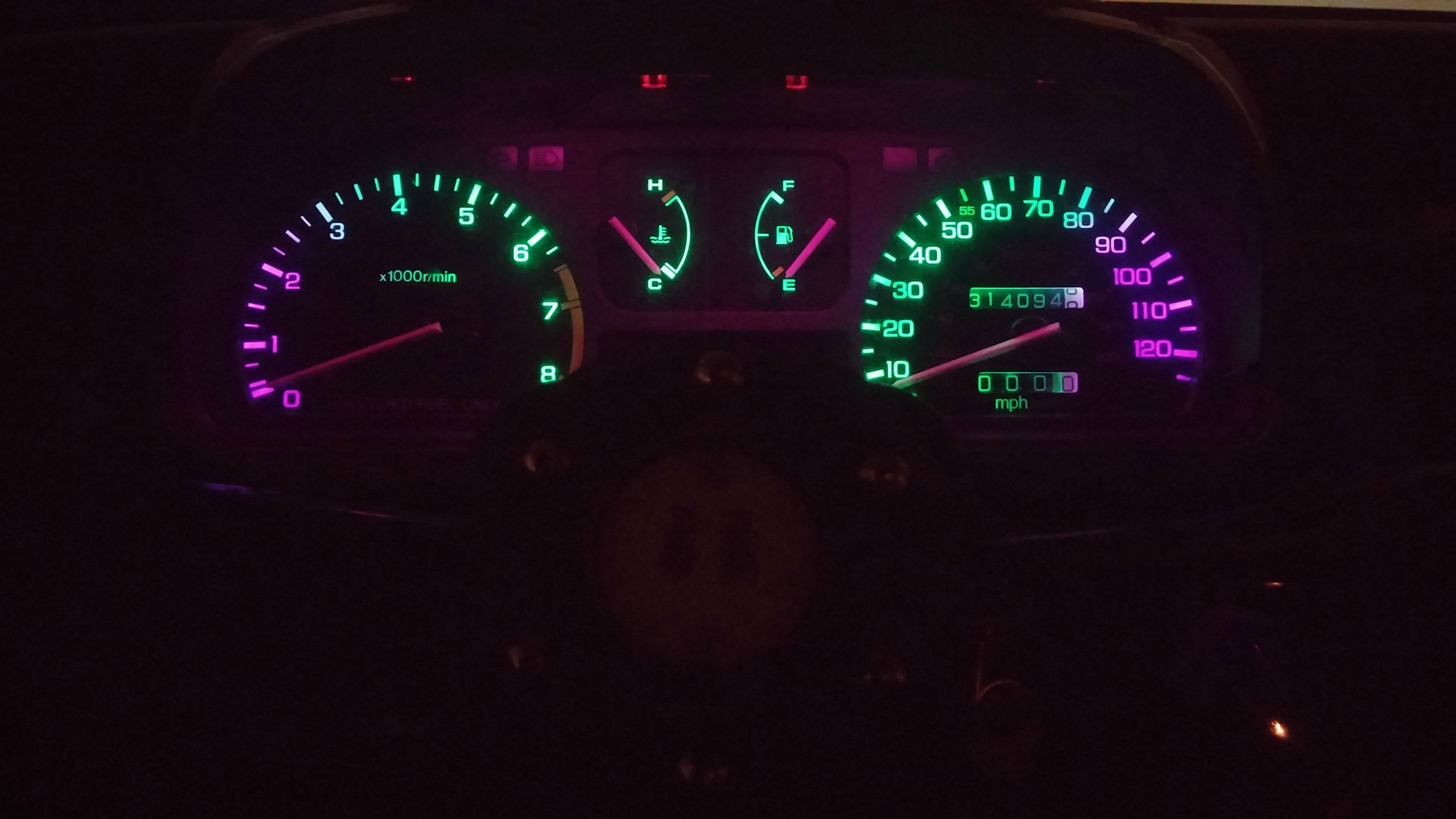

http://www.ebay.com/itm/10x-T5-1LED-74-17-Dash-Board-Wedge-GREEN-18-37-70-Car-Gauge-Cluster-Light-Bulbs-/121496907633?pt=Motors_Car_Truck_Parts_Accessories&hash=item1c49c7af71&vxp=mtr
This one does have more LEDs on the array itself so that's going to account for some of the brightness, but the way these distribute light it's good having some light come out the sides too to carry it along the little plastic channels that they're using to light things up.
That said, at $4 for a pack if they suck it's not like you're gonna be out anything cept for a bit of time, and you can easily power the cluster up to see how it looks without having to fully reassemble everything.

I'm very confused, or that's the strangest looking LED install on a gauge cluster I've seen yet.
It's just the pic, if you check that youtube clip I posted it's me fiddling with the dimmer switch. I had them dimmed all the way down when I took that first pic. With regard to that question though, they are illuminated by the top down lights which are these wee little bulbs. Those could be upgraded to LEDs as well.
I didn't because it looks how I want it to right now, but if you swapped those two out for some brighter LEDs you'd definitely get more light on the needles, though it might cast unwanted glare on the gauges. Like little spot lights due to it being a bit more directional.
