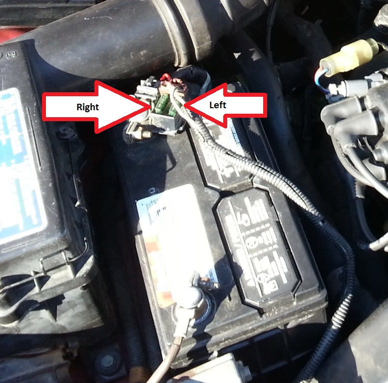

When I removed the right side (passenger) the draw went away.
So I replaced the auto seat belt control box from a 90 sedan and the problem no longer exist.
The auto seat belt control box is also linked to the Hazard fuse that is under the hood.

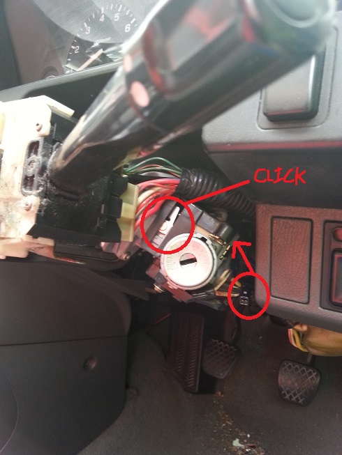

My draw is from the smallest black plug on the ignition barrel, it would engage every time i put the hazard/horn fuse in and drain my battery over 2-3 days.
I'm guessing it's the block that doesn't let you remove the key until it's back in park?
Even after just disconnecting this i no longer have a parasitic draw and the key still works fine.
