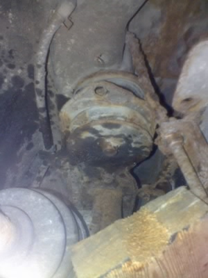

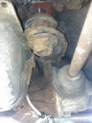

Passenger's side:
Driver's side:

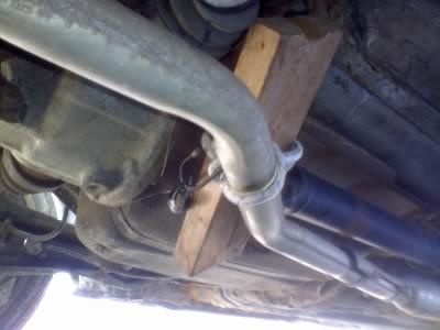

Ghetto fix to get the car home:

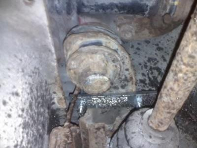

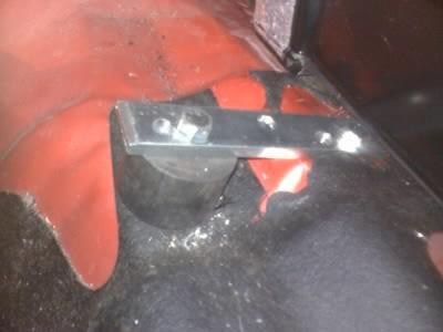

Here are the bolts and backing plate protruding from the trunk area:
Here's a shot underneath where the bolts and another metal plate are holding the mount to the body.
Now, I turned off the 4WD as I was a bit scared as to how the repair would handle any torque from 4WD. It seems pretty solid after dring 92 miles to work this morning. Do you think tuning the 4WD back on will have a negative effect on the repair? Thanks for looking!
i guess the only way to know if the 4WD can handle it is to take it for a test drive.... be easy at first
If you're referring to the metal that rusted out there was still a lot left. I'm not worried about the metal flexing. The hole was about as large as the hole when you touch your pointer finger and thumb together, maybe a fraction larger.
